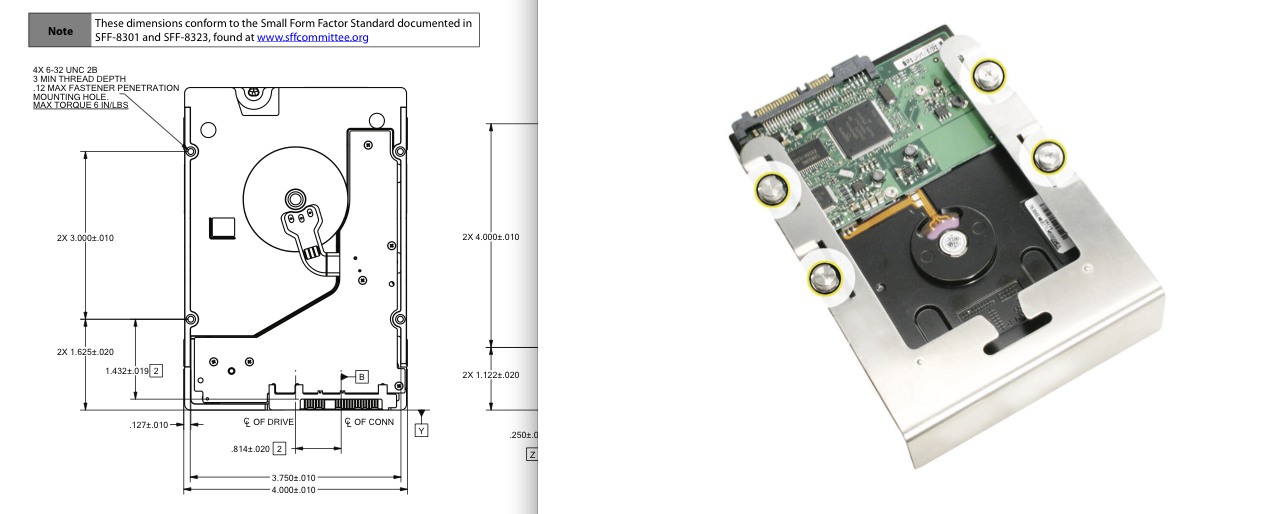

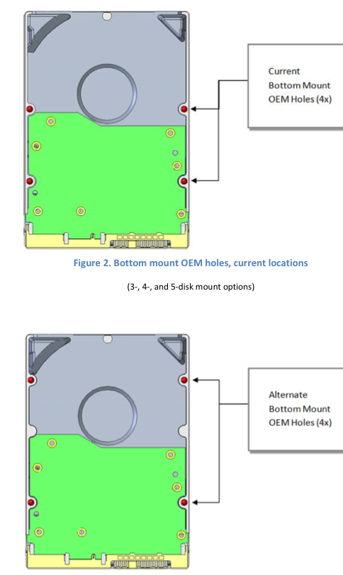

I'd like to install 10TB drives by WD or Seagate in my MacPro3,1 2008 but Im wondering if all 10TB drives have gotten rid of the middle screw holes underneath?
For some reason OWC sleds are only for MacPros of 2009 onwards
Does anyone know if the sleds will work between the 2008 and 2009 models - whats the difference?
I cant find anyone making drive sleds with holes for the 10TB screw configuration that will fit the 2008 mac pro?
Any tips would be very appreciated?

The SATA connectors are further in on 2009 and later Mac Pros so the drive sleds are longer. If you use 2009 sled in a 2008 then part of the drive sled sticks out and you can’t close the cover. If you weren’t going to close the cover and don’t mind your drives not being latched in then it should work. Can tell you for sure in 3 days when I’m back home

When looking at big disks, worry not only about the mounting holes (some big disks have older style mounting holes, some don't mate with Apple sleds) but about the recording method.

I know I am a little late to the thread... I have a Mac Pro 3,1 and cannot buy the new HDD sleds with the updated mounting points from OWC because they are too long for 1,1; 2,1; and 3,1 Mac Pros. It was mentioned a couple of times that there are 6TB and 8TB that fit into the older hard drive hole spacing standard. Can someone point me in that direction? I have been looking on eBay without much luck. Thanks!
[doublepost=1516096575][/doublepost]And... I answered my own question... They do exist. A bit tricky to find. It seems like once hard drives went from 64MB to 128MB of cache, the middle bottom mount hole was removed. The funny part is that OWC's website says that support ends at 5TB. Luckily all I need is a 2x6TB setup in RAID1.
This is the bracket for MacPro 2012 with the new hole pattern on the larger drives:
OWC Hard Drive Bracket Mfr P/N: MPRODBKTLG6
https://eshop.macsales.com/item/OWC/MPRODBKTLG6/

i have wd gold 8tb and the screw holes for the mac pro sled dont line up i cant use them in the internal bays.
You mean the drive didn’t show up? Or simply because you can’t mount it proper, therefore, you can’t use it in the cMP?
