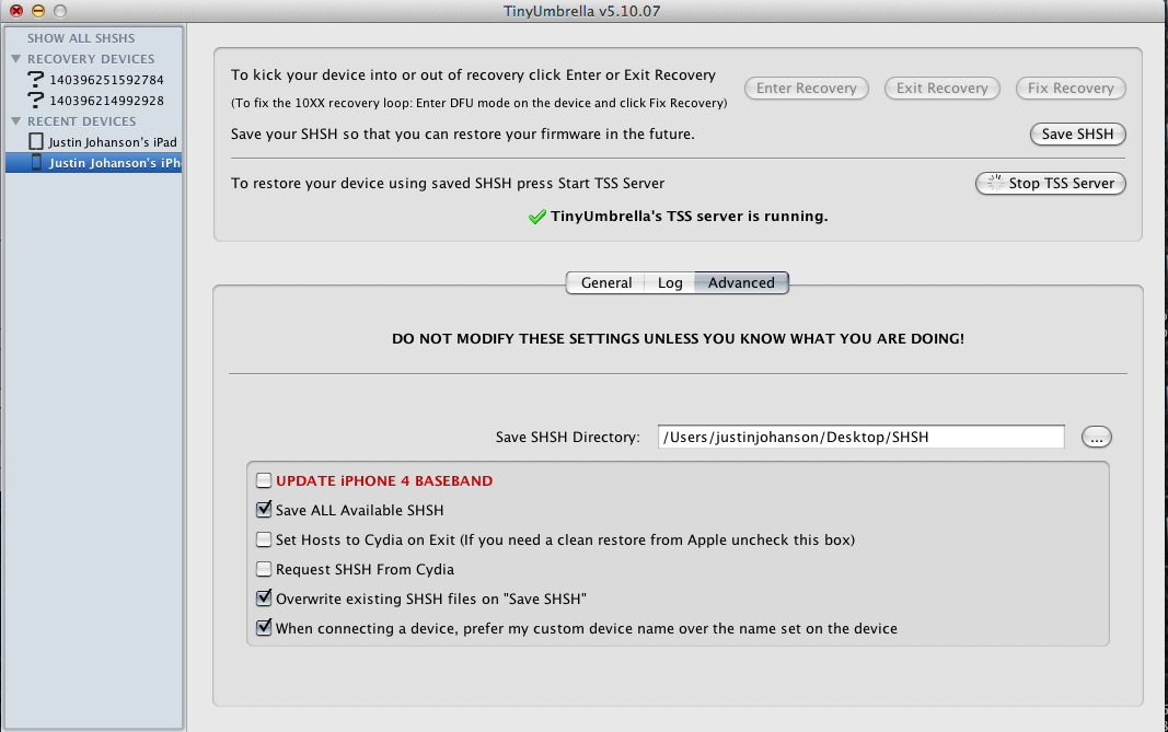

This is how I have my TU set
attachment.php

Check your hosts file for references to gs.apple.com and remove them (Google how) then restart your computer. Do not run TinyUmbrealla before or during the restore process.
