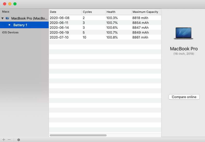

Sending Data to compare. I only have 10 cycles and batter is made by DSY, but yeah I would probably be the same level of concerned as you.
I try to keep mine MOSTLY plugged in, and owned it for about a month+, but it looks like it just came with a high battery?
