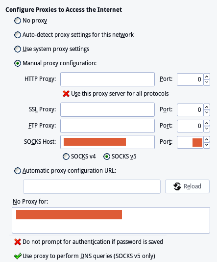

> I always use the VPN's SOCKS proxy
I don't understand what you mean by this, since a vpn is different from a socks proxy. Some vpn providers may also offer proxies, but we need to be very precise about the exact the network setup you're using.
OK, in all the applications that allow for it (browsers, Fetch, VirtualBox and others) I use, have always used, the SOCKS5 proxy offered by my VPN services. But — as far as I know — such an option does not exist in iTunes 10 nor in Entourage (the Microsoft mail application). I can enter it in the Network CP/Advanced/Proxies/SOCKS Proxy setting, but it doesn't seem to make a difference. I hope this clears the misunderstanding.
Then you're not using a vpn though, you're using a proxy, and none of the discussion regarding osx ignored proxy settings for a vpn interface matters, meaning the issue is likely not at the os-level in your case (i.e. it's some application specific quirk).
Sorry, I don't quite understand your comment. To the only part I do follow I can only reply that in the Network/Configure how [browser] connects to the Internet preferences of most browsers I know of (and of many applications like those I've listed earlier, as well as in the System Preferences' Network CP), you have something similar to this:

where SOCKS Host and Port are data specific to and provided by the VPN services. This is what I've always used, and I've never noticed any interference with what Squid is intended to achieve.
Anyway, as I've posted yesterday, this isn't related (but I may easily be wrong) to the issue being discussed. I've been wondering if something could be done by modifying the software's settings shown in this post, 2nd and 3rd screenshot. But what?
[Just found out now that there was something wrong about the links at the end of the previous post - corrected]
