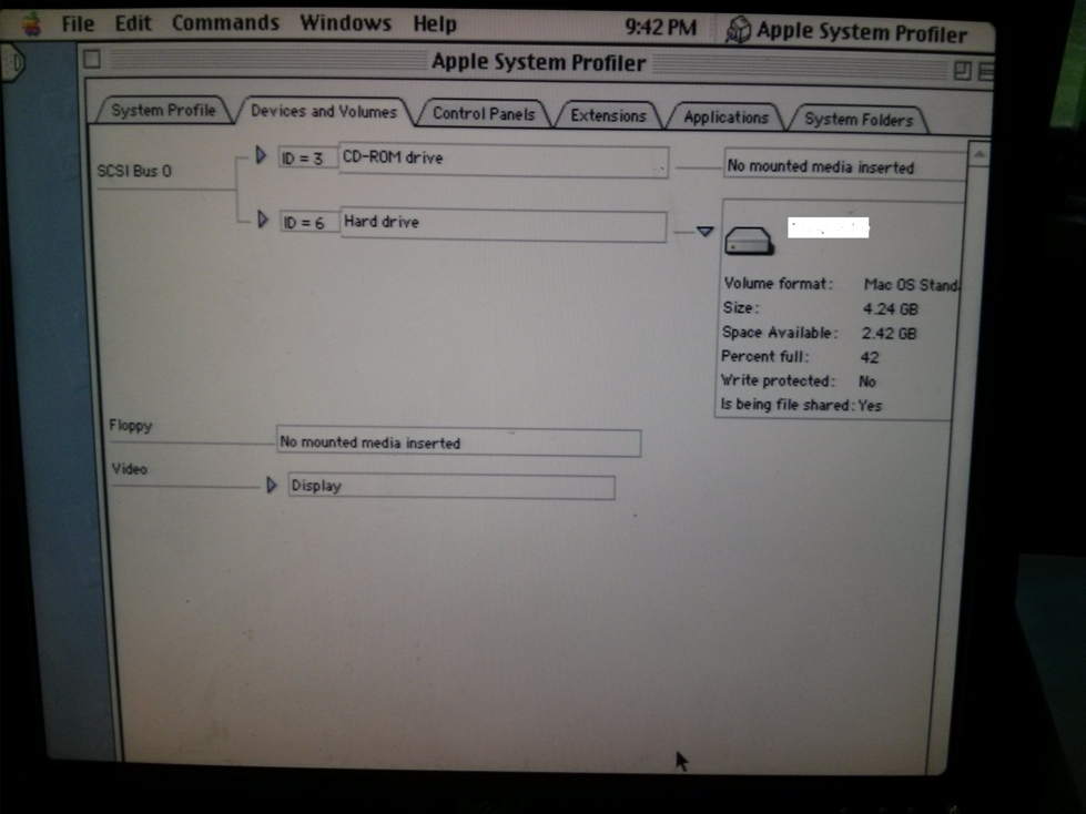

From experience with other computers in this series(8600, 9600, and 8500) I'd guess the drive to be somewhere in the 2gb to 4gb range and probably on the lower end of that. 50 pin SCSI drives larger than 4gb start to get really difficult to find and expensive.
The x600 series computers were the last Powermacs to use SCSI as their primary bus. The G3 series-that came after them-shipped almost exclusively with IDE HDDs although they did have a SCSI bus built in. I have two G3s that boot and operate off of high speed SCSI, but both of them(one a server, the other an owner upgrade) run their drives off the official Apple "Jackhammer" 68 pin. The server has a pair of 10K drives, which are obnoxiously loud, while the G4 upgraded one has a 15K that's that's surprisingly tolerable-enough so that I leave it running most of the time.
Was able to pull the drive out of the sled without breaking any more brittle plastic (small victory in itself) in order to investigate a little more.
It's a Quantum Viking and I saw "VK45S012 Rev 04" on the bottom of it, which, after some Googling, appears to be a 4.5 GB drive. I'll confirm it when I have a display! If it works well and tests fine I may sell it once I get it replaced with a larger IDE drive (and card). Or maybe I'll keep it around for the heck of it. It's easy to become a packrat and a hoarder with these old parts. 🙂

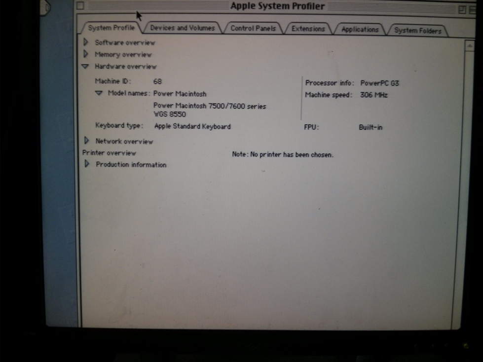

Got a DB15-VGA adaptor for cheap so I can play some more. Also have a somewhat wonky ADB mouse. Need to find my keyboard if I still have it, or find one cheap. But even without a keyboard I can turn it on and check it out. The Mac booted and I waited for a surprise to see which OS was loaded:
When it was done booting I was able to confirm more system specifics, such as the CPU:
And finally, to confirm my suspicions about the HDD, a SCSI drive that's 4.24 GB formatted:
