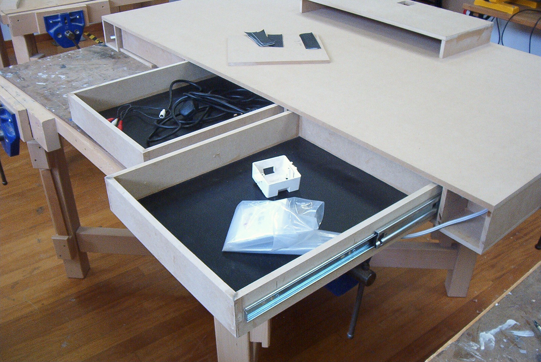

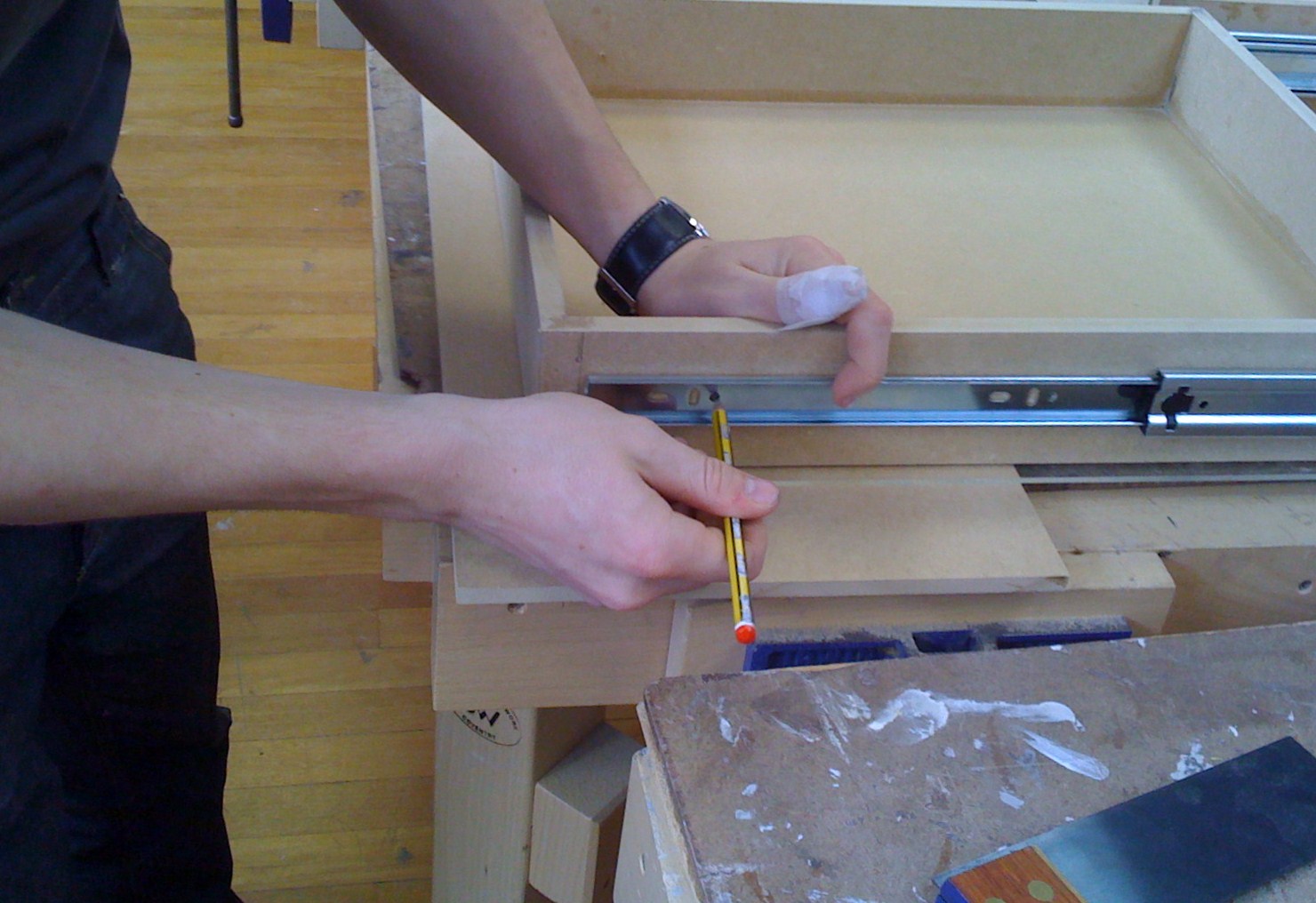

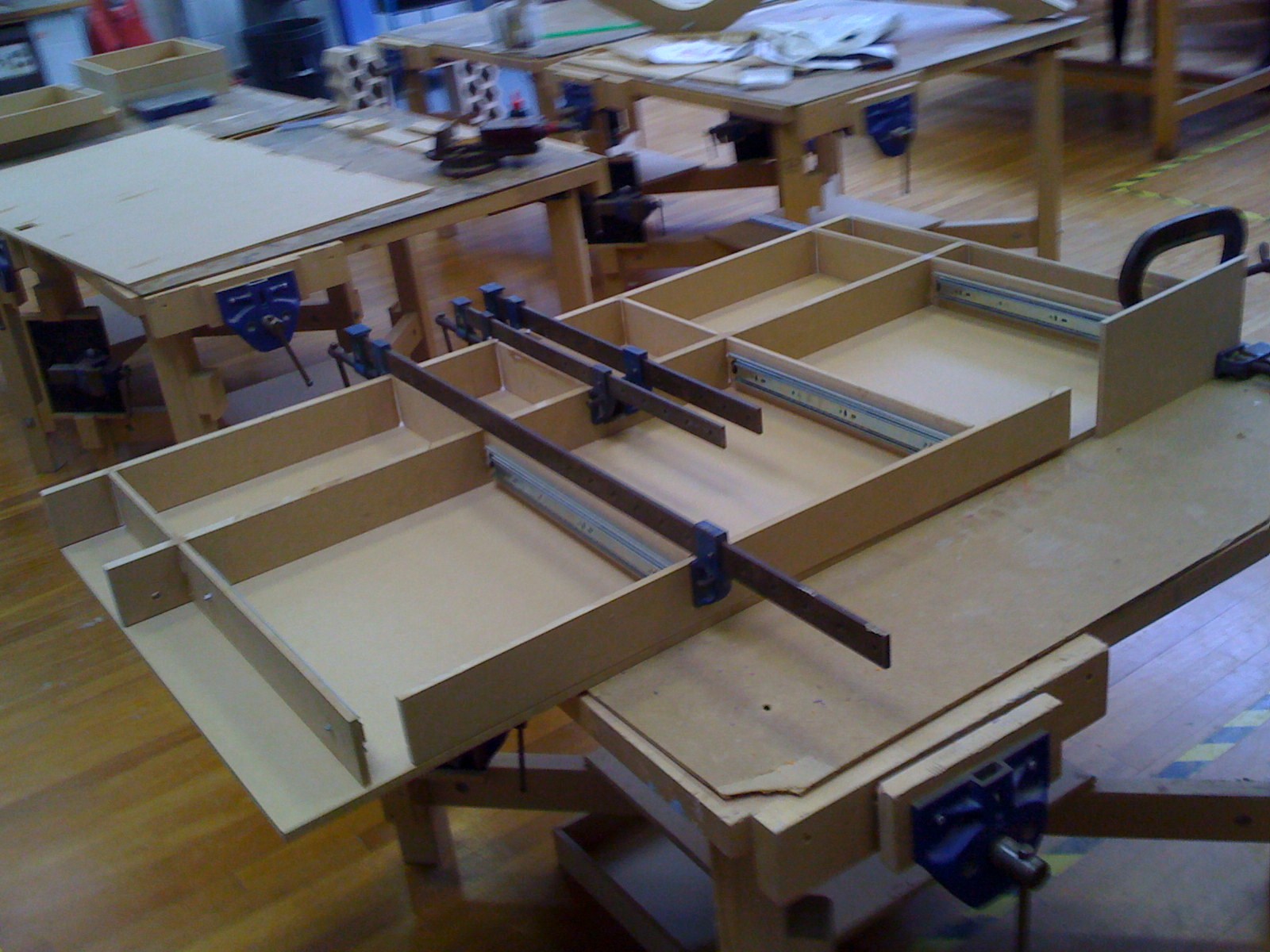

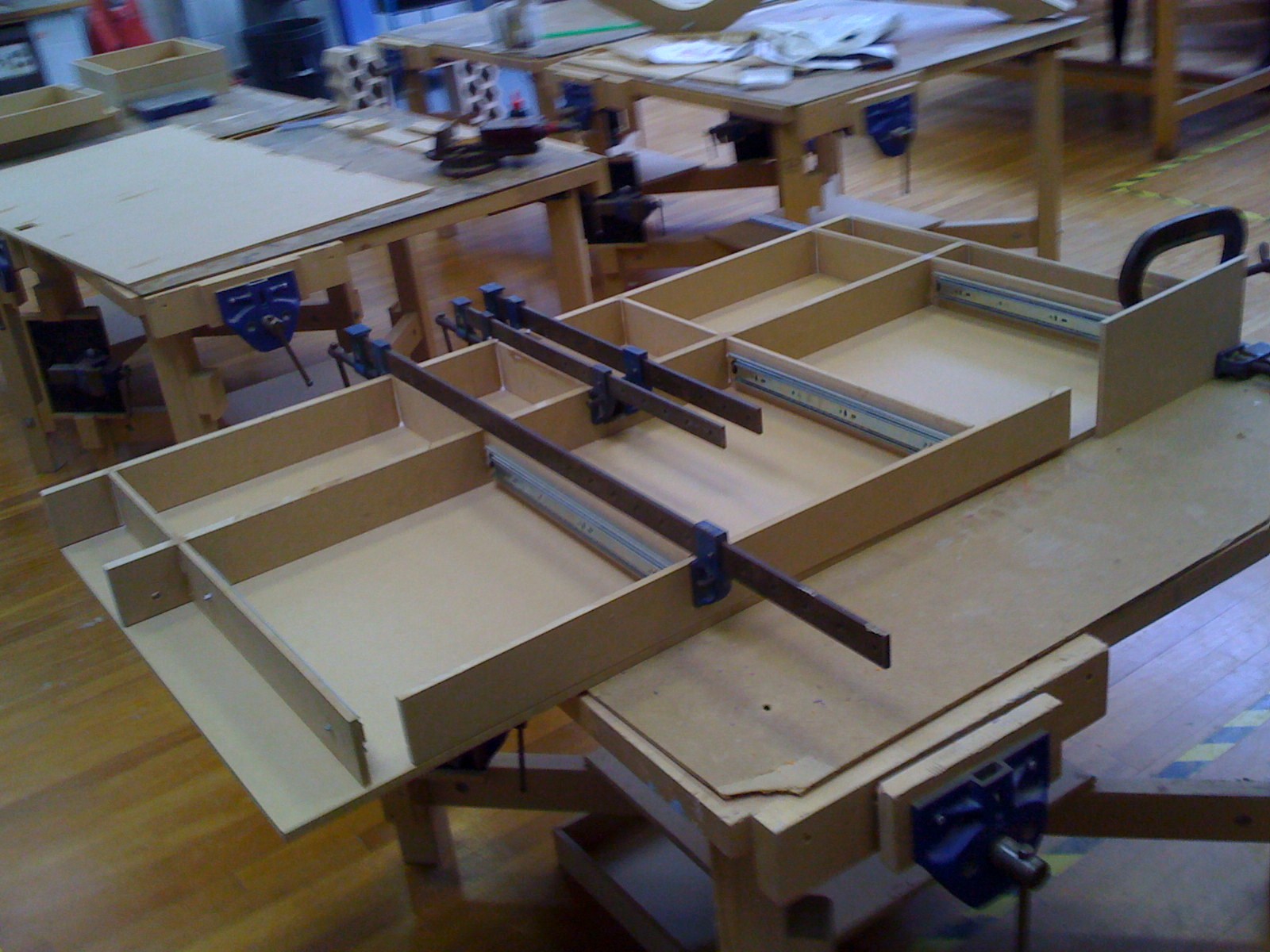

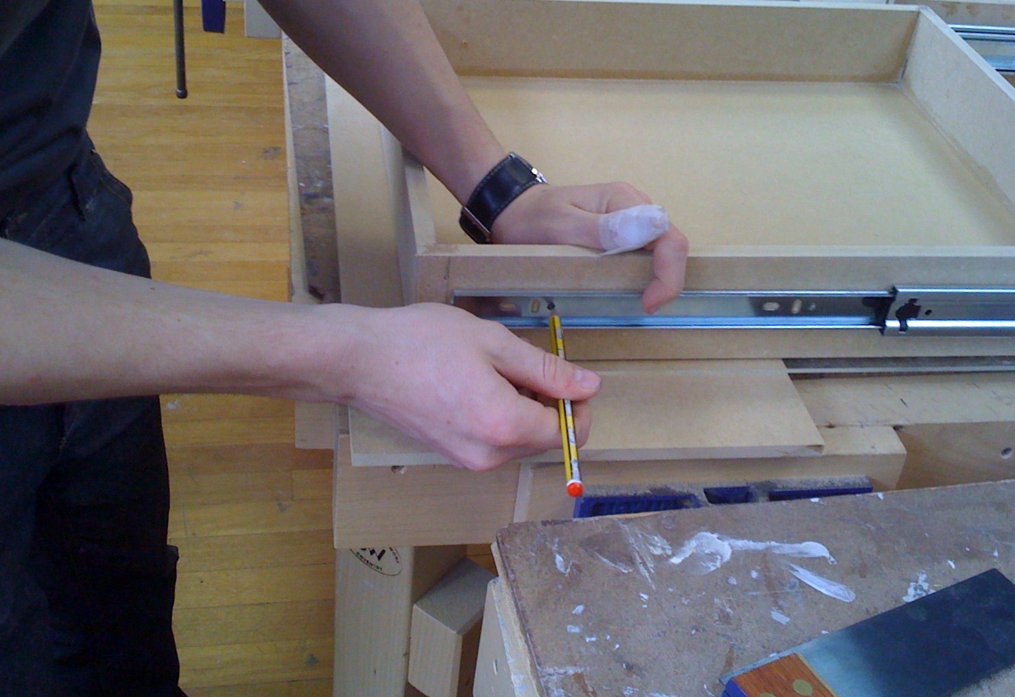

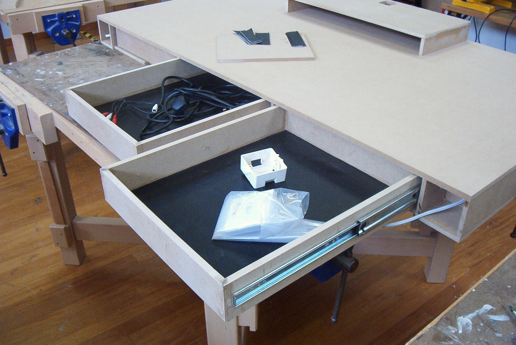

So I've fixed the drawer runners in and made the drawers which I'm going to line with some red/black faux leather or something.
Next stage is to work out all my electronics and make sure its right so I can then glue it all together and fit the wires and components in.
Going to sort out the metal things around the 3rd of March. I had some quotes but the prices were impossible. I'm off to see a university to help me with some better sources.
P.S. It's really annoying only being able to do a couple of hours at a time because thats the duration of the lessons...

Screwed the drawers onto the runners so they work now.

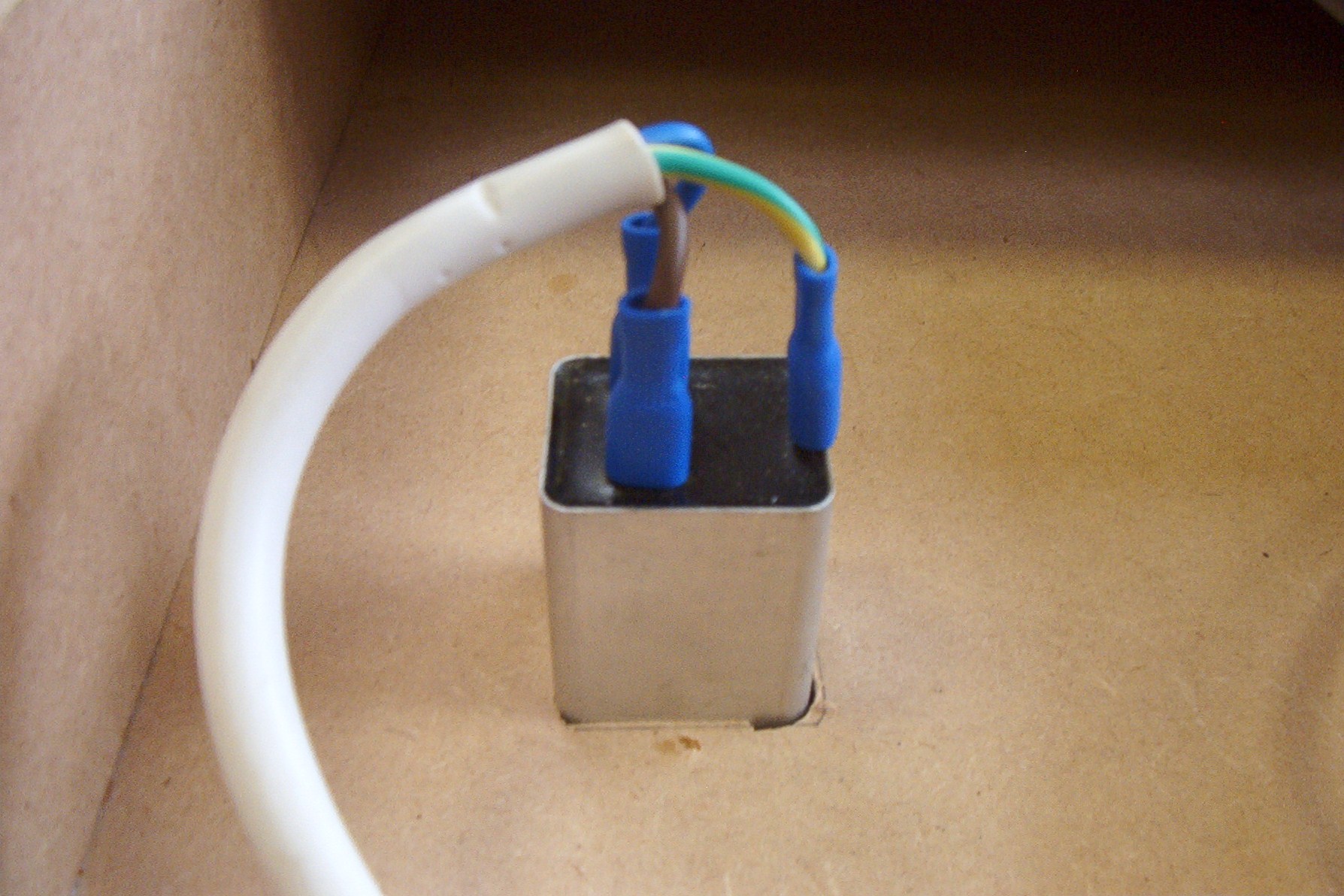

Ordered IEC Power socket to fix onto the underside of the desk for the power strip on the side.

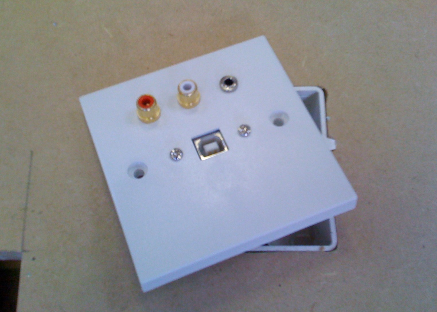

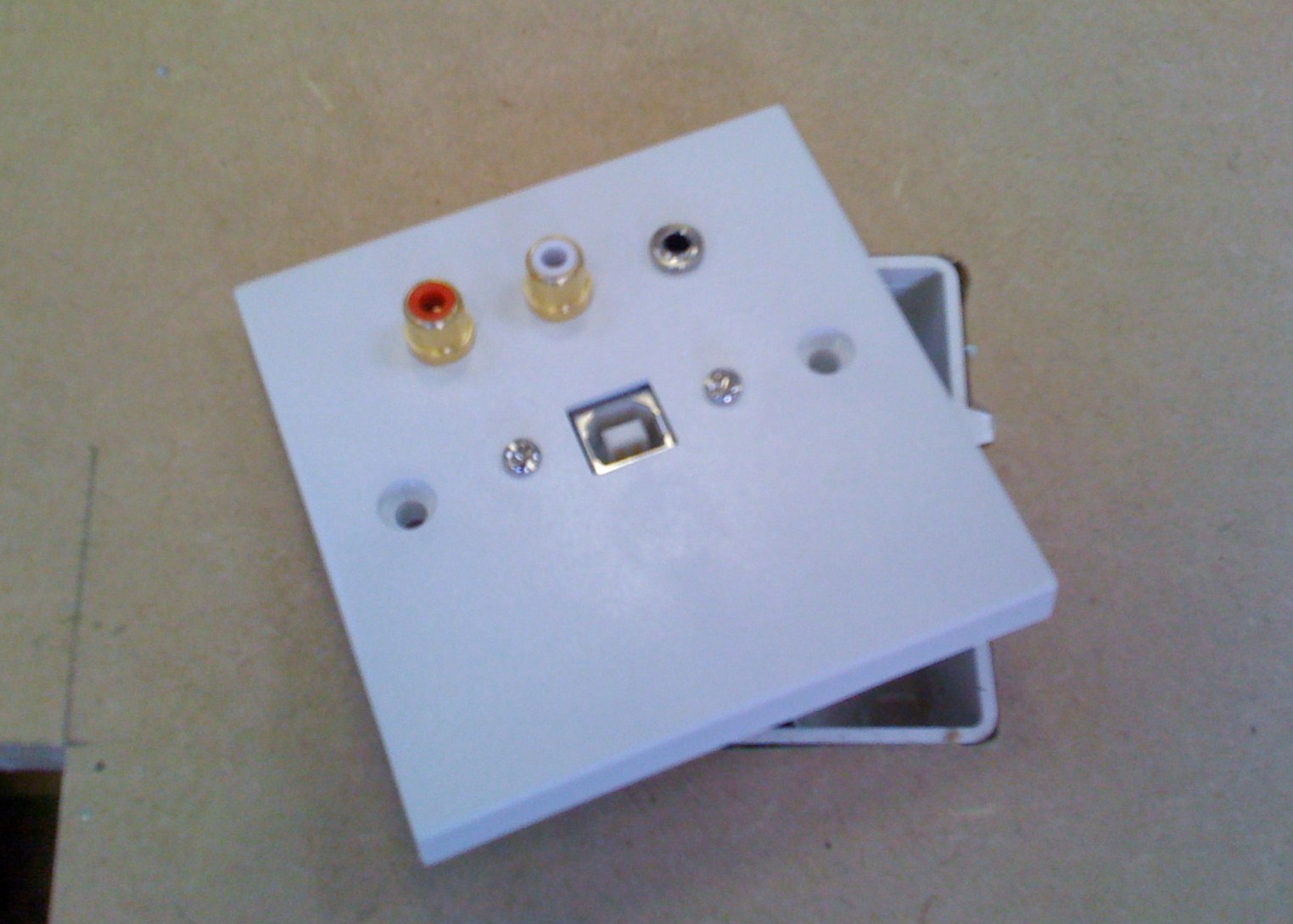

The custom connection plate came today with usb, x2 AUX and 3.5mm.
Also I made the cut out for the IEC power socket and fitted/screwed that in.

I bought some fake black leather to line the middle and right drawers with today whilst I was in town 😛

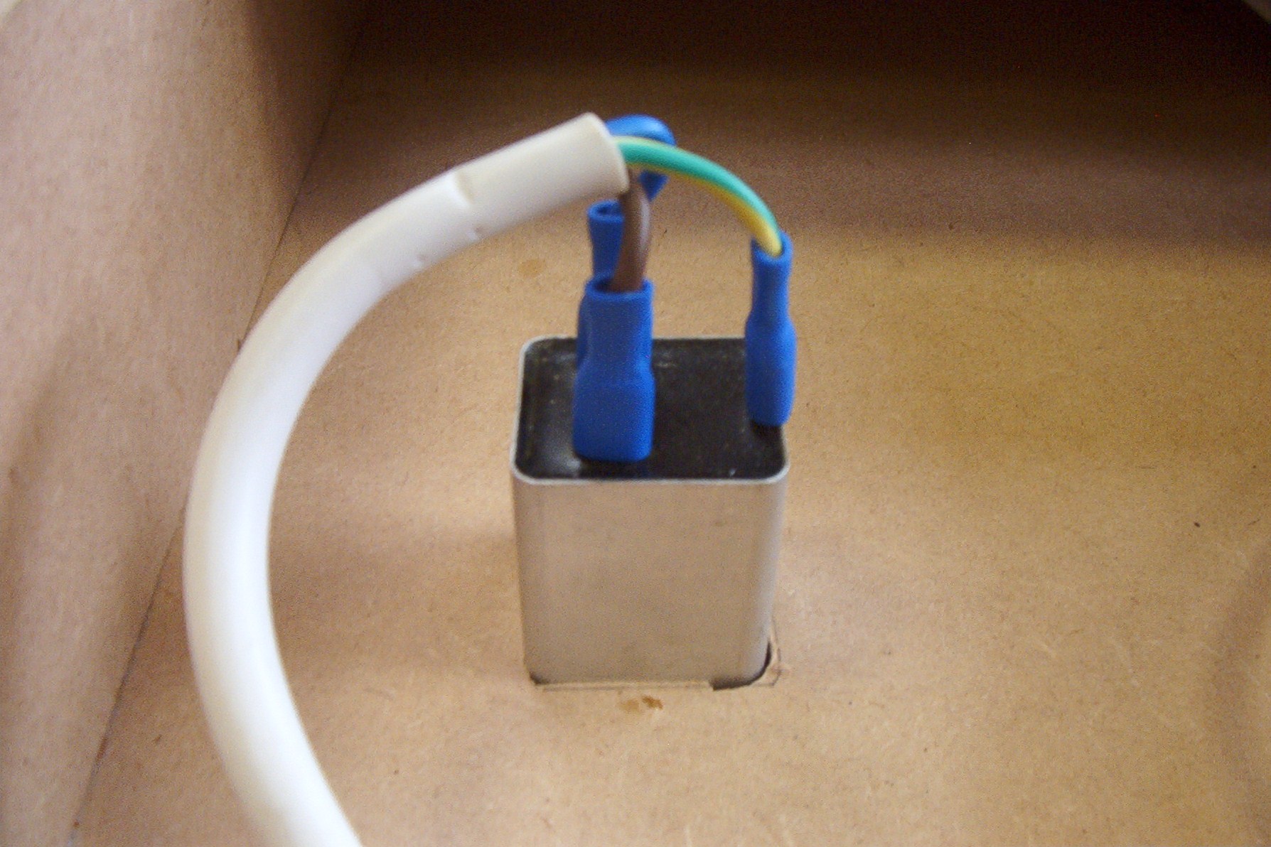

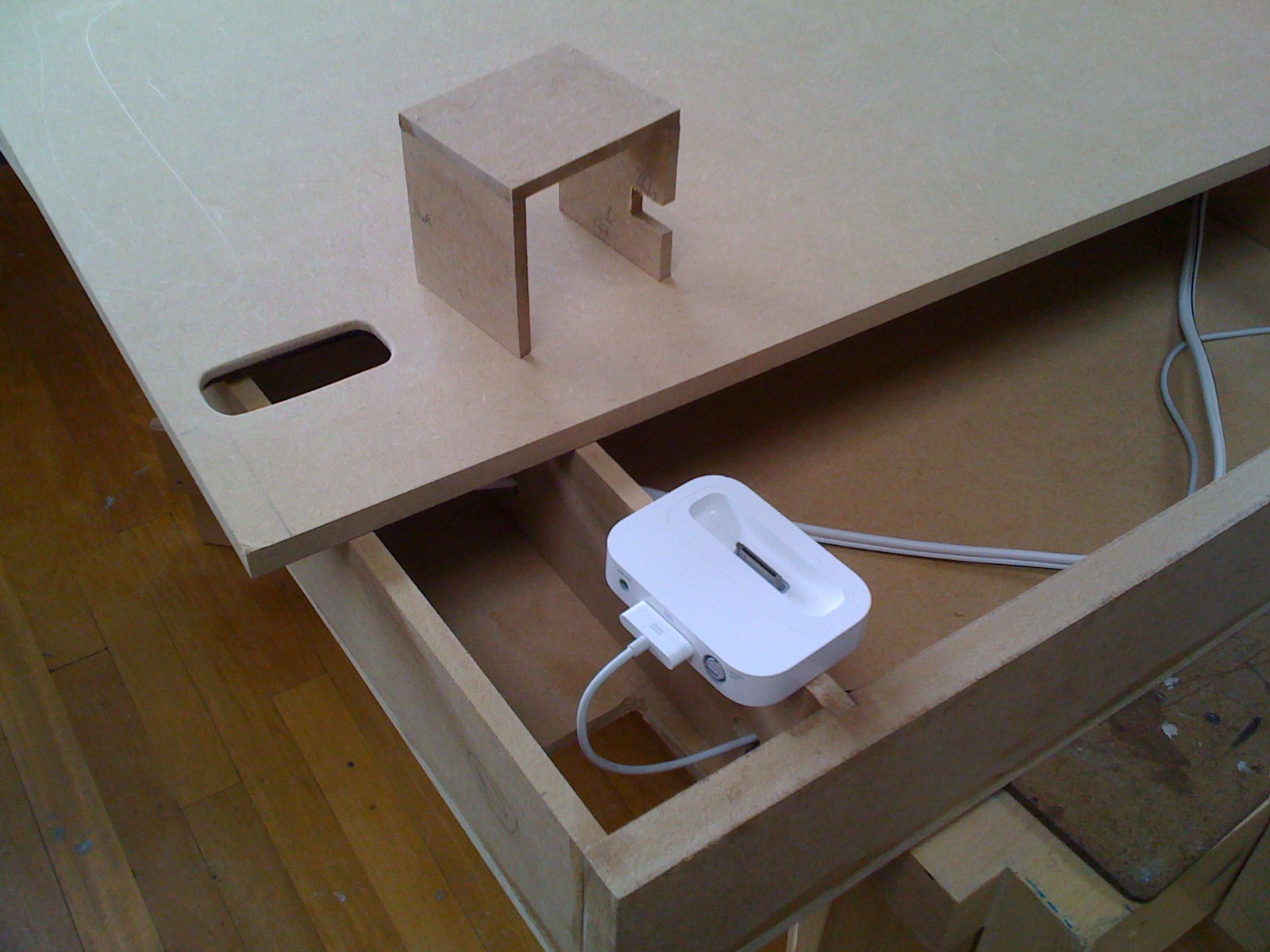

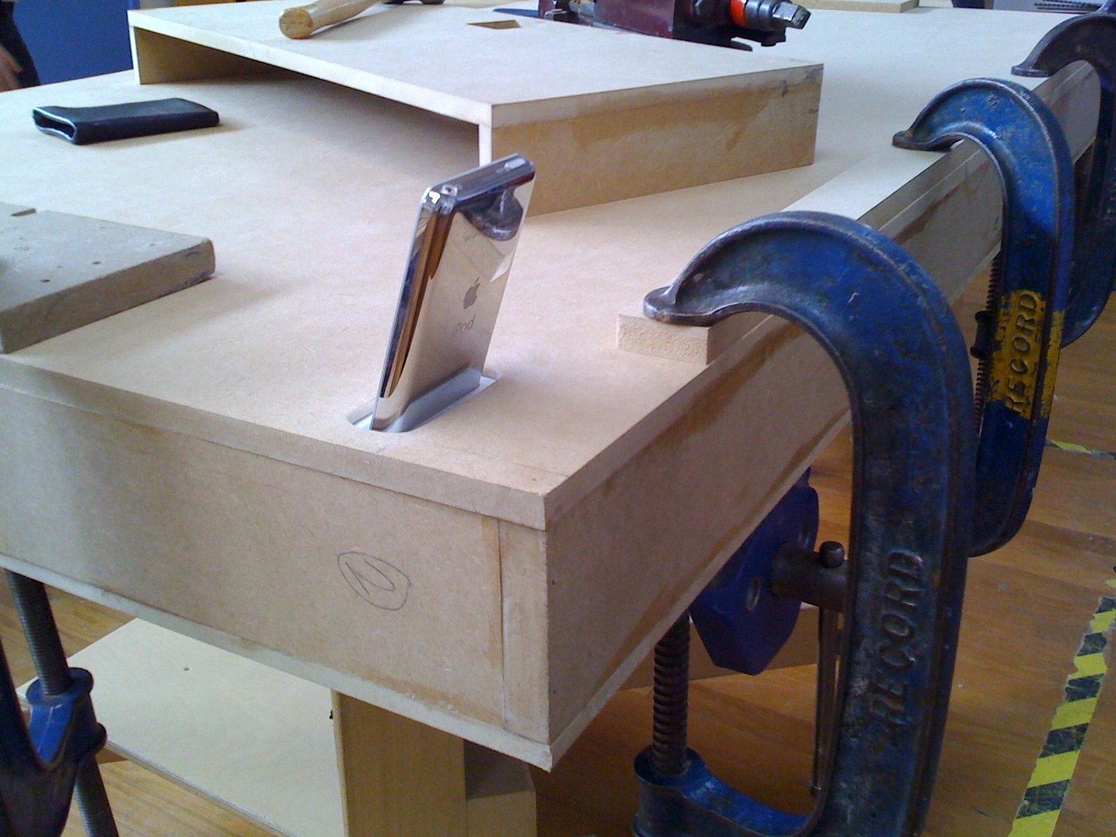

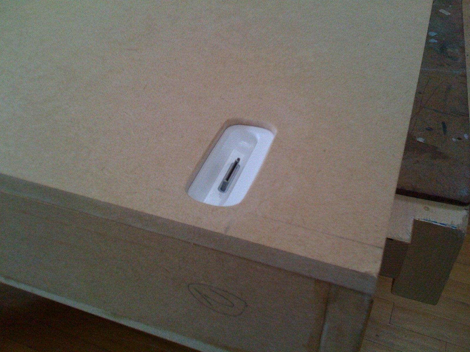

Update:

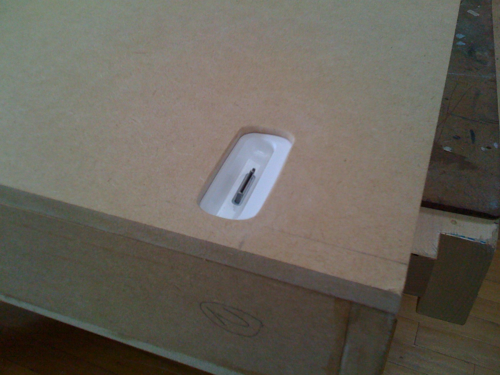

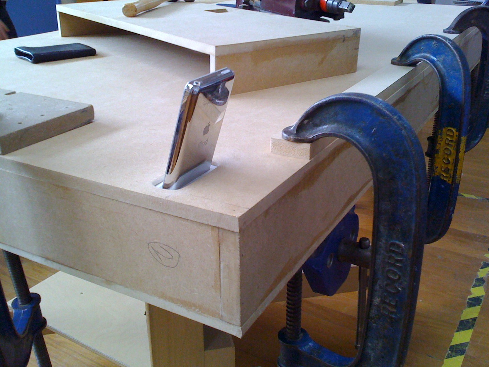

Right I've mounted my ipod dock in and made a little system that makes it removable incase of any worthy update or if it breaks etc...
Tomorrow morning I will be glueing the top on completely so I need to make sure everythings right, once thats dried I will sand down tomorrow probably.
The next thing is to get it painted and everything which hopfully will happen next week. I also need to sort out the legs and sheet metal.
Thinking about it, I'm not far off.
Heres a few pics.

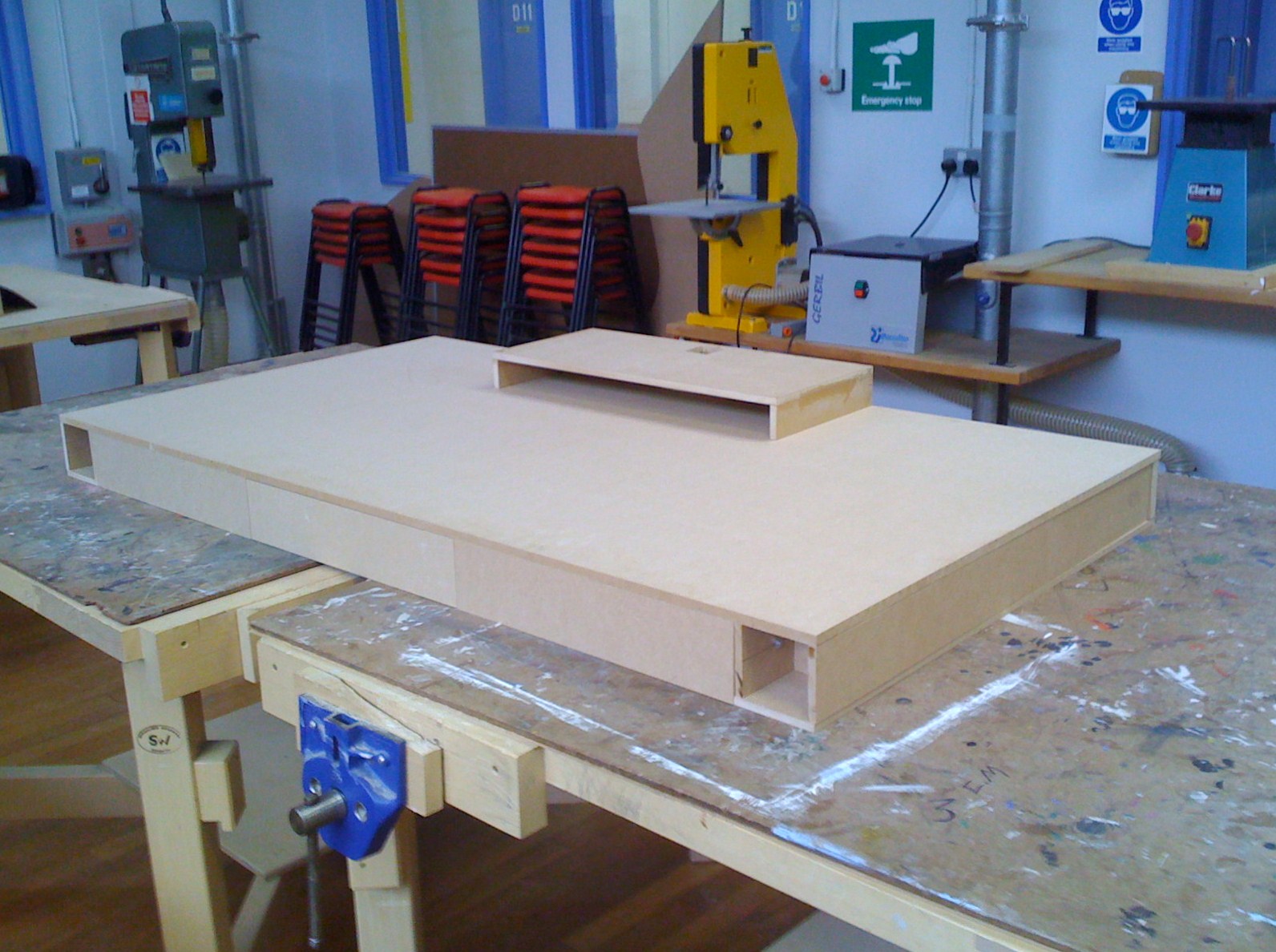

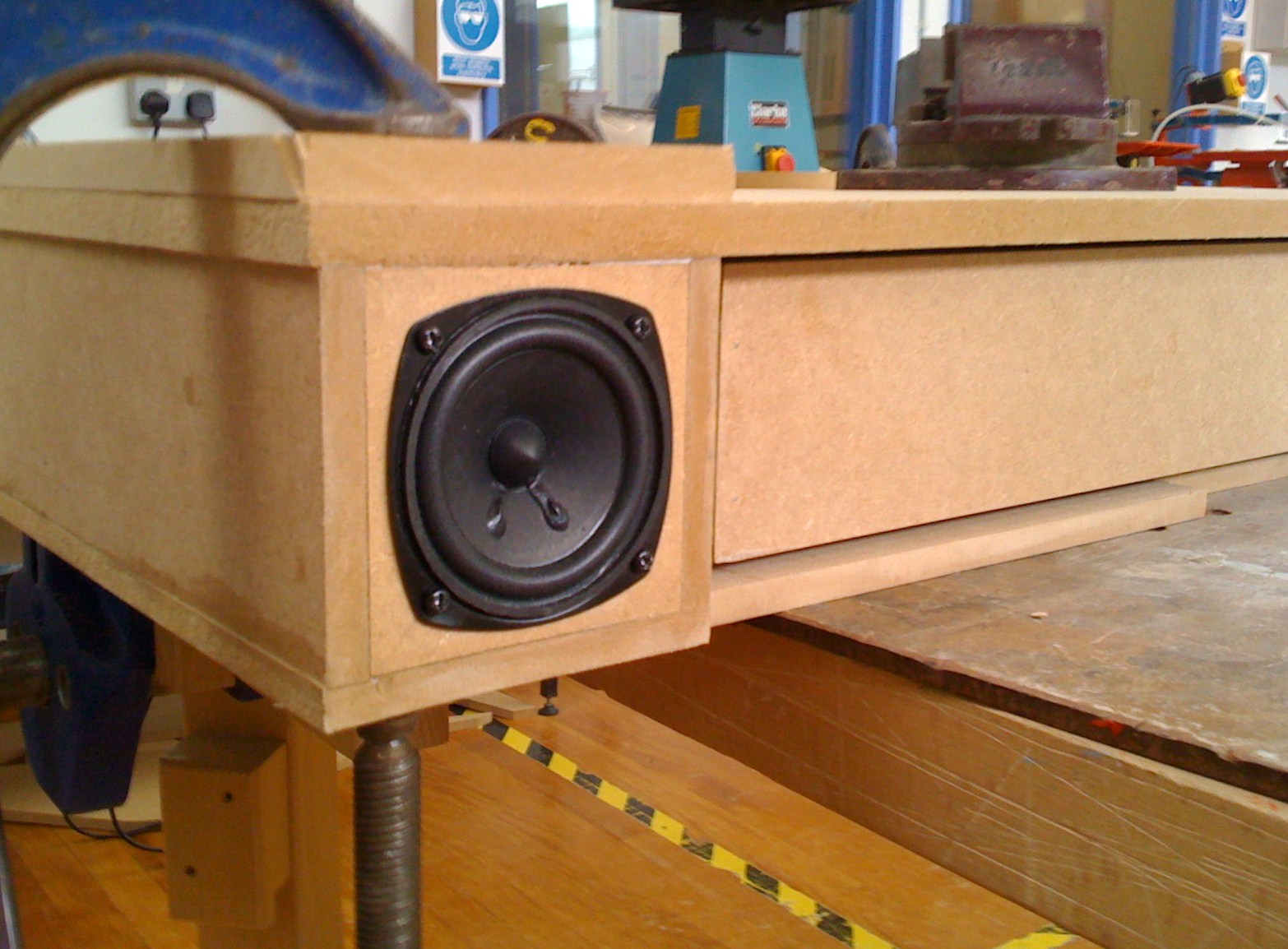

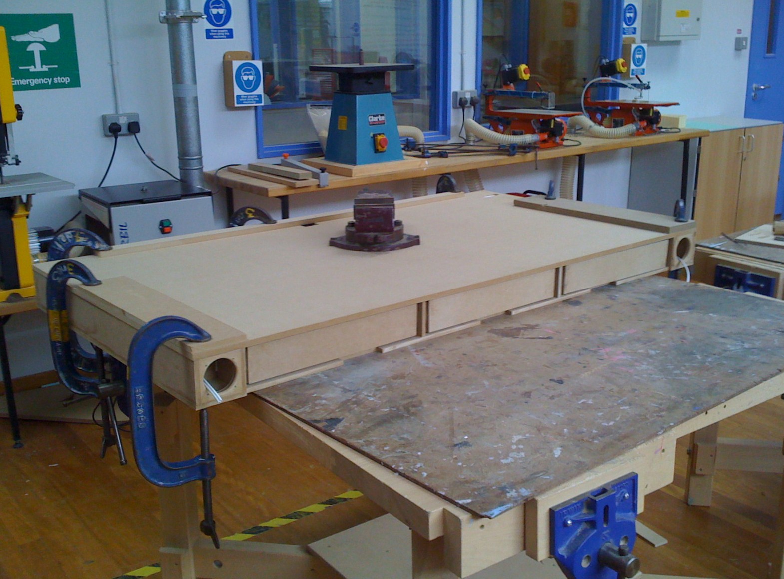

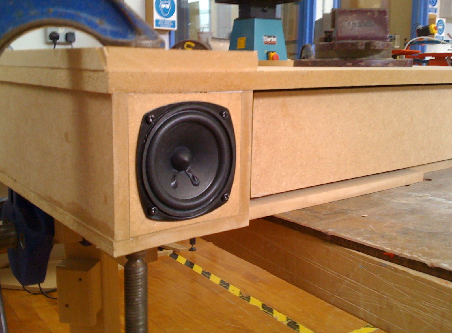

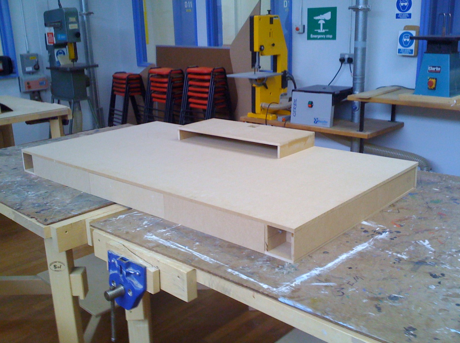

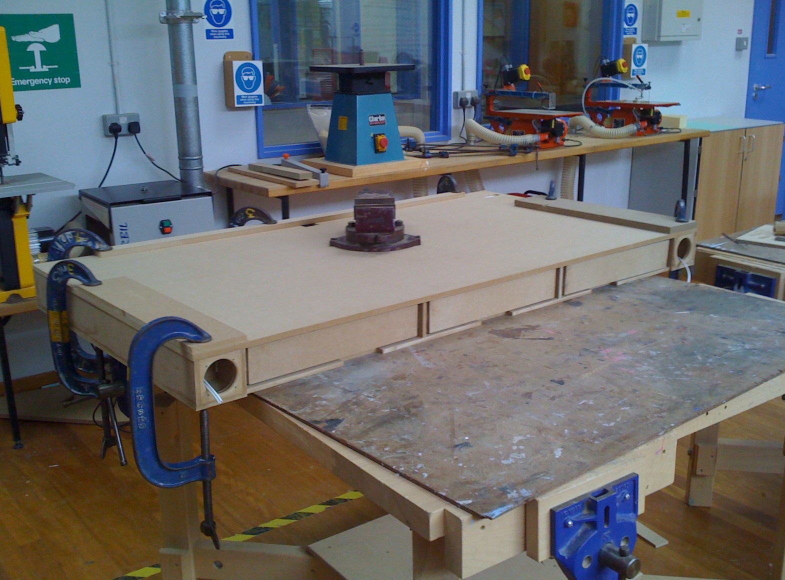

Tis done... I've sealed it all up, the top is now glued on, I've also made the speaker mounts and tied some cables up.
Sanding down then painting next week 😛 Can't wait!

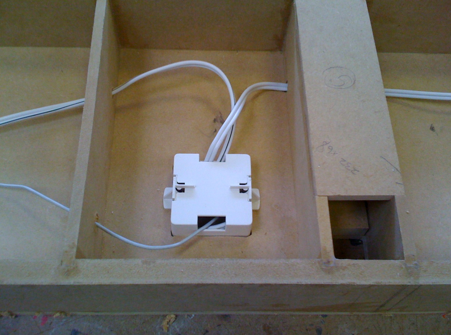

Did some testing of the cables today and temporarily wired the speakers in to give it a go, very nice 😛 a replacement for the radio thats broke in schools workshop atm. Getting a call back with a quote for the painting over the weekend and probably be painted next week.

Spillages - I have made the iPod dock completely removable and therefore replaceable if any damage or spillage happens. It may be possible to ovoid this with a sort of lid which I will investigate.
Heating in central drawer - I don't believe heating would be a problem but many people have commented on this issue. Once I have completed the desk I have to evaluate, make changes and test the product. I will 'load' up the middle drawer with alot of equipment and a digital thermometer to measure the heat. I do have about 3 fans and some heat sinks lying around that are designed for computer cases so I could see the impact these would have on the heat. I will also look into alternative ways to minimize heat.
