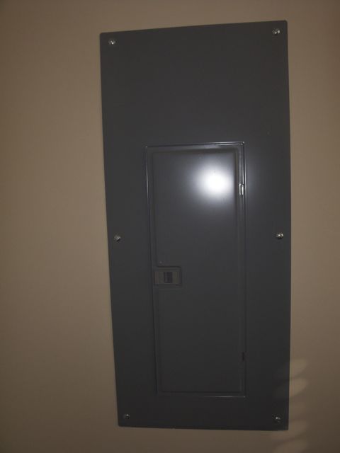

Usually mine are in the laundry room if I have one, in my place now it is actually in the spare bedroom (office) behind the door. Honestly, I'd be a bit annoyed if I moved in here intending to stay in the room with this bitch on my wall measuring 15" x 35". 😱
Anyway lionheartednyh, you won't die if you get shocked but in my case it really phased me.
Since you showed us yours.....
Mine's pretty bad too.... it's at eye-level, directly across from the master bedroom's door, so it's the first thing you see when you leave the bedroom. I may try to find a picture to cover it. I wish they would have just painted it.....it looks like they painted the bottom right corner at least...🙄

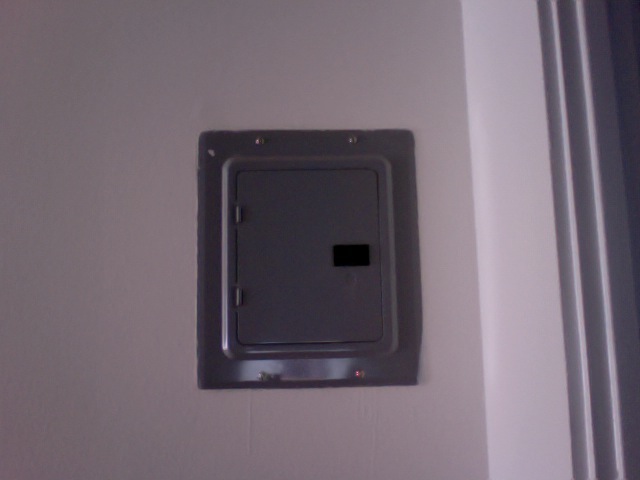

Yes they do. See it, on the right side.
I just moved out of that place, so I took photos of it after the move so that the property manager can't claim damage that doesn't exist (and make us pay for it).
