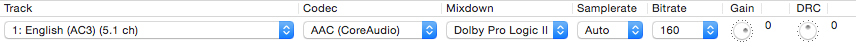

I would like to convert some videos into MP4 and I have done some research about Handbrake and its settings. For the audio settings it sets the first track to AAC and the second track to AC-3. As I have read, this is for compatibility.

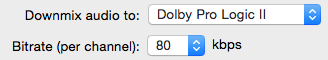

I was now wondering what a good bitrate would be to set? I know for example that Subler uses 96 kbps as default setting and Handbrake is currently set to 160 kbps. Since the AC-3 source is already compressed, I was wondering if it's worth to spend more then 96 kbps (Dolby Pro Logic II) on the AAC track.

So, I did some more encodes of the same material to test my settings. It seems that Handbrakes 160 kbps is equivalent to Subler's 80 kbps (per channel) setting. I was not able to find if Handbrakes setting is per channel or not, but from my tests (e.g. file size comparison) it seems to be the case, that Handbrake shows the bitrate for both channels.

Yup, I know that, hence the question if a high bitrate makes any sense in terms of quality. AC-3 is already compressed, so if you encode with 128 or 160 Kbit, does it really make sense? See my goal is optimization in terms of quality and file size. So of course I can just set Handbrake to 320 kbps and call it a day, however I might end up with a large file, that does sound exact the same as a 80 kbps encode but takes four time the space on my hard drive.
However, I am currently fine with a 96 kbps setting per channel, which is the equivalent of 192 kbps setting in handbrake and I – of course – pass through the ac-3.
