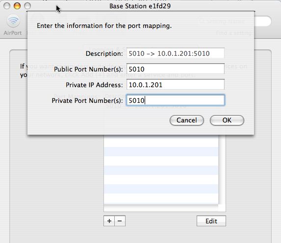

Can you tell me what to fill in?
Description:
Public Port Number:
Private IP Address: 10.0.1.201
Private Port Numbers:
Under the port mapping tab, map public port 5010 to private port 5010 for IP 10.0.1.201. Just fill in the fields. The "in" and "out" fields should be the same number (5010). If you want to stream music from your iMac, also open port 5012 the same way.
I put 10.0.1.201
This is my computer IP correct?
Now how do I access my computer?
what would be the URL
https://myips:10.0.1.201 ????

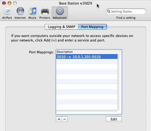

Here are the screen caps of the airport windows.

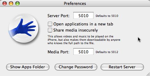

iphone remote
restart server button does not do anything.
Is it supposed to restart computer or the program?
^ it restarts the server,
You wont notice it... but it may cause you not to be able to access your Mac for a few seconds (from your iPhone)

you can see above I did set up port mapping.
look at screen capture.
did i do something wrong?
remotely waited 10 minutes until timed out.
locally it load right away.
Then it is all in the way your port mapping was setup, I don not have an airpot extreme, I have a linksys router, so I cant help you much there.

So I don't have that model Airport Extreme, either. But what you've done looks right. You are sure that the IP address of your iMac is correct? Have you got the Mac OS X firewall running? If so, have you opened port 5010?
yes IP address is correct and firewall is off.
this is very strange.
I even added additional ports 5011 & 5012

You handle this with the port mapping at your Airport Extreme. When it sees a request on port 5010, it redirects the request to port 5010 on the machine you specify with the private IP address, in your case you've used 10.0.1.201. You can check this in the System Prefs->Network->Airport->TCP/IP. Your computer's IP address is right there.
How do you know what computer your connecting too.
The port mapping tells the router which computer you want it to send requests for port 5010 to. That's the computer with your iSight attached.
How do I know what iSight on what computer I want to access?
If you have more than one computer with an iSight that you want to access, use a different port for each computer. The machines will have different IP addresses.
Let's say you have two machines, A and B, both with iSight cameras.
Machine A, lets say IP address is 10.0.1.3
Machine B, lets say IP address is 10.0.1.4
We'll use port 5010 for A and port 5012 for B. At the Airport Extreme, you would do something like the following...
Airport Port 5010 maps to 10.0.1.3 port 5010
Airport Port 5012 maps to 10.0.1.4 port 5012
On the iPhone Remote server running on Machine B, you would specify the server port (in Preferences) to be 5012.
And so you could have access to multiple machines on your home network.
So, from the iPhone, to access machine A you would go to URL https://123.456.7.8:5010/ and for machine B you would go to URL https://123.456.7.8:5012/
Use correct IP address
In order to access your computer remotely you have to use the public IP address of your computer (which you can find in the network preference pane) followed by a colon then the port # you've assigned to it. EG:
123.45.678:5012
You can't use the IP address assigned by the airport because that is not public.
