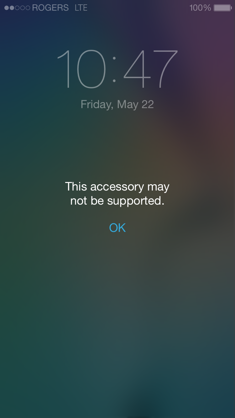

Getting this error on my iPhone 6 since 8.2 and 8.3 when it hits 100% plugged into my PC with Window 7, wall and car chargers are fine though.
Tried everything:
new genuine cables
diff PCs on Windows 7
loaded the ASUS AI charger drivers
cleaned the lightening cable port
restore as new
force and hard reboot
resetting all network settings
EDIT:
To trigger this error instantly, if I'm charging my S5 or transferring massive DATA from my HDD to my portable HDD. It's a voltage error readings from iOS 8.2 and onwards, never happened with iOS 8.0.
UPDATE:
Indeed this is a iOS update voltage problem, once the warning appears the charge stops and when you shutdown your PC, the charge resumes. It gets quite HOT after 2 hours
