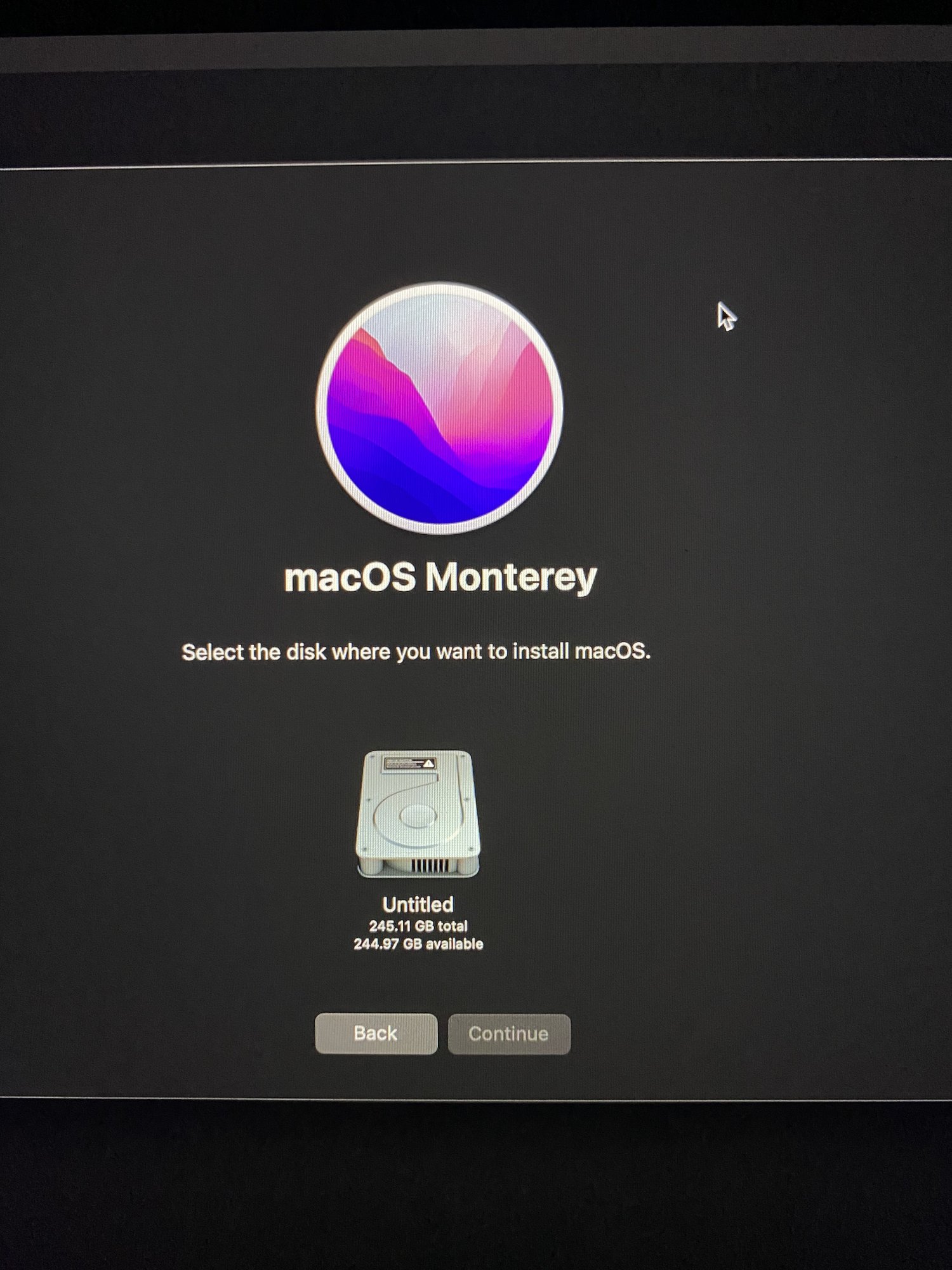

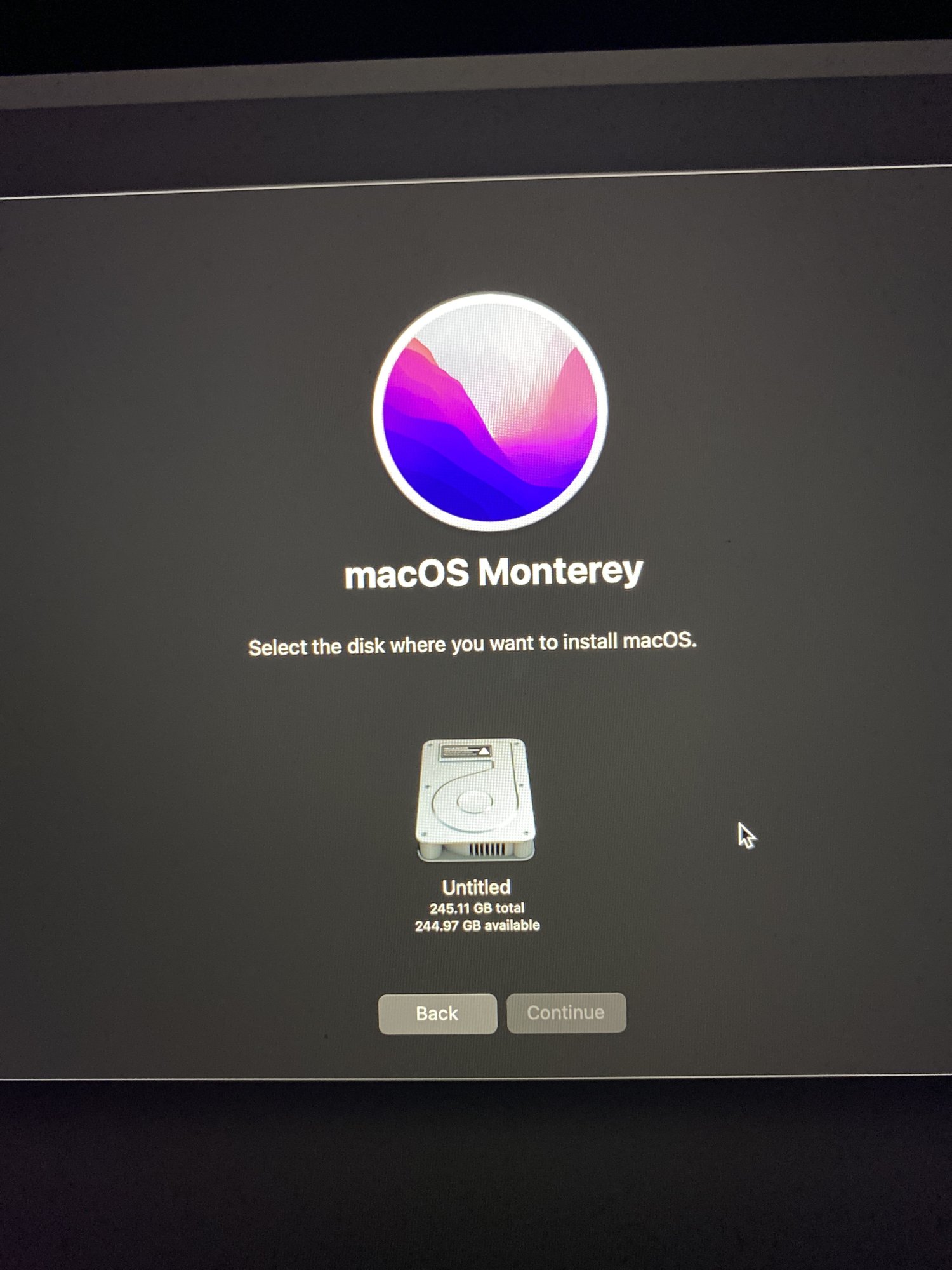

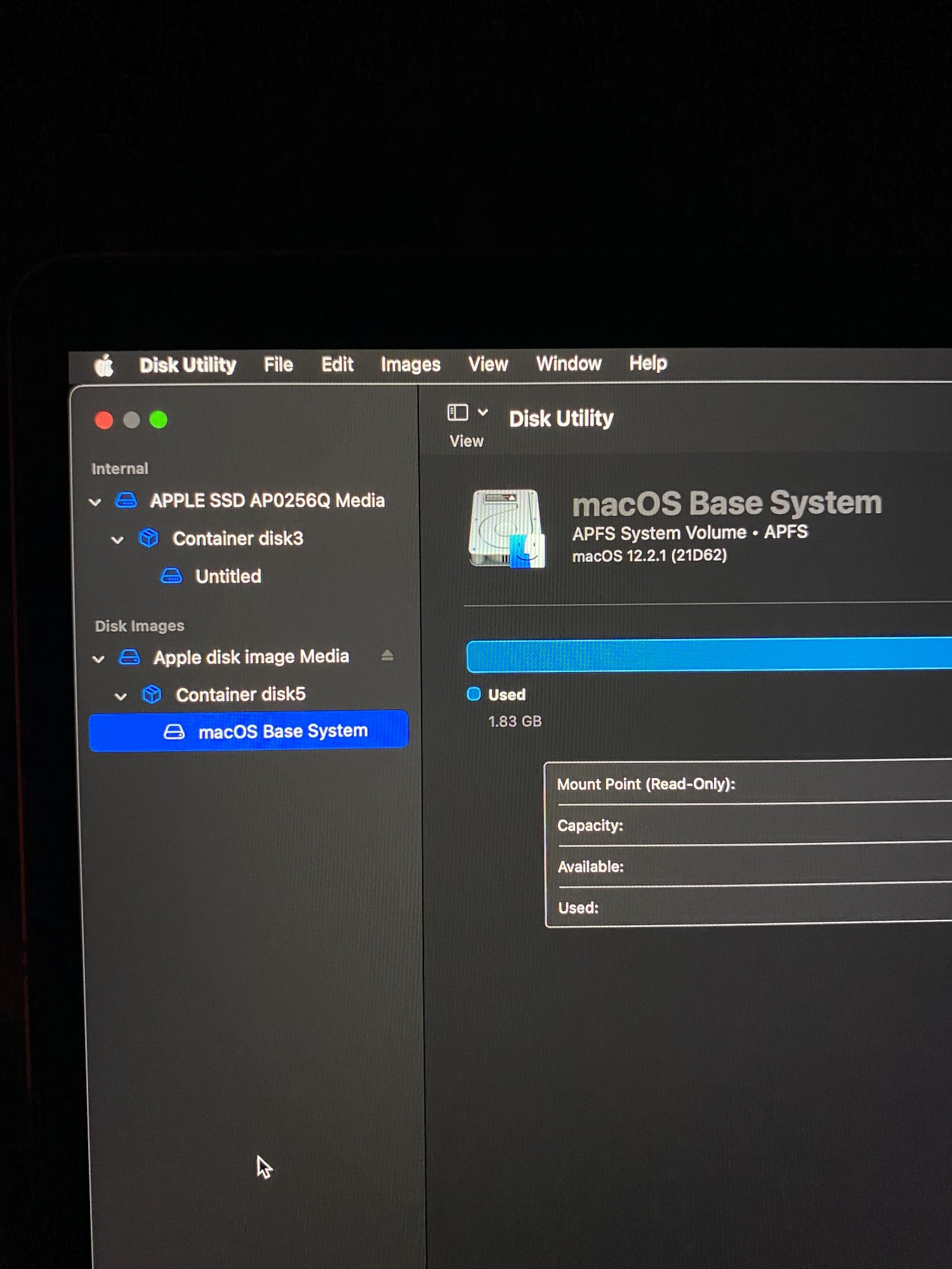

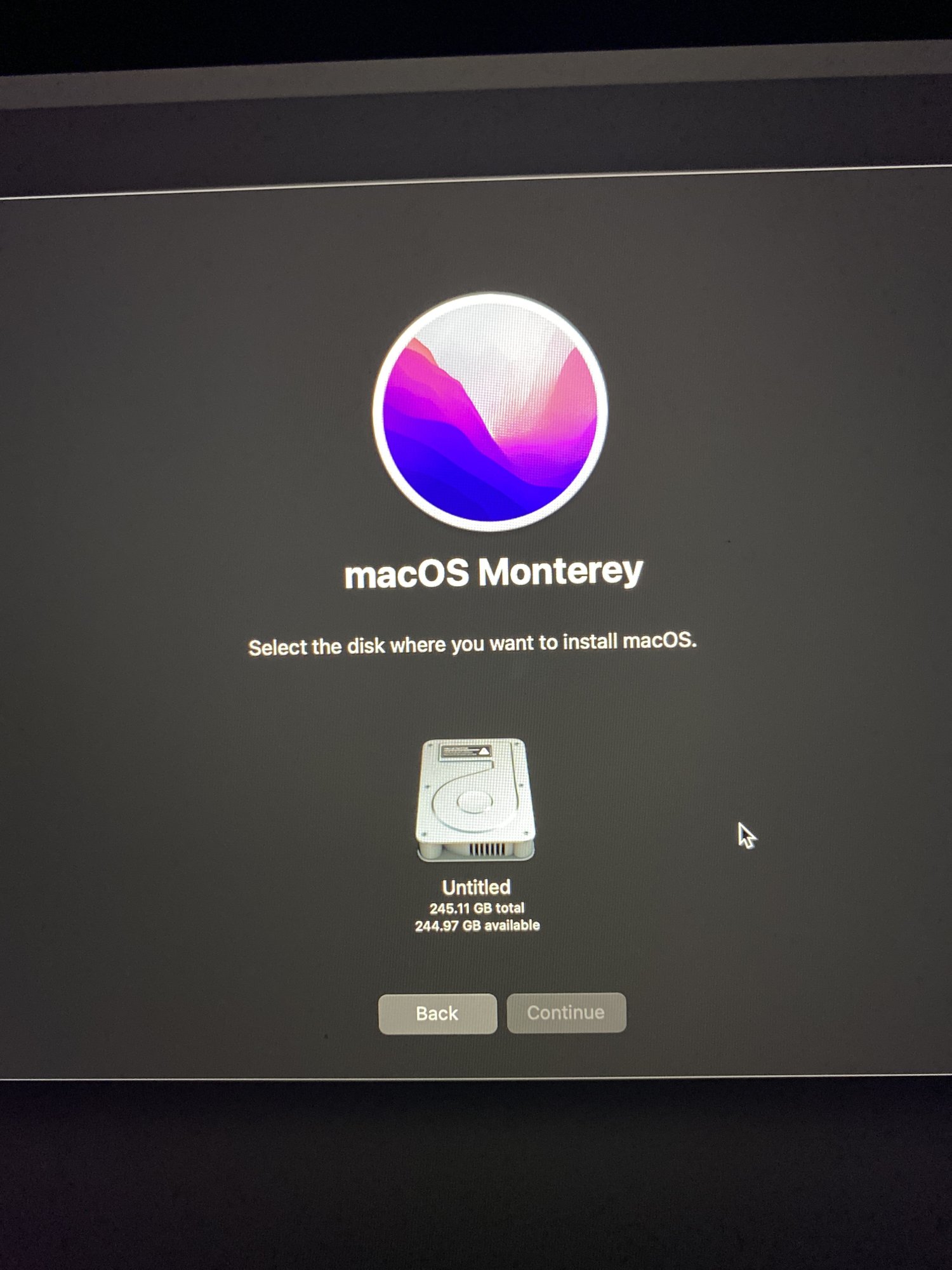

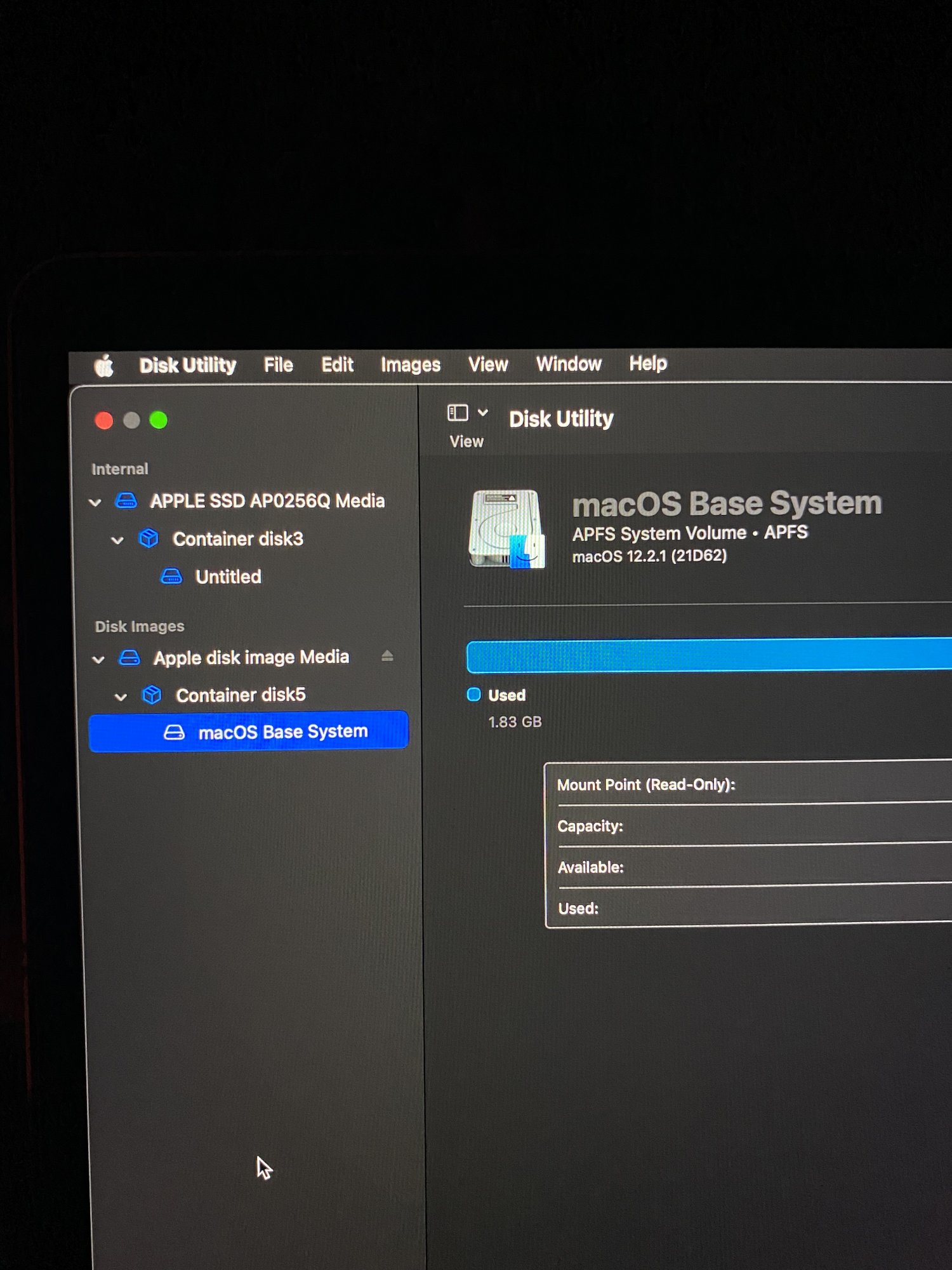

What they told me is that my Macintosh hd is not there and something about software
Quit Disk Utility and go back to the menu that gives you the option to reinstall macOS. Select that option and let it run until it's finished. Is that option available to you?
Yes. Select that disk and click Continue and let it reinstall the OS. It does look like it's missing your files though based on the total available storage. You may have lost all your files, but this will restore your computer. This may be what Apple was saying about your disk missing.
You may have lost all your files. Was there anything on there that wasn't backed up or extremely important?
