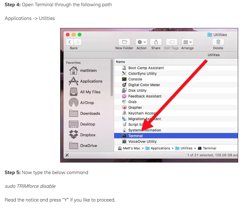

Has anyone tried to disable TRIM and noticed any difference or disadvantage? This article says:
"Be aware that disabling the TRIM command will reduce the performance and affect the lifespan of your SSD. Therefore, once you are done recovering your data, you should re-enable the TRIM command on your Mac. The steps are the same as the disabling process; just replace the disable command with sudo trimforce enable."
