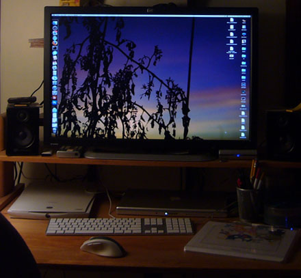

The height adjustment is very useful, especially if you have a monitor shelf. The HP can go almost down to the deck. It wasn't my primary concern when I bought the monitor - I just got lucky and it works perfectly with my desk. (quicky photo below)
