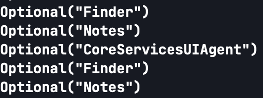

I have a similar problem in macOS 12.3.1, with the help of the debugging process mentioned above, I found that "CoreServicesUIAgent" is the app that is causing the defocus.
The problem is killing the process doesn't seem to fix the issue, because its staring it self automatically every while.

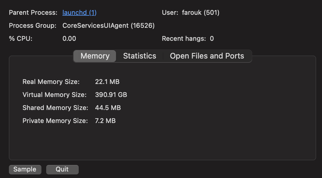

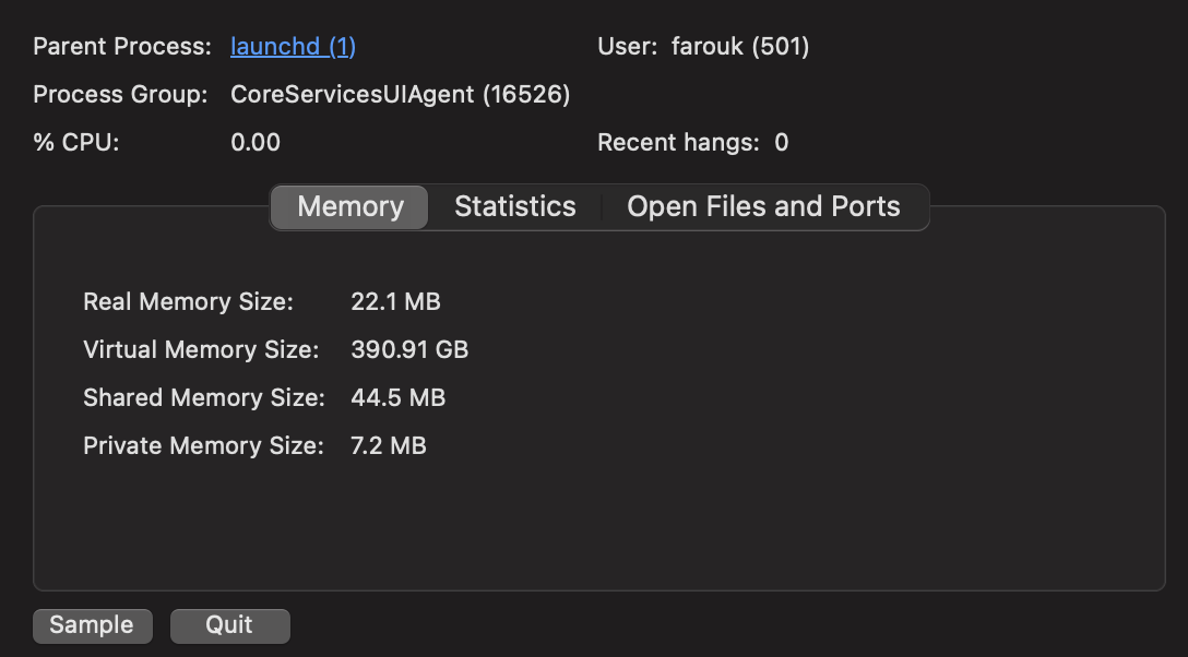

Yes I have done this search about CoreServicesUIAgent and get the same result you got. The problem is no UI is showing, I have restarted the mac several times, killed the process, but still no luck. Even I am not installing new software. It's automatically starting itself with no software installation process.
In addition to that it's consuming a high virtual memory!

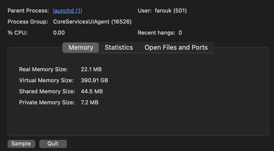

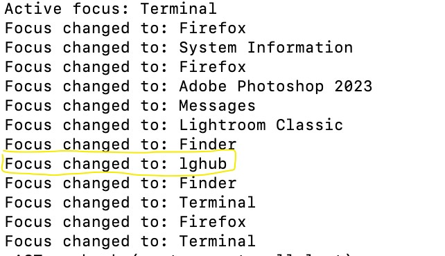

I'll be damned, it's the Logitech G Hub process that is stealing my focus.
This script was an excellent solution, thank you again @Brian33

Hi - thank you so much for this!
For me, there were two culprits:
Logitec G Hub
Jabber VDI (when an active VDI session was open within Citrix Workspace).
