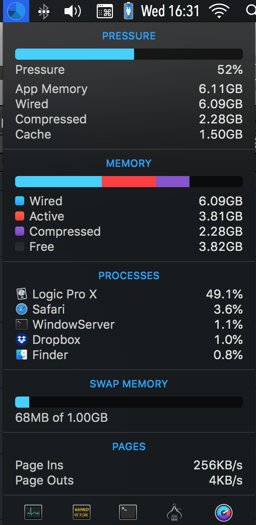

If I notice that Memory Pressure is low (less than 30%) but swap used is upwards of 1GB does that mean that I am running out of memory? I am confused about which is more relevant to my RAM usage.
I seriously doubt those two happen at the same time (pressure below 30% and swap 1GB +)
running a memory heavy logic project, and pressure is well over 50% while swap is not even 100mb

Here's a screenshot with a typical After Effects project open. Sketch, Mail, Safari, and Powerpoint are also open.
Maybe it just has to do with After Effects?
oh wow!
Looks like After Effects does memory wildly different.
Right now Logic uses 7.5GB but 6.15 is shown as "wired", while on your screenshot there's much less wired memory (i guess thats why you have lower memory pressure) but much more swap. Which OS version are you running?
oh wow!

So should I be concerned about the Swap Memory even when the memory pressure is low? I'm not sure I'm grasping how this works.
https://support.apple.com/en-us/HT201464#memory
If i recall correctly, in general if memory pressure is in the green, you're good to go. But I'm used to swap = bad, so if i see im hitting it way too hard i'm always considering memory upgrade
