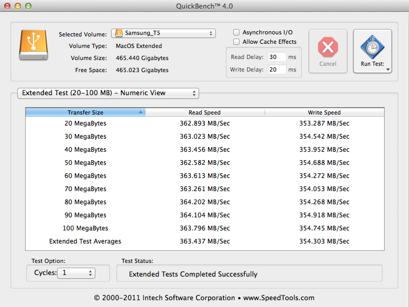

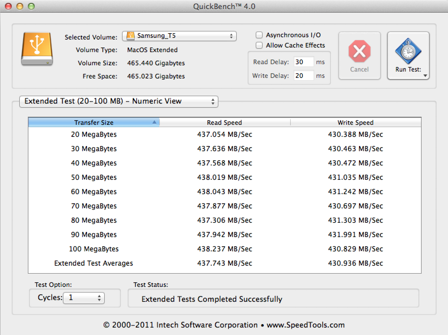

I had an old flash drive connected as well - yanking that confirmed the T5 is using UASP. I've also attached pcitree.sh's output with the Thunderbolt 2 dock to post #22.
The Thunderbolt 1 host controller is running at PCIe Gen 1 speed again (10 GT/s total) just like when the Kanex KTU10 Thunderbolt 1 dock was connected. Again, this is not a problem since the USB and Ethernet controllers are only 5 GT/s and 2.5 GT/s. It could be a problem if you chained multiple devices and tried an ATTO Disk Benchmark of multiple USB disks at once.

Native: the numbers to aim for.
Belkin (Fresco Logic FL1100 @ PCIe 1.0 ×1): the PCIe bottleneck rears its ugly head (but still 50% better than before!).
CalDigit (Fresco Logic FL1100 @ PCIe 2.0 ×1): still ≈17% short of the benchmark.

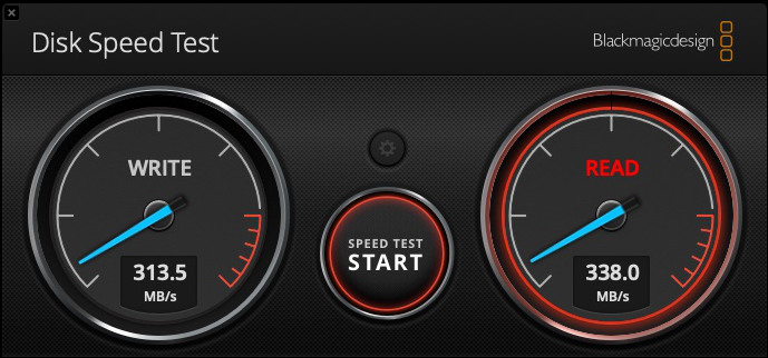

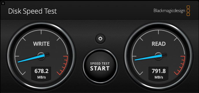

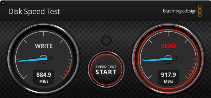

Here is a quick comparison of mine. MBP mid 2014 and Samsung 970 EVO Plus in Inateck USB-case. Don't know if it in any way relates to your results but anyways.
First natively plugged directly to the MBP:
And then into the Blackmagic RX580 TB3 eGPU which also has 4 USB-ports in the back so a kind of a TB dock 😉
This is quite good! 👍
And then to make this little about iMac 2011 the same drive plugged to the Elgato Thuderbolt Dock 2 which is connected to my iMac 27" 2011 via TB:
Don't know if the test methods between these 2 benchmark sw produce comparable results but if they do it seems like the USB in your Caldigit is a bit more efficient than the Elgatos.
Reactions: Amethyst1

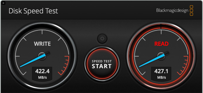

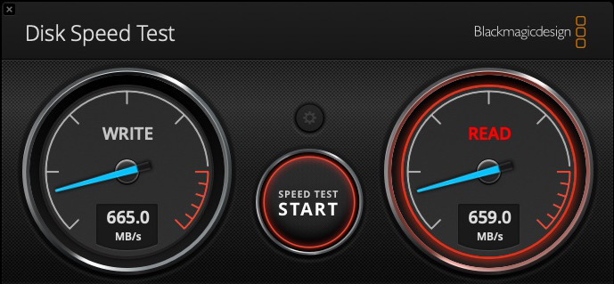

And then...tadaa! The iMac 2011 27".
1. tried to plug the Inateck FE2025 -USB case with Apple Thunderbolt cable and TB2-TB3 adapter directly to the Elgato TB dock 2. Doesn't work. Power led on Inateck does not light up.
2. then I connected the eGPU to the Elgato TB dock 2 using the Apple adapter and the Inateck USB case again to the eGPU's second TB3 port. Had to use Apple 2m TB2 cable due distance. This combo works without any drivers so the eGPU works as a fast hub for the iMac (doesn't work as eGPU though)! Thanks for the tip Amethyst1, this was new to me! 👍
Here are the results:
So, now I know what to use if/when I need decently fast transfer route for external USB-drives and iMac. I need to investigate how my other USB 3.x cases work with this or do they work at all.

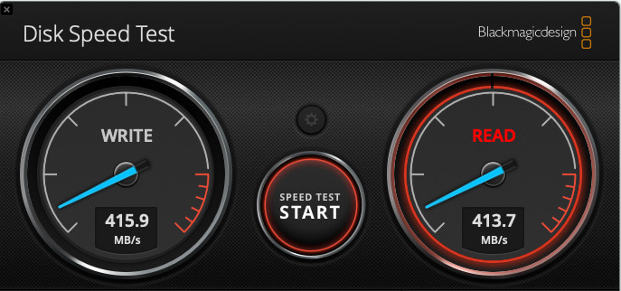

Allright - so, now this is tested. The Elgato TB Dock 2 does indeed limit transfer speed compared to directly connecting the eGPU to the iMac 27" 2011.
Here is the result for direct connection (compare to post #42):
iMac 2011 Samsung 970 Evo Plus Inateck case BM eGPU RX580 direct connection.jpg
So, in write speed we get only about 13MB/s better result but on read speed side we are seeing a significant 132MB/s improvement! 👍😎
