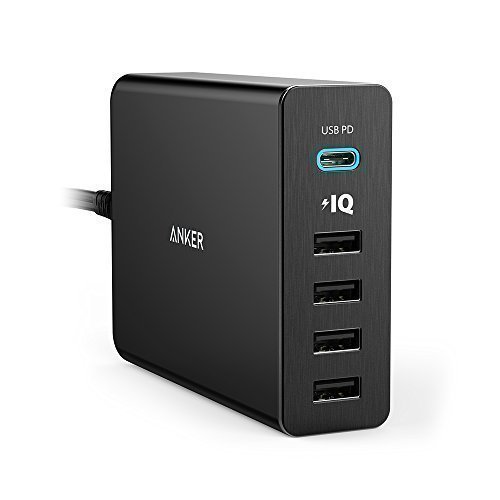

Get this: https://www.amazon.com/Anker-Delive...499715076&sr=8-3&keywords=anker+usb+c+charger
works great on my 2016 rMB and even fast charges iPP 12

Here is what I use for all my Apple products.......one charger that I can charge all electronics all at once.
iPhones, iPads, Macbook, etc.
Little more pricey, but for what it can do, is very worth it to me.
I have one at home and one I use for travel....very slick & compact.
https://www.amazon.com/gp/product/B01D8C6ULO/ref=oh_aui_search_detailpage?ie=UTF8&psc=1
When touring on the motorcycle I also use it to charge our Bluetooth helmet headsets.
I can confirm that the above Anker charger works fine for the MacBook. Also, in spite of what is stated in the question and answer section at Amazon, current versions do charge when connected to the Apple Digital AV adapter.
