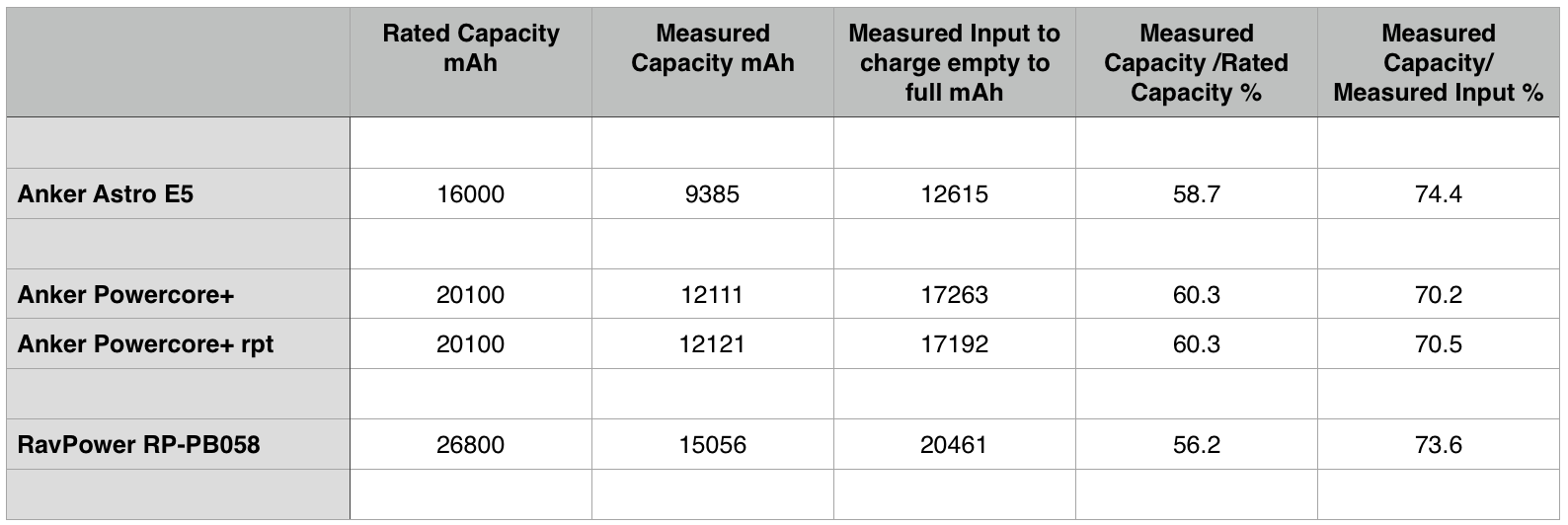

I have had the RavPower for a day now and done a full charge-discharge-recharge cycle on it using the Drok USB meter.
Because the Drok is a USB-A device I can't use it to measure USB-PD 30W charging, which will need a USB-C meter like this Satachi which I have on order. I will try and do some simple comparisons of charge time using the USB-PD capability of the RavPower next week.
I have used the Drok to measure the RavPower capacity, which I have also done for the Anker Astro E5 and Anker Powercore+. The results are shown in the table below.
As expected they all tell a very similar story, which I have also had confirmed by Anker that this is normal and my Powercore+ is within spec. As I said before I wouldn't be very happy to go into a pub and order a pint of beer, only to find it was only possible to drink a bit over half of it! These things should be marketed based on their usable capacity.
Thanks. 15.000mAh for the Rav. It will charge my rMB more than 3 times since its battery is down at 4100mAh after 450 cycles in almost 2 years.
It is what I expected but I agree that only 56% of its rated capacity is still disappointing.
I think we just have to lower our expectations of these devices. But it annoys me that in this day and age we can be so misled by the marketing information.

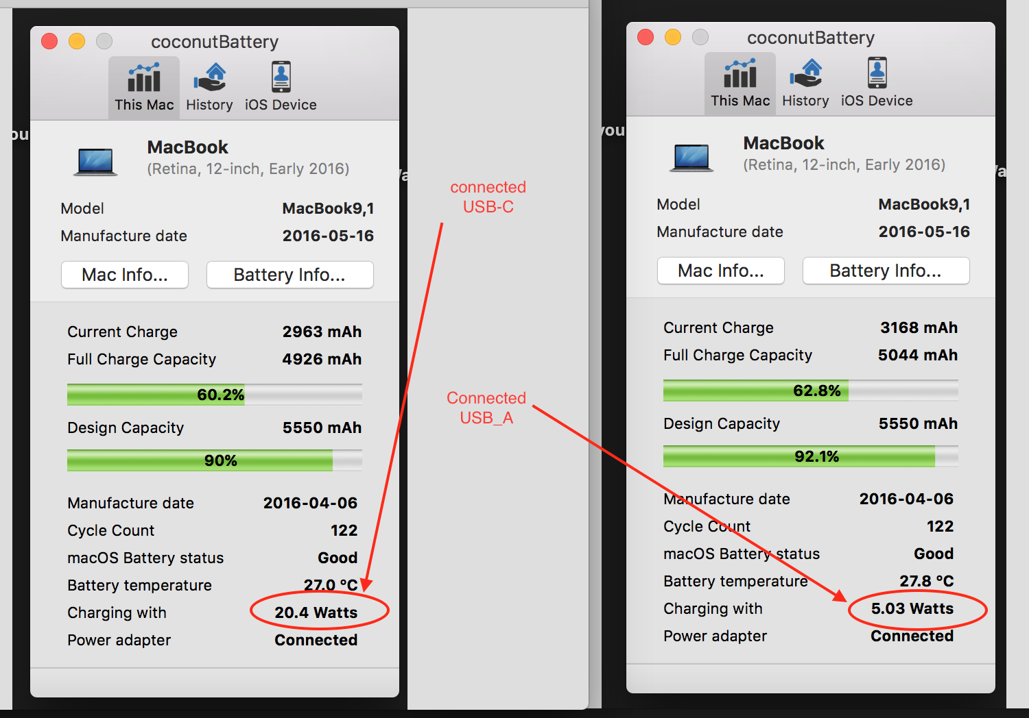

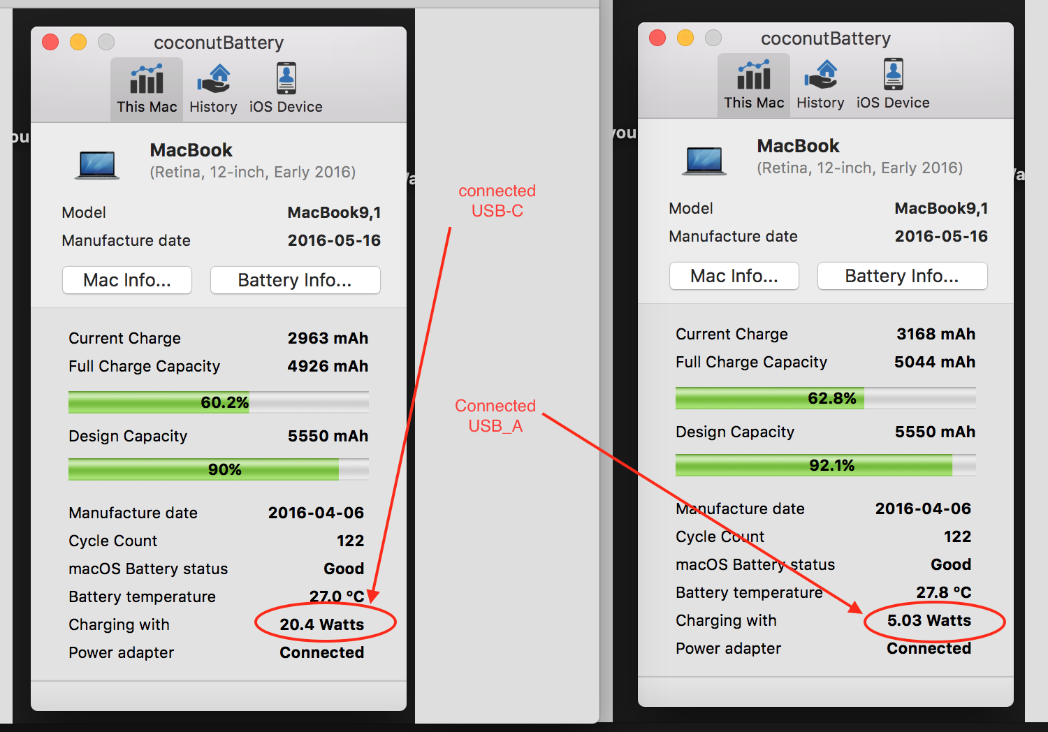

Without a USB-C power meter I can't make direct measurements in USB-PD mode, which only happens when connected with a USB-C to USB-C cable which complies with the USB-PD spec (not all do, and cable not supplied with the RavPower).
The best I can do is observe charging rate with Coconut Battery app connected by USB-C and USB-A. With USB-C the rMB is charges with at 20 W and with USB-A with 5 W. See screen shot below. This is the correct difference of 15W. The reason the values are not the max values of 30W and 15W is that the rMB is running and Coconut Battery can only show the net charging rate, i.e. difference between power input and current power usage.
One very disconcerting thing I found when I first connected the RavPower with the USB-C to USB-C cable was that the rMB was charging the RavPower, not the other way round. I had seen something about this in my reading up and the solution was to press and hold the button on the RavPower to reverse the flow. This did not happen on subsequent occasions, even with a charge in between. There is nothing about this in the "manual" (tiny leaflet) which came with it or on the RavPower website. I can't find a proper manual on the website, but will ask RavPower.
An update to this. The need to reverse the flow has been necessary a number of times, not just the first. The button sometimes needs to pressed a few times to get the change of flow to "stick".
RavPower have replied to my email saying this is quite normal, but didn't answer my question about a proper manual or any mention of it in the leaflet supplied with it....but they "got my concern"!
