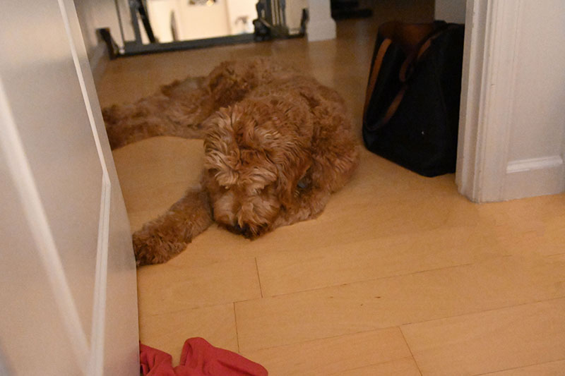

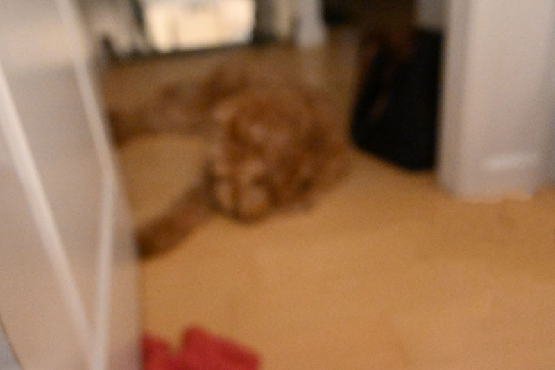

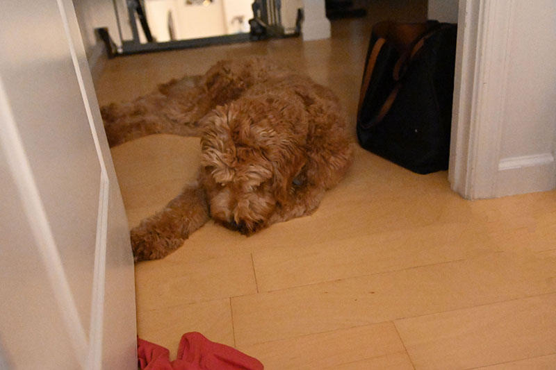

I'm really wondering if it's my FTZ adapter. It was dimly lit room shooting a picture of my dog on the floor about 6 or 7 feet away (just a test photo). Sounds like a tough shot but the D7500 was able to do it on the same settings. I tried changing the live view option that Molly suggested but that didn't seem to make a change. Sometimes the focus goes wildly out of focus and it doesn't know how to focus at all and I have to step in with the manual focus and then it goes back on track and finds a reasonable subject. This is true with the 35mm f/1.8 and the 24-70 f/2.8 Nikkor lenses. But it seems it's more of a all or or nothing thing with the FTZ adapter? It works or it doesn't? Most of the time, in proper light, it works excellent.
I'm really torn. How often am I going to be in these low light situations - I'm not sure, but I would like the versatility. The video that the Z50 captured last night in normal conditions was honestly absolutely gorgeous and stunning, which is very attractive to me. It autofocuses beautifully as my 13 month old flailed around. 😂 But I also think the most frequent video opportunities I'll have will be those impromptu family moments and my iPhone may be the primary shooter for those. I also really love the exposure in real time as I learn more of how to shoot good photos, but I'm sure I can continue to learn on a traditional dSLR (just less immediate gratification).
Here are the same pictures back to back - one where it could focus and another where it could not:
Z50
24 mm f/2.8
ISO 28,800 (auto)
Shutter speed: 1/125 (too fast I know... but also happens on slower shutter)
FYI - both pictures have underwear quickly photoshopped out from the right, LOL. It was a test pic! 😳😅🤪
Z50
24 mm f/2.8
ISO 28,800 (auto)
FYI - both pictures have underwear quickly photoshopped out from the right, LOL. It was a test pic! 😳😅🤪View attachment 964193View attachment 964194
I would not ever judge a camera's focusing ability on whether or not it could reliably focus at ISO 28k. I mean that is insane. It wasn't that long ago that ISO 3200 was maxing it out. You are well beyond low-light here. I have shot post-sunset photos on the beach and only hit like 12k on ISO.
Are you using an auto-AF mode? Or are you choosing your focal points? I am guessing you are in an auto-AF mode and if you need to shoot at ISO 28k it must be really, really dark. In darkness there is very little contrast for a camera to see to choose focus and since your dog is the same color as the floor, and in the dark the walls and doors will be similarly toned I am not at all surprised your camera loses focus.
I rarely shoot with auto AF modes. I never once used an auto AF mode on my D700 or D800. I have experimented with them a bit on my Z6, and I guess I did actually use them on at lacrosse tournament once, just to see how it worked. I know sports shooters like them, and for good reason with somewhat unpredictable framing. And once in awhile I try the eye/face AF if I do headshots of my kids. But honestly, for shooting a still image of your dog, just put it in Single Point AF and toggle your focal points. It takes the guess work out for the camera of where you want your focus to be. I personally use AF-C and Single Point and it really puts all the error of focus on me, not the camera.
I honestly don't think this is an FTZ issue. I think this is an ISO issue. Does your D7500 go that high in ISO? I would say in general my F mount lenses focus faster/better with the FTZ than they did on my older dSLRs.
It's hard to do a side by side test shot, but I'd suggest setting one camera up with the 24-70 at 35mm and f/2.8 and the other camera with your 35mm set at f/2.8 and shoot the same subject in the same lighting, making sure you are using similar focus modes. If you are in a spot that needs ISO 28k, I would anticipate both cameras to struggle, even at f/2.8. I would guess the camera with the 24-70 will have a slight edge to focusing because that is a higher end lens, but my 35mm has always been super fast at focusing.
