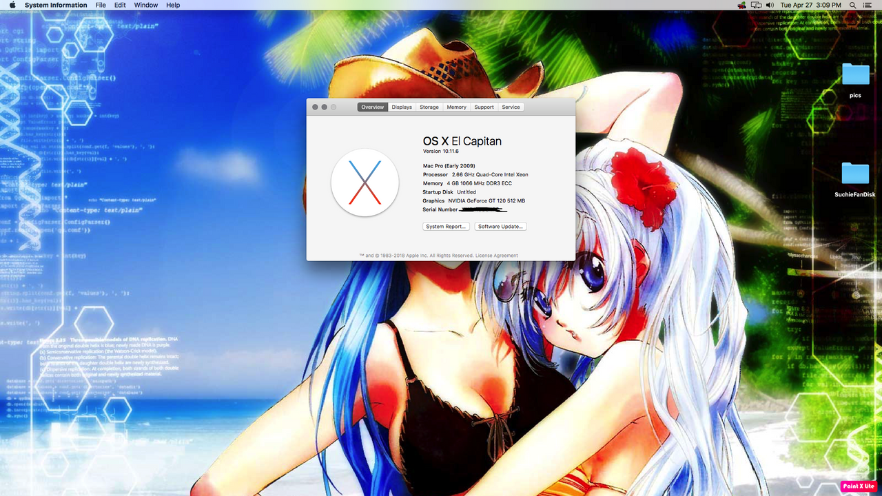

Here are the specs. I've left in this in storage for roughly four years. But now have it out and was wondering what I can or should do to make this mainly play games and final cut. Should I upgrade the memory? and other stuff. Also should I replace the battery that's in there? Also I want to use my gamer live portable with the software which won't run on anything higher than 10.13.
You want to replace the RAM for sure. Get 1333MHz DDR3 in case you ever replace the processor. You can go for 64GB (4×16GB) although 48GB (3×16GB) will run marginally faster. eBay is your friend here as new/unused DDR3 sticks are rare these days (but that may depend on which country you are in).

Your signature (and picture) indicate a MP4,1.
If the BootROM is untouched, first step should be to flash it to a MP5,1.
99% of the possible upgrades will only work with a MP5,1 BootROM.
After flashing it to MP5,1 , you can proceed as described by @14UG

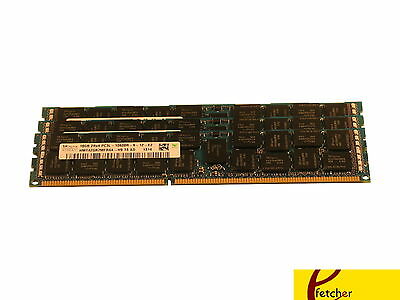

so the memory. I started looking I'm confused with this memory type. I am use to the older ones. So am I using server memory in the Mac Pro? I was looking at this https://www.ebay.com/itm/123738963027?hash=item1ccf6abc53:g:k-MAAOSweaFct6OW not sure if that is correct or what.
The RAM type for MP 4,1/5,1 is server type , yes.
But looking at your link I noticed that:
- prices are high in the US
- 4x4GB is a waste of money buying it , even for 25,-
- the RAM freq is 1066MHz , i'd recommend 1333MHZ so after upgrading the CPU to Westmere 6-core ,it will run at 1333MHz
- triple channel is the fastest RAM setup so I'd buy 3X8GB minimum or 3x16GB (unless you really need 64GB)
searching on eBay " ram 1333MHz mac pro" :

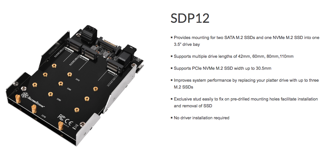

SSD: SLOT 2.. Highpoint RR2740 SAS/SATA/NVME HBA (PCIe 2.0 x16)
SSD: SLOT 1.. Highpoint SSD7101 NVME HBA (PCIe 3.0 x16)
Gives you the ability to install up to 8 SATA III SSDs [m2 form factor] AND 8 PCIe NVMe SSDs [m2 form factor] concurrently.
Also buy 4 SILVERSTONE SPD12 brackets (pic below). Install them in BAYS 1-4 and make new disk connections with Highpoint RR2740 as money permits.
