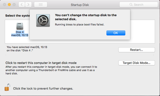

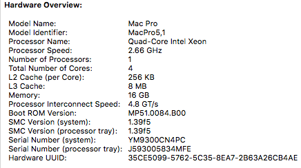

I have a MacPro 4,1 (early 2009) firmware upgraded to 5,1 HDD only, no SSD. I was able to clone my boot drive using 'Superduper!' so I have 2 identical boot drives. I then converted cloned drive to APFS but it will not boot. I get the following error:
