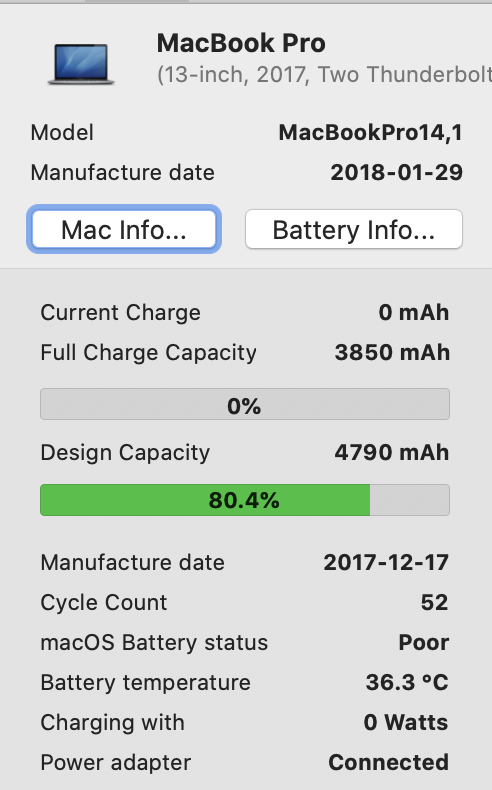

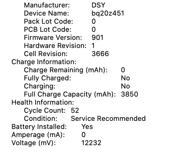

My first post here. My MBP (2017 version no touch bar) was purchased in 2018. I have been a gentle user, left my MBP plugged in most of the time, and let it drain a few times each month. Since last year, there have been occasional loud popping sounds from the back of the laptop a few times each day. I have heard about MacBook's swollen battery problem but because my battery health was shown as "normal", these sounds didn't bother me too much.
It has only 52 cycles so far but suddenly stopped charging last week. I have to leave it plugged in all the time. To be honest, I have been very disappointed at Apple's products. I have purchased many Apple products in the past. I even have the first- and second-generation iPods, an early version of Macbook (white), and many other products. But this MBP has had both software and hardware issues. I live far from an Apple store, so haven't really taken advantage of the warranty when it was still in it. 🙁
Please see the screenshots. I don't have Apple Care and it has passed the one year warranty. My credit card offers an extended warranty but it has passed the extended period too.
I took it to an authorized apple repair service today. After running a bunch of diagnostic tests, I was told the battery needs a replacement. It would be $199 (battery) + $40 (labor). I took it back without replacing the battery.
I called up Apple to see whether they may waive these charges for me as the authorized apple repair service center manager told me this issue is likely due to a manufacturing issue, not normal wear and tear. Unfortunately, Apple refused to waive the charges.
1. If I take the MBP to an apple store (genius bar), will they be able to waive the charges for a battery replacement? If not, will there be a labor fee of $40?​
2. Any other ways to get a cheaper battery replacement?​
Thanks a lot! Be safe and take care.

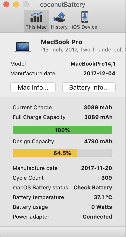

I have almost the same issue with the same mode... 🙁
Popping sounds started after exactly the 1 year warranty expired. Very loud sounds and many times a day.
I called Apple and they recommended going to a service to check what's happening. Went to an authorized reseller and service and they didn't even check the laptop because they said they have the exact same issue on their devices.
They said it's because of the display hinges and there's nothing to do.
After just 1-2 months I started seeing quick battery drain and occasionally the "service battery" message showed.
Called the service again and they said it needs a replacement. Didn't replace it...
How can this happen in just a little over 1 year? Very disappointed by Apple 🙁
