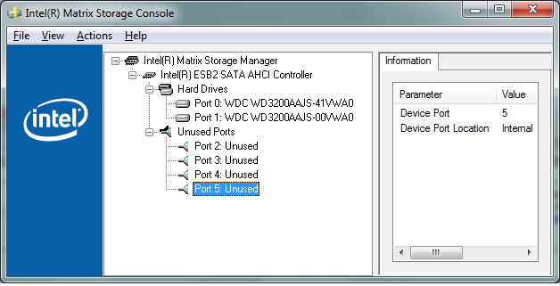

Could you post a pic of the Windows device manager and the Intel matrix storage manager of the 2008 machine in AHCI?
That's a looong install to get a screenshot. I'll kick off the install tomorrow and post the pic.

And this is the respective installation on a 2009 MP. The storage manager shows the SATA BRD in ODD-SATA port 0 and the Win SSD in ODD-SATA port 1. It is exactly the same Win7-64 cloned with Winclone to the MP4,1. So there is no doubt that win7-64 works exactly like Vista and XP on the MP 4,1. I'm still puzzled why this should not work on a MP3,1.
