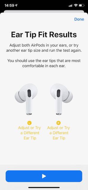

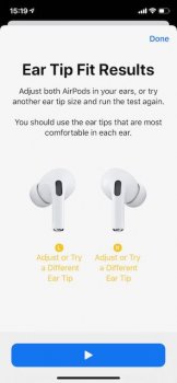

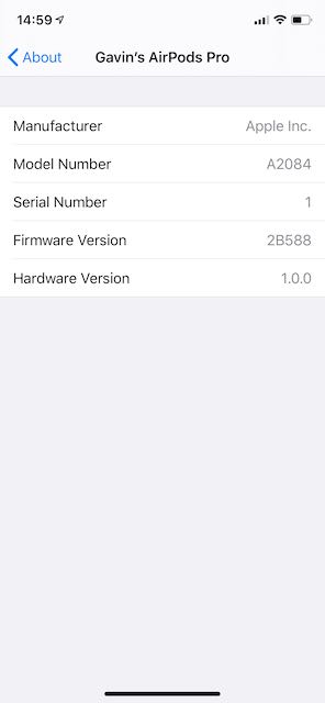

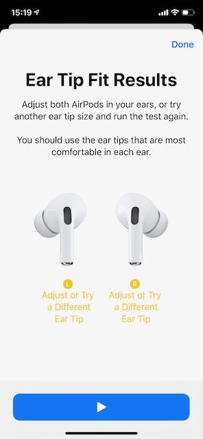

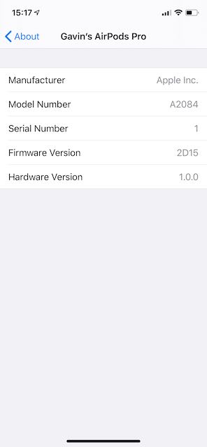

Before and after the update to 2D15...

There is no firmware update that will make the Ear Tip Fit Test pass once it has started failing. It's caused either by dirty vent grilles, or failing components. But it's usually dirty grilles 95% of the time.
EDIT:Slight correction to this...Apple could always release a firmware that just tells the fit test to pass no matter what...but that's not really fair lol
So does the new firmware improve bass response when the fit test fails? That’s all I want. Agree it won’t change the physics of the vents blocking which is bad design but at least they can make it so the sound doesn’t change when it fails. Will check it out myself once mine update too.
Some of the sound change is also due to the vent blocking. Mine sound noticeably bassier after a good cleaning with BluTak. Clean enough to get fit test to pass, and you'll also notice better sound again.
Oh yes I noticed that too. I have blue tack I ordered and use just for this purpose. Gave up after replacing them 3 times. I just assumed it was software that was changing the sound based on the active eq and not the vents being physically blocked but maybe you’re right. If so that’s even worse.
