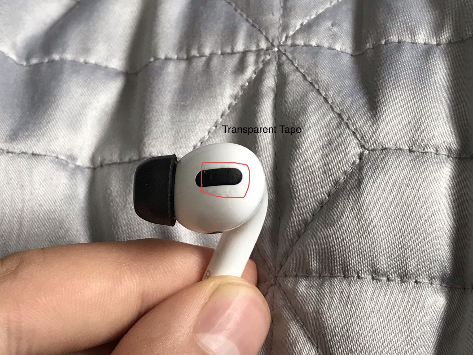

After replacing my airpods pro 3 times now, I’d like to offer a solution that has seemed to stopped the problem happening for me once and for all, for anyone still experiencing the issue.
What I have done is a fairly simple fix. As the root of the issue is the inward vents being blocked up inevitably within a matter of days before needing to ‘suck’ on them again to restore performance, I have simply attached small pieces of transparent tape to both airpod pros where the vents are.
This has not affected the performance in anyway, ear detection still functions normally, and best of all it seems it has stopped the vents being blocked and therefore the issue doesn’t return. Finally I can enjoy my airpod pros without needing to worry about replacing them every week.
I hope this helps anyone experiencing this issue. Seems like there really is a design flaw with these, but as long as I can correct the design flaw the airpod pros are excellent headphones.
