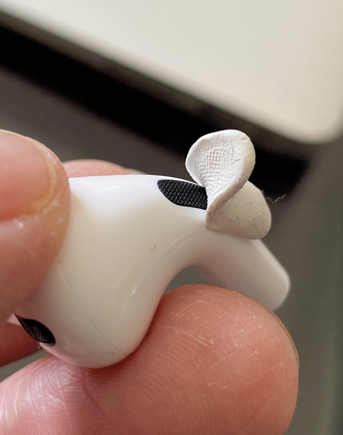

I used a small pice of adhesive (se link) to suck the plastic bits out. What a relief no more rattling. This rattling issue was driving me crazy!

Rattle in my left AirPod Pro has been resolved.

I also did the blu-tac fix for my first pair. but because of this issue I ordered a microscope and on the one I fixed the rattle there were tiny bits of blu-tac in a few of the holes of the mic. It's probably better to just get a replacement from Apple unless you really can't right now.
It's good to know that if it ends up being outside the warranty period and apple aren't fixing the problem than we do have a home brew fix. But I'm sure the more holes that become stuck with blutac over the years, the worst the ANC performance will get.
Using blutac definitely made no difference for my second pair that failed. When I first got in touch with Apple the support rep I spoke to recommended against trying many of the home remedies posted here. This is why I posted in the original post:
There have been some reports of sucking on the APP earbuds, wiping down the grills with cleaner, or using blutac to remove wax/dust helping, but please don't try these. You'll likely damage the APP further, and potentially violate the warranty allowing Apple to refuse replacement.
