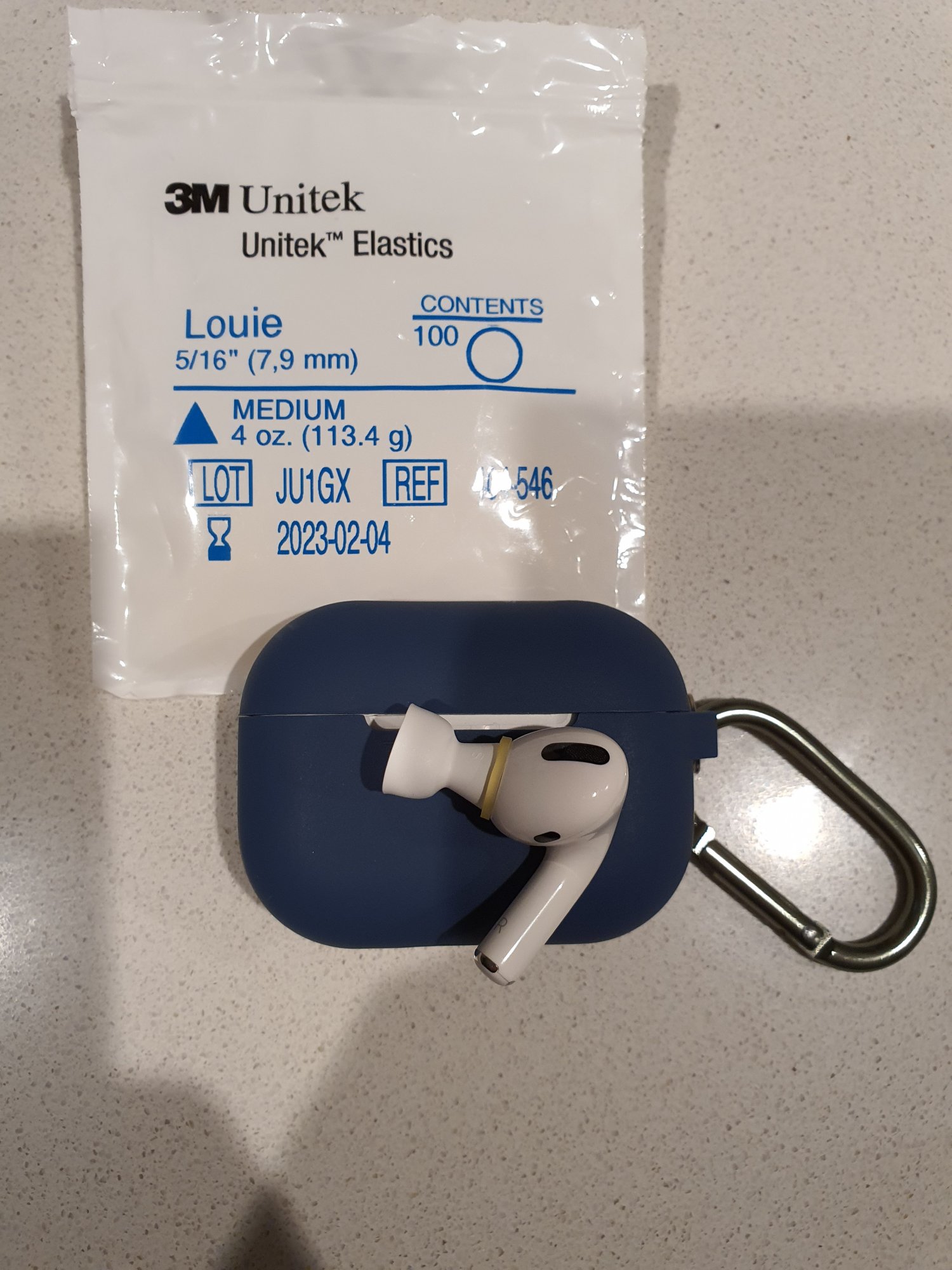

I have the rattling issue while walking, tapping and just moving my ear. I was so frustrated when officeworks here in Australia said they fixed it but did not because it's still the same airpods(waited for a whole week).
Anyway I was able to fix mine by putting a rubber on the silicone tip end where it locks to the airpod. Seems something is wearing prematurely and eventually will loosen up and the mic will pick it up. You can give it a go and hopefully will make yours useable too.

Just to be clear, a mechanical rattle that can be fixed with a trick like this is not the source of the "rattle" that most people are experiencing here (which is more of a speaker/sound distortion than an actual loose-parts-rattle sound)

Although the in-ear mic definitely does seem to react to this. I had a similar experience with my second APP set: one of the tips already on the bud was not properly seated when they arrived. So when I first put them in my ears I thought my replacement set had the same rattle issue right out of the box, the APP was definitely amplifying it in a similar fashion to the rattle we're experiencing. But properly clicking the tip into place solved it.
I'd speculate this is why Apple are asking folks whether they still get the rattle noise without the tips: probably trying to diagnose poorly seated tips vs the hardware fault before arranging a replacement.
