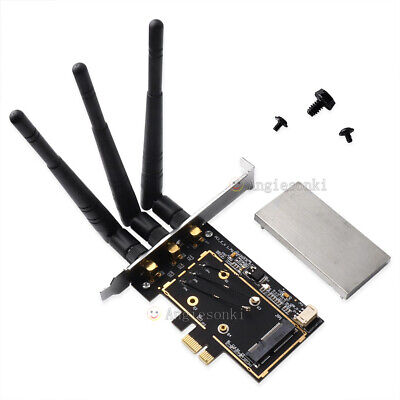

Wouldn't the easiest and cheapest way be a PCIe to miniPCIe adapter with antennas and a BCM94322MC card?
Reviving this old thread. This sounds intriguing! The BCM94322MC is a standalone 802.11a/b/g/n card. Can someone confirm if there are drivers for this card under Tiger/Leopard? Also, we would need to find a compatible PCIe card with 2 antenna connectors to connect the 2x2 MIMO configuration.

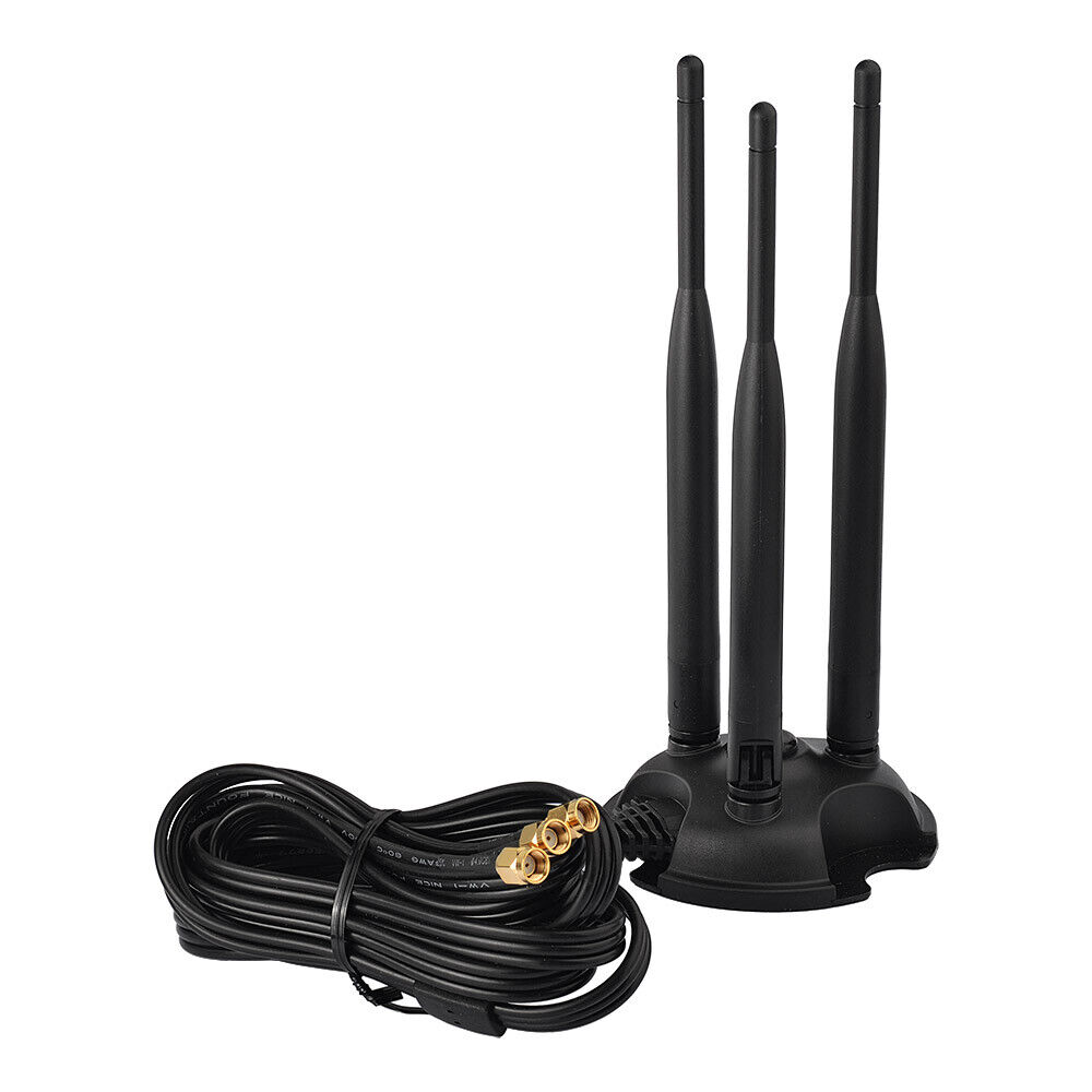

When I did mine, you could get carrier cards with three aerial connectors quite easily. I also got an impressive external tri-cable aerial with 1-2m of cabling to plug into. Something like these pics.
View attachment 2480977View attachment 2480978
