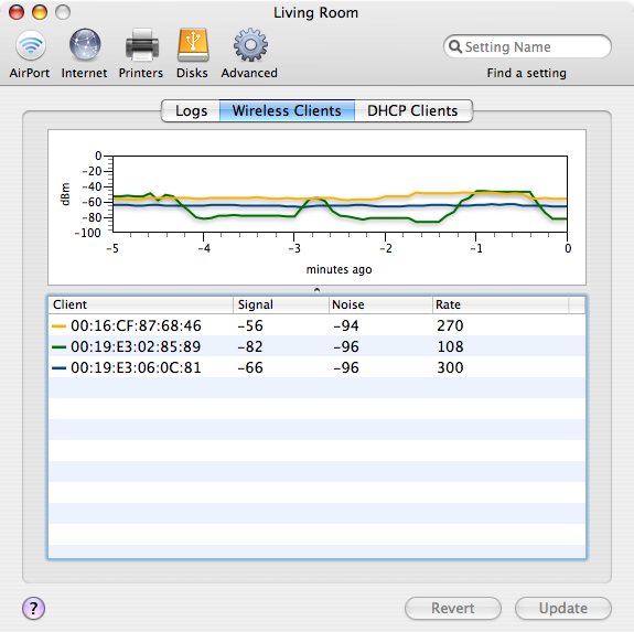

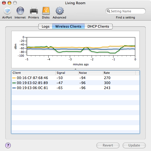

This isn't quite what you're asking him for, but for what it's worth, here's two shots of the AirPort Utility showing my connect speeds.
On the shots below, my MBP is the green line. As you can see from the signal, I was walking all around my house (inside and out).
The first shot is when I was inside, sitting on the couch, about 10 feet from the new Airport Extreme. It shows my MBP connected at 300 Mb.
The second shot is when I was outside the back of my house, about 150 feet from the AE. It shows my MBP connected at 108 Mb. I didn't snag it in that shot, but I had four signal bars out there too. :)
I ended up setting up a dual-band network (with my 802.11g devices on a separate 2.4ghz network than my 802.11n-only 5ghz network). Works great, and now all of the 802.11n laptops connect at 300 Mb.

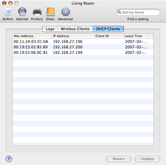

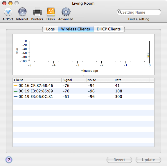

I am very disappointed in the monitoring capabilities of the new Airport Utility. I can't compare it to any previous versions, since I didn't use them. But this utility is all about configuration, with almost no visibility into operational data. Unless I'm missing something, but I've looked carefully. PM me, and I'll describe the one monitoring screen that I have found.
Well, for what it's worth, there was pretty much no monitoring capabilities in the previous version. You couldn't even see what DHCP clients were using addresses. That's crazy!
With the new one, I can see pretty much everything I'd want to know about every unit connected to the base station.
What's missing that's disappointing? :confused:
