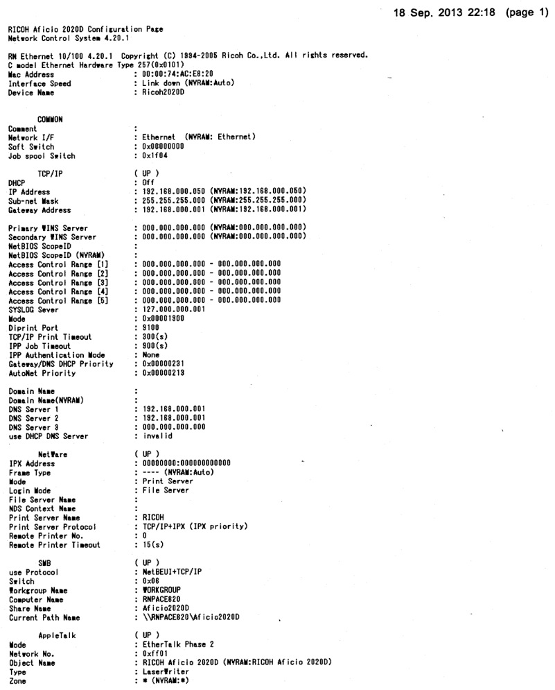

I have three Airport Extremes (all in Bridge Mode) connecting (via DHCP) to Netgear Router that is providing DHCP starting with 192.168.0.1. I have my Ricoh 2020D MFP plugged into the ethernet port of the last AE that is extending the network to the back of the house. I have always been told by Ricoh technicians to set the manual IP (currently 192.168.0.50 which is reserved by the router). The subnet mask to be 255.255.255.0 (same as my router). I set the default gateway as 192.168.0.1.. all settings were working fine when the MFP was connected to the first AE that was ethernet wired to the router. Problem is only now that I have moved the MFP and ethernet connected it to extended network AE.
I am unable to ping or print to 192.168.0.50 (the Ricoh 2020D printer).
Have retried usual Add Printer setup which is: Add > IP > LDP > 192.168.0.50 (currently just hangs not seeing the printer). Normally the printer name appears and the correct driver is shown at the bottom as Use: Ricoh 2020D Driver.
Thanks for any help. Have been without printer & scan to email function for a couple of days now.

I have three Airport Extremes (all in Bridge Mode) connecting (via DHCP) to Netgear Router that is providing DHCP starting with 192.168.0.1. I have my Ricoh 2020D MFP plugged into the ethernet port of the last AE that is extending the network to the back of the house. I have always been told by Ricoh technicians to set the manual IP (currently 192.168.1.50 which is reserved by the router). The subnet mask to be 255.255.255.0 (same as my router). I set the default gateway as 192.168.0.1.. all settings were working fine when the MFP was connected to the first AE that was ethernet wired to the router. Problem is only now that I have moved the MFP and ethernet connected it to extended network AE.
I am unable to ping or print to 192.168.1.50 (the Ricoh 2020D printer).
192.168.0.xxx and 192.168.1.xxx are in different networks. Unless you have configured something to route between the two networks nothing in one will be able to see the other...
