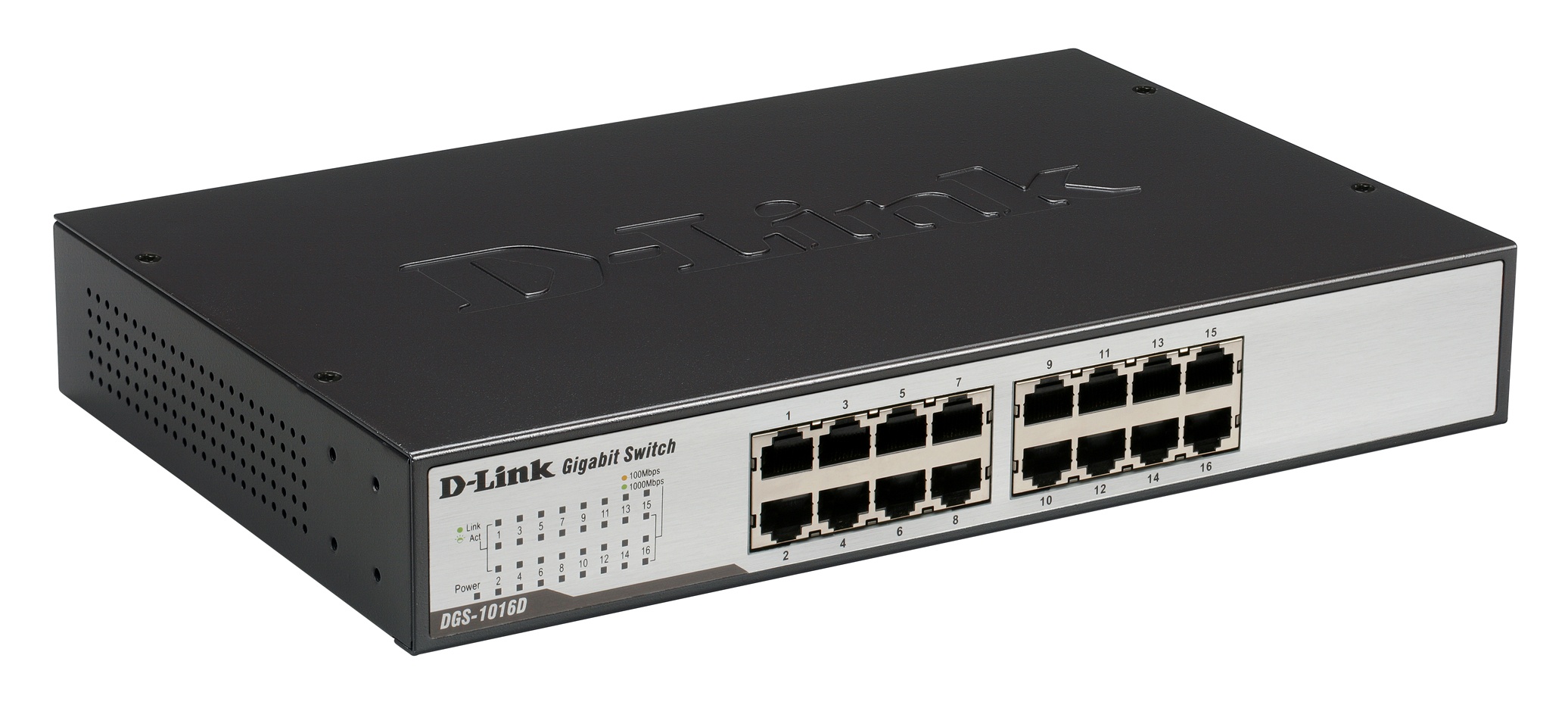

I need this second router because i have 8 MACs for video editing. I buy today a D-Link Gigabit Switch DGS-1016D to remove this second router =D

I need this second router because i have 8 MACs for video editing. I buy today a D-Link Gigabit Switch DGS-1016D to remove this second router =D Image

OK, then. If the AE is connected by Ethernet to your new switch then everything should be working OK. I had one of these switches and the initial config can be tricky.
