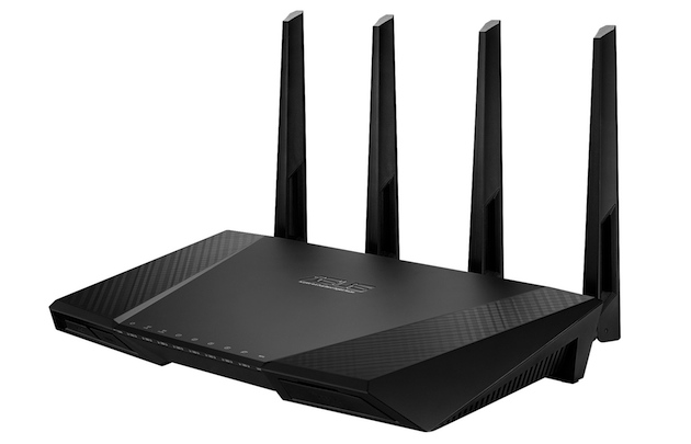

Netgear Nighthawk AC1900, Nighthawk X4, Nighthawk X6
Asus AC87U, AC68U
Both are much better than the airport extreme in terms of speed (~500mbps on the above routers vs 293mbps on the airport extreme), stability and features.

"These speeds make the Extreme the slowest wireless AC router we have tested at 2m. It improves dramatically by holding its speed at distance, but it still trails every wireless AC router we've tested this year"
