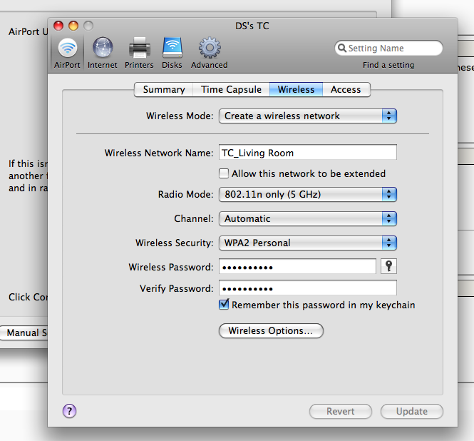

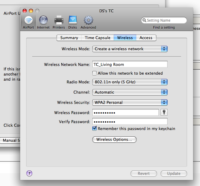

do you get or see this screen?

No I do not (on my airport utility in windows or my macbook pro) Thats weird
Do you know how to get your options? I'm using airport ver 5.4.2
And airport extreme 7.4.2

what country are you in? I know that there are some band restrictions for some countries, people use the different country profiles to access these

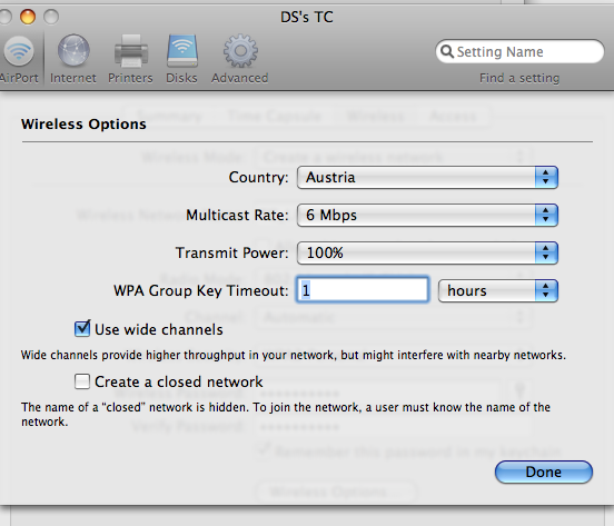

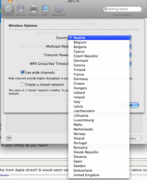

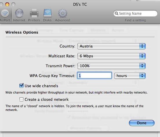

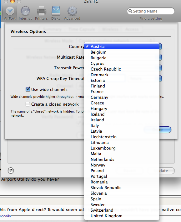

ok so its pretty straight forward, airport utility, wireless, wireless options and you can select country. I have Austria selected for some reason, I presume it's for the very reason I was talking about earlier 🙂
let me know how it goes and maybe just copy my settings and see if they work??

Thanks for your hard work, I went to the options but for some reason I do not have Austria as a country to select. I have Brazil, Venezuela, Canada, Columbia, Puerto Rico and Peru
I've selected each and nothing changed in my radio options
What version Airport Utility do you have?
did you buy this from Apple direct? It would seem odd to me that you wouldn't have your native country on the list,

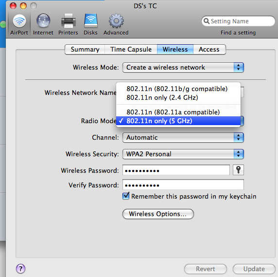

as you can see I clearly have a European model, you would see to have a South American one, also I believe that this cannot be changed

yeah i bought the Airport Extreme from the Apple Store. And I do have my native country as an option Im in the United States it does have that option which I was using (sorry I didnt list it earlier)
But for some reason my options arent wireless n only band
sorry for the confusion there 🙂
ok so I think that because you are in bridge mode the AE is using the settings from the router and limiting your options.
I would recommend that you do a full reset and inside of going to set it up in bridge mode try and simply add it to your network as an access point and see what your options are
does that make sense? I know it's a pain but it's (sadly) an easy step that has happened in your installation and means youre now restricted

Just to update....I called Apple Tech Support
and he stated to me that the New Airport Extreme (simultaneous Dual-Band) cannot be set to wireless n only on the 2.4 band b/c all n devices auto connect to the 5ghz band anyways
I dont know if he was right I thought that n devices could use the 5 ghz band ONLY if it was a device that can specifically access the 5ghz band (for instance the newer macbook pro)
But the Apple tech guy said that ALL 802.11N devices can access the 5ghz band
