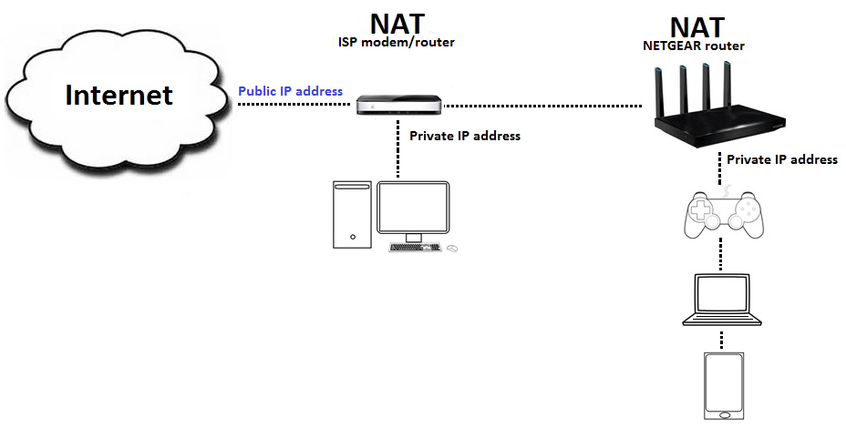

No its not risky, the disadvantage of the AirPort Extreme is not its security, but that it's not the fastest all in one router, that's all. It does have decent range. Where speed and what you use becomes a factor is with higher ISP Mbps connectivity to your WiFi router. By that I mean you have a 200+ Mbps connection when connected using ethernet versus a Wifi Router that you see only 50 to 100 Mbps when wandering around your house on your computer/table/phone using WiFi.
see Verizon FiOS Router and Security Issues - Verizon has had a few major security issues they needed to release updates or patches for. If you using a ISP provided WiFi router that does everything, then its only one wall to scale for to access your devices on the router's price IP address connected devices. The below diagram shows how much easier it is to circumvent one all-in one modem/router/wifi security versus a second router with WiFi
Double Nat allows you to use just about anything for your second router or mesh setup, its what you been using all this time. It also means that your second router connected devices are behind a another range of private IP addresses. Most people use this configuration, like you are doing now with your setup.
