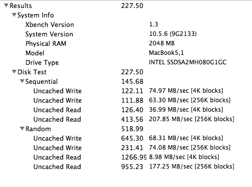

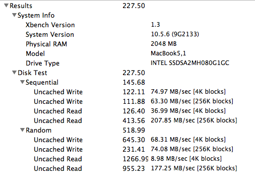

My 2.4 alu MB arrived today. Here's my xbench on a fresh install.
