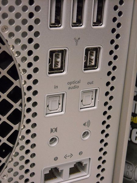

Don't mean to state the obvious, but you where using the usb on the rear (not the charging points on the front).
