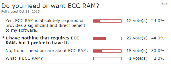

  2. The majority of people here prefer to have ECC, even those who explicitly state it's not a fundamental requirement:

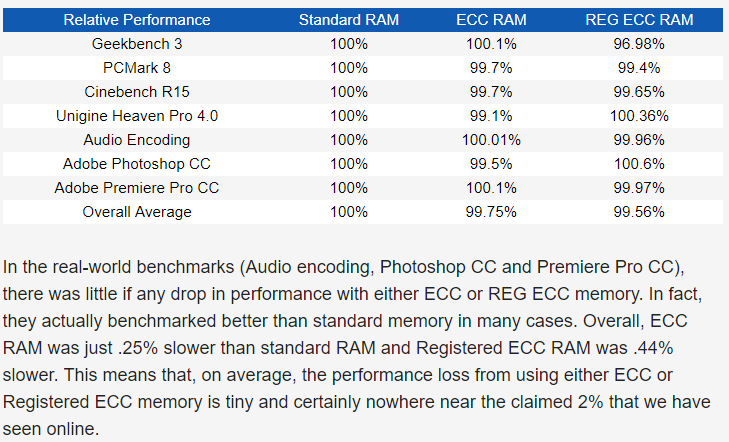

First of all, supporting ECC does not mean ECC is required. In your scenario of wanting to buy a large amount of RAM and save money feel free to replace it with non-ECC RAM. The fact that ECC RAM is supported shouldn't stop you from choosing non-ECC RAM.
Secondly, gamers who are serious enough to care about a 2% performance difference shouldn't be using a Mac Pro. If they were forced to because that's their one computer and they need it for work too, then there are many other things working against them that will dwarf that 2%.
Third, for a 2% loss to equal 10FPS loss, you'd have to be getting 500FPS. That doesn't sound like a problem to me.
Fourth, I don't accept that 2% number anyway. I know that's the common claim floating about, but here are a slew of benchmarks that show otherwise:
These numbers are so close that they might as well be testing variations. And note in some cases the ECC actually benches faster.
So given that there is no real performance hit and anyone who wants non-ECC can just go ahead and buy it, there's just not a problem here.

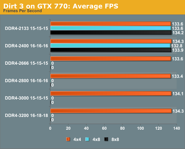

Fair enough. I can't find any gaming benchmarks comparing non-ECC and ECC RAM, which in itself is telling. Gaming on a workstation is just an afterthought.
So the closest I can find is this AnandTech article. It's not comparing ECC vs non-ECC, but it is comparing the effects of RAM speed (both throughput and latency) on gaming.
For those who don't want to click through and read, the results are basically that there is little to no difference in gaming performance, even with some pretty dramatic differences in RAM speed. Here is one example:
I'm not much of a gamer, but from what little I've seen, it generally seems like the GPU is by far the biggest determining factor, with CPU as a distant second place. RAM speed differences don't seem to amount to anything.
Basically I think if you want cheap RAM you should buy ECC server pulls. If you want faster RAM it doesn't really matter ECC or not.

ActionableMango showed you real world benchmarks that show essentially no difference between real world applications on different memory types.
real benchmarks of games are definitely needed, that's what everyone is questioning the most, how big is the fps hit? if these app benchmarks are demonstrating heavily optimized cache hits, it may not be the case for a game which needs to load tons of assets in and out of memory. anything that doesn't fit into the texture memory of the graphics card loads from system memory or disk for example.
which brings us to another point: if ecc is so great and doesn't affect the speed in any appreciable way, why isn't the GPU using it? hmm!
also, why would it be considered OK to render frames using non-ecc ram on my GPU, but you guys consider it dangerous to render frames with the non-ecc system-wide memory? explain to me how it's not the exact same thing.
can you send a link to who said that there was a "2% ecc penalty with 10fps"? That seems to be your invention.
the benchmarks ActionableMango showed come from puget systems here:
https://www.pugetsystems.com/labs/articles/ECC-and-REG-ECC-Memory-Performance-560/
on that page, you will also find:
Crucial has a statement on their knowledge base that ECC memory will decrease your computer's performance by about 2% compared to standard memory.
so that's not my invention, its stated as a fact by at least one manufacturer, and it's referenced in many places on the net. puget systems didn't see a 2% penalty in that specific battery of tests. but it's possible they did the tests wrong because they have suspicious results with registered ecc being faster than non-ecc. and registered ecc has an extra step involved that standard ecc does not have. furthermore, this test was of ddr3 not ddr4 ram, it's not even the right type of memory module. tests from anandtech and toms hardware would be more reliable if any exist.
a 10 fps hit in games was my own ballpark estimate of what you may see with ecc ram. this is what you guys seem to disagree with the most.
ActionableMango combined two separate data points and came up with a formula to link them together:
2% of 500fps = 10fps
his suggestion is that a 10fps hit means we are getting 500fps. but that formula is not correct at all. you cannot just take some numbers and create a linear equation out of it and expect it to make sense.
