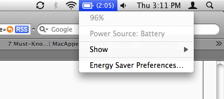

The pictures explain it all

I get around 4 hours +... again, depending on what features im using i.e. bluetooth and wireless (eat up a lot of battery).
Mines is all good.
The display is not exactly accurate. I get a 5 hour reading on my Macbook Pro as well but it only last around 3 hours when I actually let the battery run down. I suggest you try to run your battery down and time it.

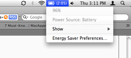

i had been using macbook aluminum 2.4 for about 2 weeks now...i havent quite really time the battery life at first but recently i realize that my battery is giving me less n less time... right after fully charged, unplug the power cable, n it says 2:23 hrs time left...just running 1 x safari, 1 x firefox, YM n msn...and that's it...battery defect??

sorry...what's an OP??
screen brightness at 50%...does this really effect that much?? if in my case..i set it to 100% bright my batt will be 1 hrs??
OP stands for Original Poster. Shorthand for referring to the first post.
Anyhow your battery seems kinda low. I get a reading of about 5 hours, sometimes as high as 6.5 hours on a full charge from the battery meter. Whether that's accurate or not is up for debate but that's what OSX says.

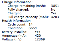

Go to your apple menu, select About This Mac / More Info / Power. Copy and paste your battery info like me here and I'll see if there's anything abnormal. Don't paste your serial number of the battery, just paste the same info like from my battery here:
Code:
  Charge Information:
  Charge remaining (mAh):	4124
  Fully charged:	Yes
  Charging:	No
  Full charge capacity (mAh):	4146
  Health Information:
  Cycle count:	49
  Condition:	Good
  Battery Installed:	Yes
  Amperage (mA):	0
  Voltage (mV):	12521
As attached...i'm going to mac service soon..
Your battery looks normal and healthy from those numbers. That means your low battery life is just due to programs running that are sucking out approximately 2.6 times more power than compared with my Macbook, according to my rough calculations.
The amperage number is the important number for you. With Safari and System Profiler running on this web page my amperage is at about -650 mA which OSX reports correctly as 6.2 hours of battery life.
Yours would be around -1690 mA to give only 2.4 hours. Load up Activity Monitor, look for programs that have a CPU usage number above zero, and start shutting those down. As you shut things down your amperage would start getting closer to -650 mA. The closer you get to that number the closer you'll get to 6 hours of battery life like my machine.
It'll involve a bit of work on your end but you'll end up with much better battery life as a result. As you shut stuff down you need to go through the whole About This Mac / More Info / Power thing to get an updated amperage number. You can't just leave the window open as it doesn't update itself.
The reason your amperage number is positive in your screenshot is because it's plugged in and charging. Make sure to pull out the plug when you try this and the numbers will go negative.
This is the same type of stuff the Apple genius is going to do when you bring in your machine in the back of the store. Do it yourself and you could save yourself a trip.
