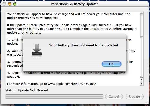

When i ran it, this comes up... 😕

Yes, I did... I thought it had to flash the firmware afterwards though (like Bluetooth updates).

Actually my friend told me it's unnecessary. His battery was at 64% before the update, and was at 82% after he restarted. Clearly Apple simply installed the update, and the updater app at the same time. Everything is updated after you restart!
