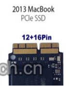

Apple SSDs are the only drives that use this weird 12+16 pin configuration so any drive that has this configuration without the use of an adapter would be an Apple OEM drive.
