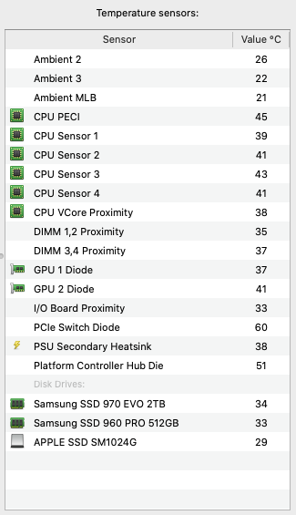

I'm looking at the sensor readings in the Macs Fan Control app and it shows idle temperatures in the upper 30s and low 40s C for my E5-1680 V2. It's about 22 C in the room. When I ran Geekbench it went into the upper 50s. If the E5-2667 V2 is getting that hot then it's consistent with my theory that it's too hot for the 6,1 based on Intel's data. You might want to then switch out to an E5-1680 V2. The performance between those is so close it's basically negligible.
Forgot to mention: so the CPU proximity sensor is also only showing some 45°C for me
idle (like right now, with ambient also almost exactly 22°). But I think I've never seen that
one in the 30s with this chip.
If I load all cores (Folding@Home or x264 with HD material), at factory fan settings
CPU proximity will go into the 60s, but if I set the fan to ~1750, it won't exceed the
low/mid 50s, and fan at full blast will push it down to like 48°C.
So looking only at the proximity temps I probably wouldn't worry, it's only that pesky
>100 die temp that's unnerving.

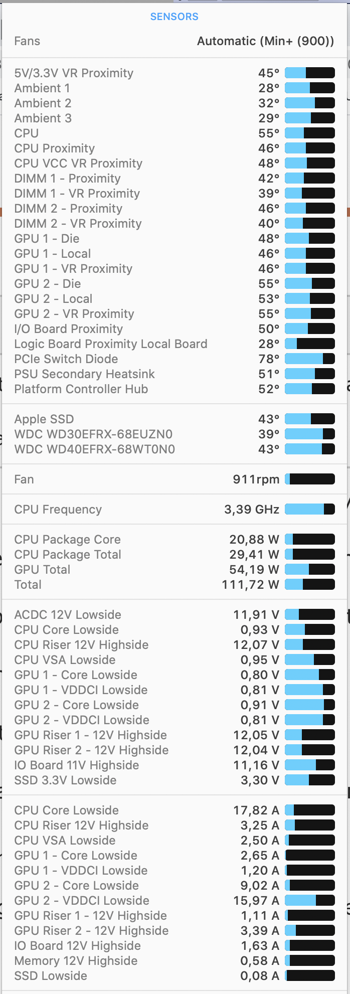

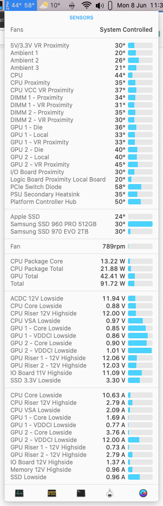

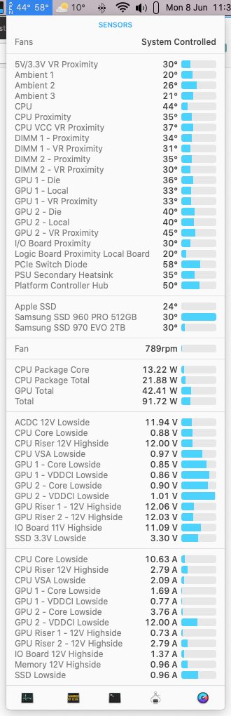

I just literally got done replacing the thermal paste. When I took the machine apart, the top fan was caked in dust and would have barely have flown much air. That probably didn't help at all. Gave it a good clean out and replaced the thermal paste with Gelid GC Extreme. I've only just booted the machine but the CPU is idle at ~45c. Proximity ~35c. A big improvement. I did notice I'd not used enough paste last time so I used a little more this time around. As testing has shown, too much isn't anywhere near as bad as not enough.
I'm measuring using iStat Menus which shows all the available sensors. The other one I keep an eye on is the PCIe Switch Diode as that gets pretty toasty and is known to many. I can give the Fanny (nice name haha) one a go later.
Ignore the 960 Pro bar. It's only just been fitted so iStat Menus doesn't know it's "max" yet.
I do also use Macs Fan Control to ramp up fan speed when the PCIe Switch Diode gets hot. That shows similar temps.
I'll give it some load later to see how it copes but so far so good.

So yeah, I'd be really interested in your readings with Fanny (remember, needs to be explicitly set to
die temperature, by default it shows an average of all sensors it knows about).
Ok so that's interesting. Here's how this looks for me, the machine has been woken up
for a few hours but running unattended and mostly idle until I sat down at it now.
What strikes me is that _all_ temps are around 10°C (call it 10 +/- 5) higher in my case, from IHS through proximity to ambient, and also the ones around other components. Also the notorious PCIe diode, which is a full 20° hotter than yours – in fact comparing this to your numbers right now makes me think if that might not be one of the sources of the higher temps overall.
Also weird: my CPU and total wattage is also higher, ~ 10W CPU and ~ 10W GPU, also weird... machine is provably not doing anything much, neither CPU (97% idle) nor GPU (99% idle).
So maybe I really should have another look at the thermal compound and reapply it. But I have to honestly say all of these numbers together don't look to me like I have a TIM issue but something else is going on... or am I delusional?
Edit – PS: The HDs are external in case it's not obvious, so ignore those.
I also have that although I don't have it running all the time (iStat Menus does all I need for now), but I can confirm the same picture as for the iStat numbers: ~ 10° hotter for the CPU Sensor 1 through 4 and the GPU diodes as well.
