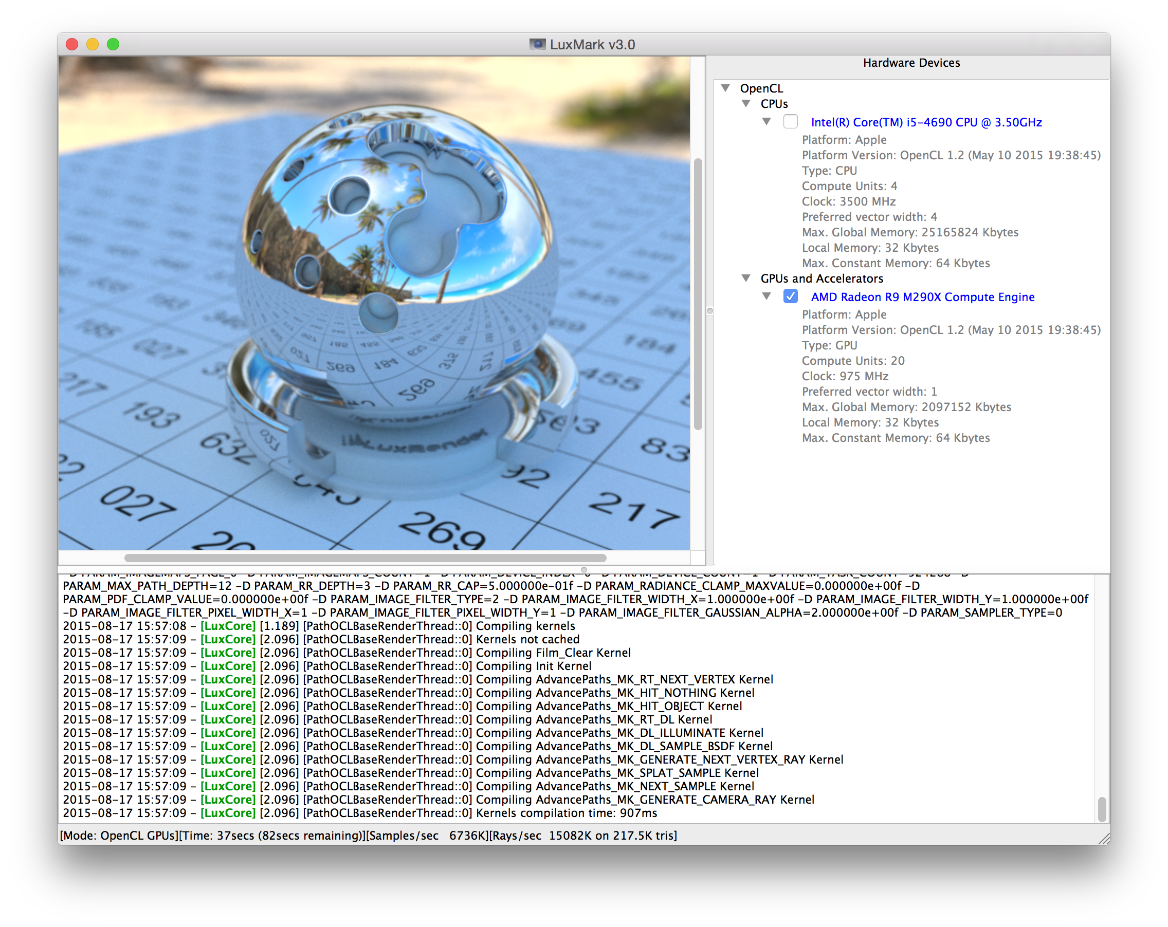

What you need to do to really compare the r9 series is to take note of how many compute units the card has. This is luxmark, an opencl benchmark.
This is LuxMark 3.0. I actually prefer LuxMark 2.0, it's a bit more stable.
Note the "Compute Units." The r9 m290x has 20 of them, and I believe the r9 m295x has 32.
How many does the r9 290 have? 14? 16?
For that matter, it should be easy to verify that the r9 m370x has 10.
Note also the clockspeed--975 Mhz. This also varies from card to card.
