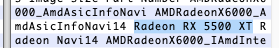

I figured out 10.15.1 build 19B2106 for the 16" MacBook Pro contains the Navi drivers for Navi 14 GPUs such as RX 5500 & 5500 XT, and of course the Pro 5300M and 5500M. So if you wanted to install an RX 5500 or 5500 XT into a cMP you could try transferring those drivers over from that build or try installing that build on your machine, or just wait for 10.15.2 which should contain those drivers in the standard build.

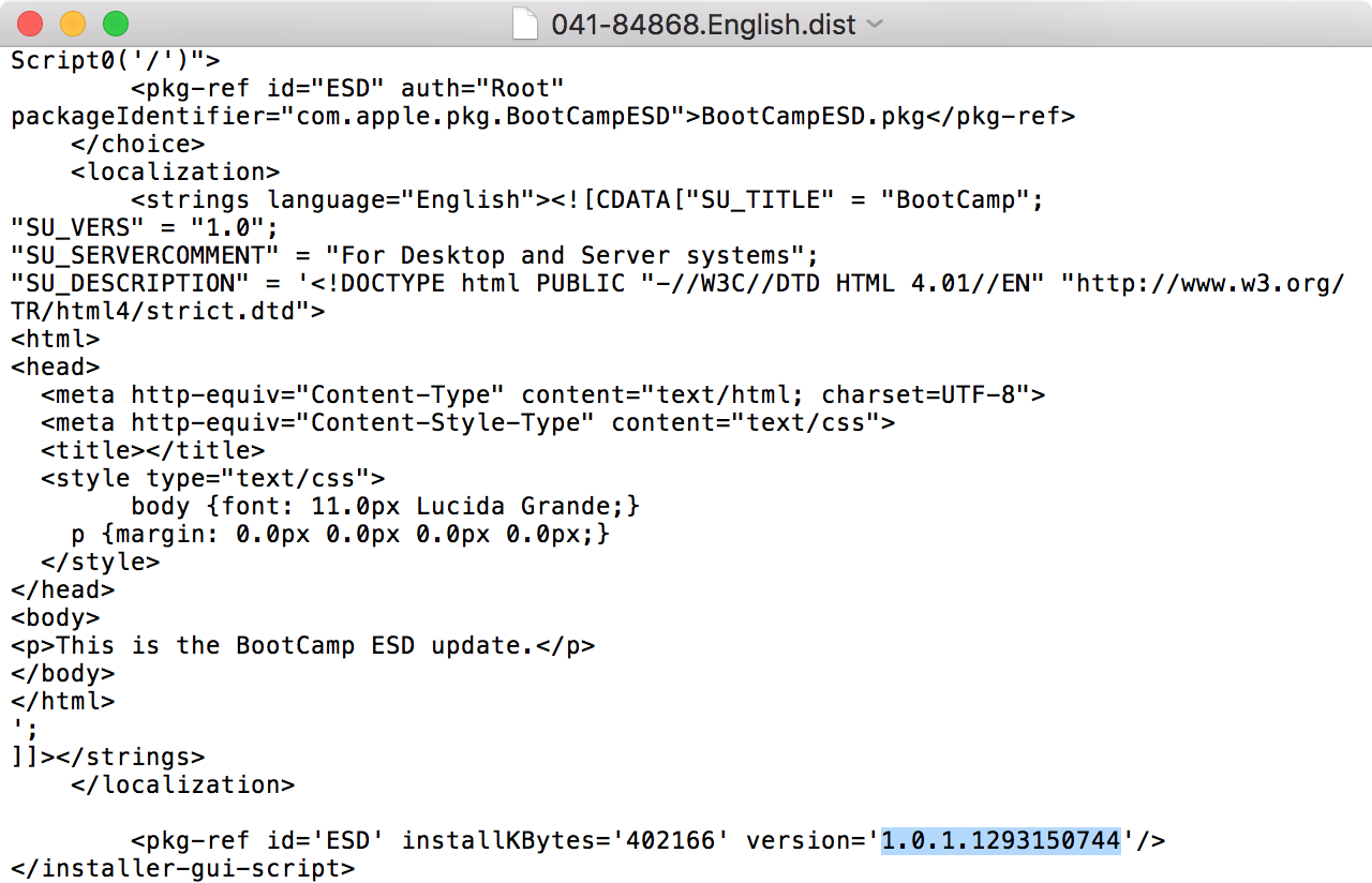

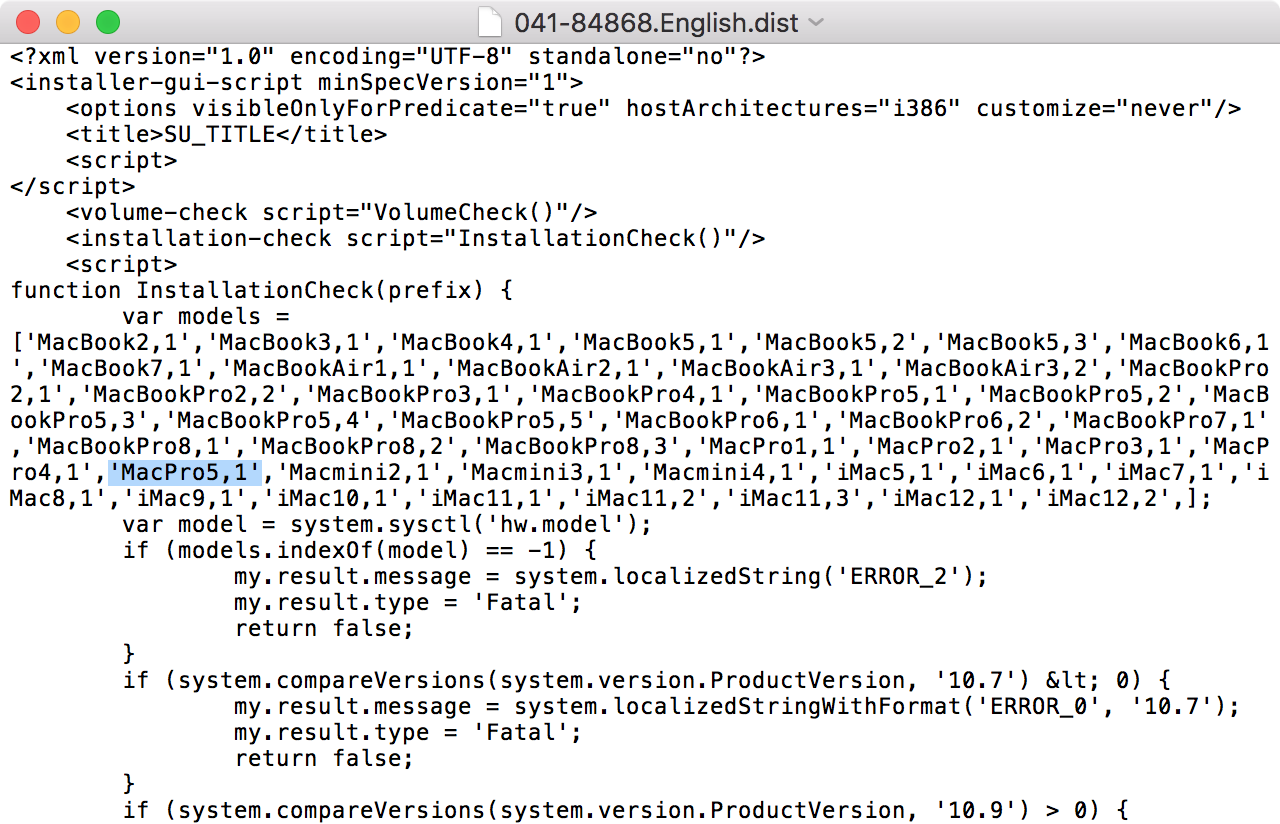

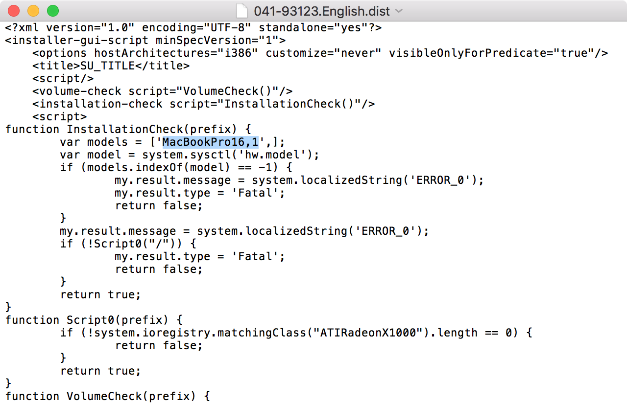

You are correct that Apple recently released a new BootCamp package, November 19 Product-ID 041-93123, but it's for MacBook Pro 16".
The MP5,1 BootCamp, Product-ID 041-84868, was reissued October 22 and it's not a new package. Apple didn't correct anything with this re-issue since the package was just re-signed with the new certificates, same 1.0.1.1293150744 version.
Screen Shot 2019-12-04 at 08.25.10.pngScreen Shot 2019-12-04 at 08.34.11.png
