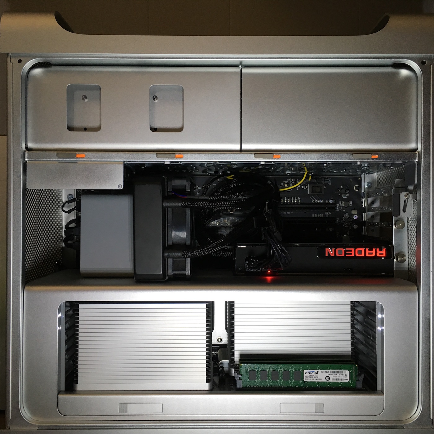

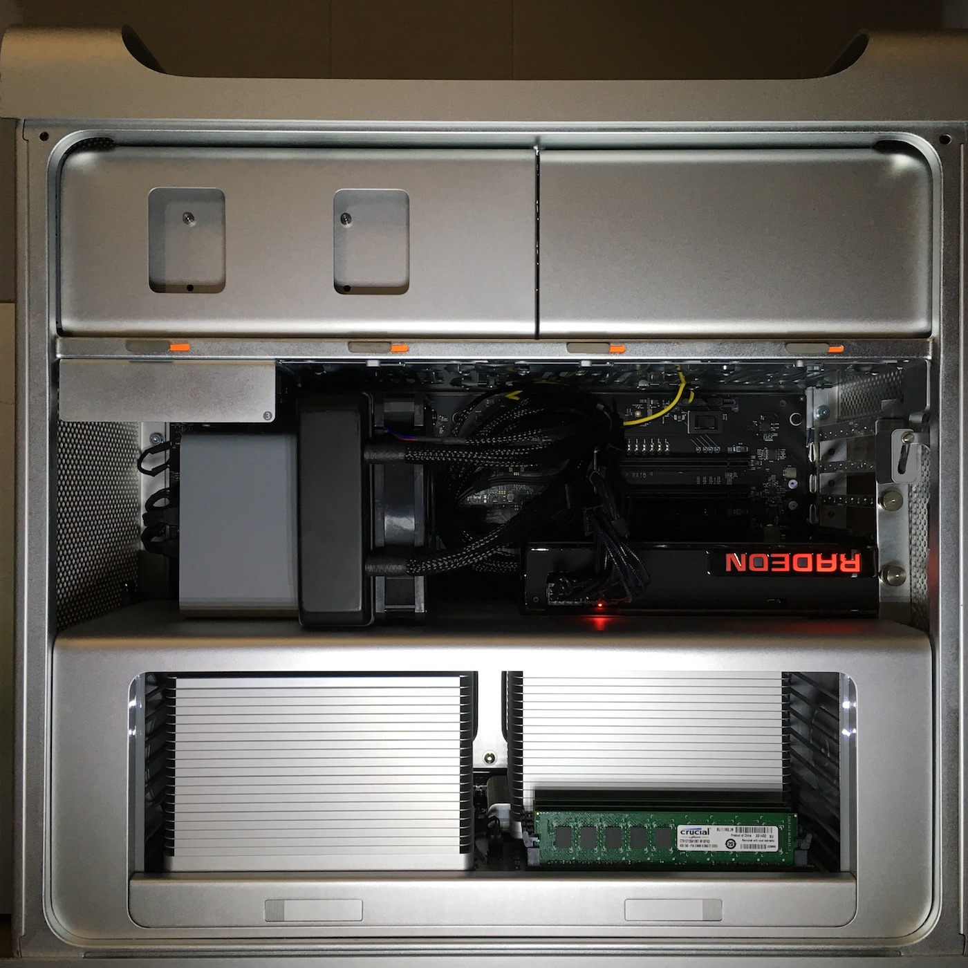

I've been busy with eGPU testings in the past few months and was not spending much time on the Mac Pro. Santa was very good to me with an R9 Fury X liquid cooling so I thought it's a perfect time to get back on the Mac Pro tower.
The Radeon R9 Fury X fits inside the Mac Pro tower like a glove. Power management was a bit of a challenge. I'd highly recommend the Pixlas mod to provide upto 400W this beast of a GPU may consume.
A big "Thank You!" to okrasit, Fl0r!an for discovering the CU unlock. These Fiji and Polaris GPUs are now running full speed in macOS. Goalque put together an automated script to enable this CU unlock for our convenience.

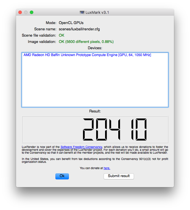

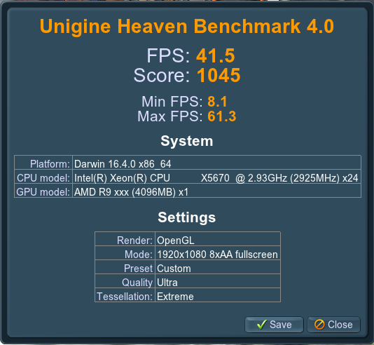

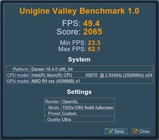

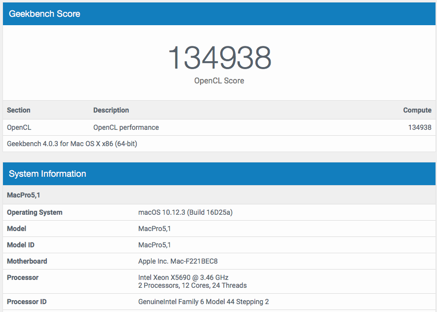

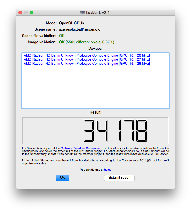

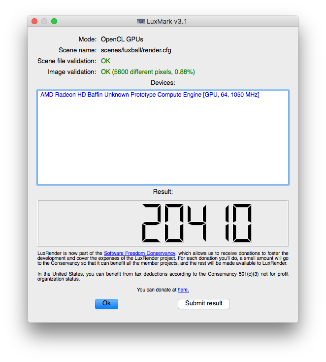

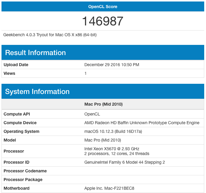

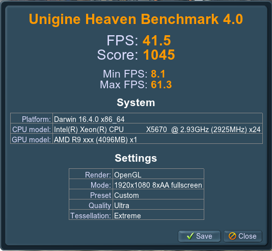

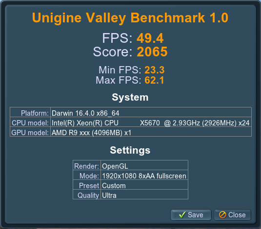

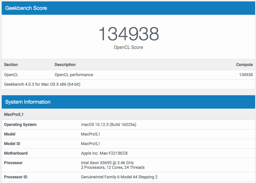

Here are some basic benchmarks I ran so far. This R9 Fury X is now an excellent value. You can find one on Newegg for about $300. The build quality is the best AMD GPU I've ever experienced. Get them while you can.
The Radeon R9 Fury X fits inside the Mac Pro tower like a glove. Power management was a bit of a challenge. I'd highly recommend the Pixels mod to supply upto 400W this beast of a GPU may consume.
View attachment 680766 View attachment 680764
View attachment 680742 View attachment 680744

Is that fan attached to the Fury X rad set to push or pull? I'm sure you already know, but I assumed it was push, which might be a problem for the Mac Pro fan pushing air in the other direction.

The attached fan is push. I will remove the main Mac Pro fan to get the cooling properly. It's very cold here in MN and the card runs absolutely quiet and cool.

I wouldn't do that. If the Mac Pro fan controller doesn't see a fan attached that's it's expecting to be present, all of the fans will ramp up to 100%. Can't you just unscrew the fan and turn it around to pull instead?

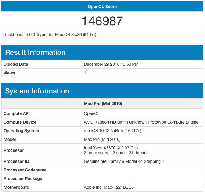

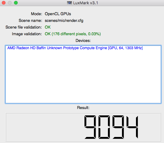

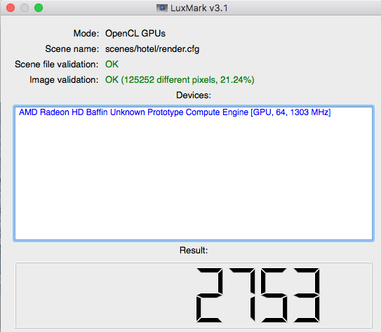

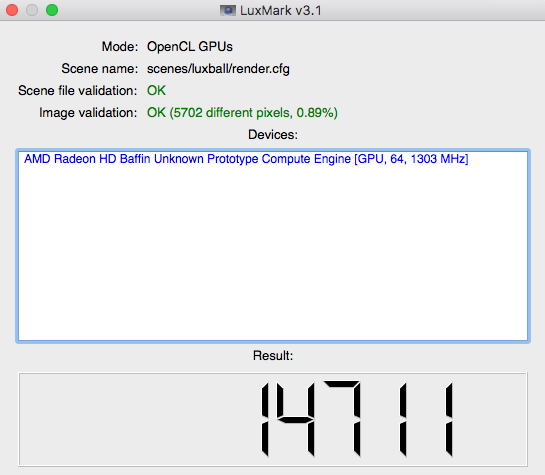

With no help from Apple, but lots of help from this and other forums, my little RX 480 is blooming nicely. More than anything, that annoying feeling that my new card was 'worse' than my old 280X can be put to rest. Suddenly this $220 investment seems quite reasonable. Low power consumption, pretty much silent for me and 8GB or memory.
With these new developments I'll drop a second one in there for FCPX and Resolve.

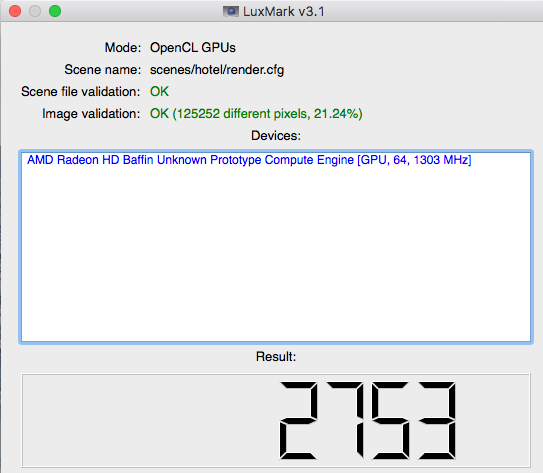

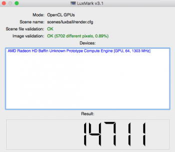

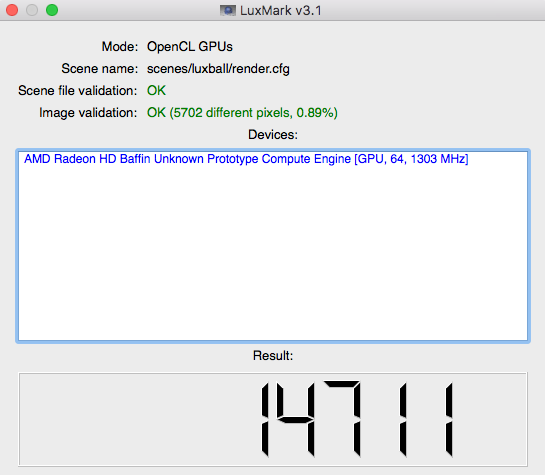

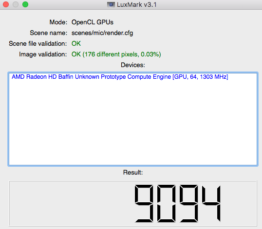

These Luxmark scores are improved by roughly the following numbers compared to the old ones I had with the exact same card:
Light scene: 26% better
Medium scene: 44% better
Heavy scene: 61% better (!)

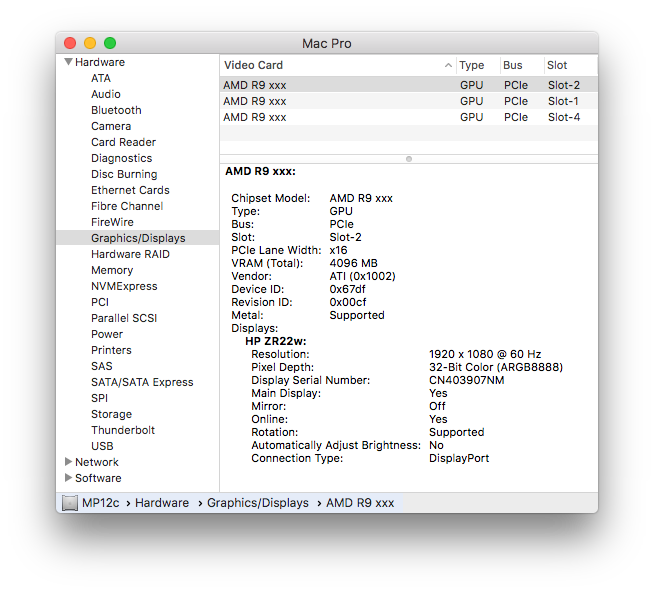

As theitsage has shown above, you can drop as many cards in there as you like, provided you have enough power.

Thanks for your response. What else does adding a MSI RX 480 8GB card require? Other cables? Other power supply? What drivers are you using for Sierra? Did you have to edit Kext? If yes can you please give me some advice here?
p.s. Greetings from Basel 🙂
Hi there =)
It takes an 8-pin connector. If you're only using one card you can combine the two 6-pins from the motherboard into one 8-pin to distribute the load. But these cards are not as power hungry as previous generations, so you could probably just convert one of the 6-pins into an 8-pin.
I have a custom solution since I've modded my Mac Pro and I'm using power directly from the PSU. But it isn't necessary for this card.
Once installed and hooked up to power you will need to do some .kext modding. But it's nice that at least my card (and other's too) boots to the desktop without modification—it's just that you get poor performance and tearing before the mod.
I could write a step by step guide, but it has already been done by others, like theitsage here from the forum.
Once that is done you can unlock all the Compute Units with additional editing.
I just did the dance just now, since I had updated to the latest beta. It takes around 5 minutes and 2-3 reboots. You will need to re-apply the mods after each MacOS update, but it's not necessary if you're just restarting the computer.
