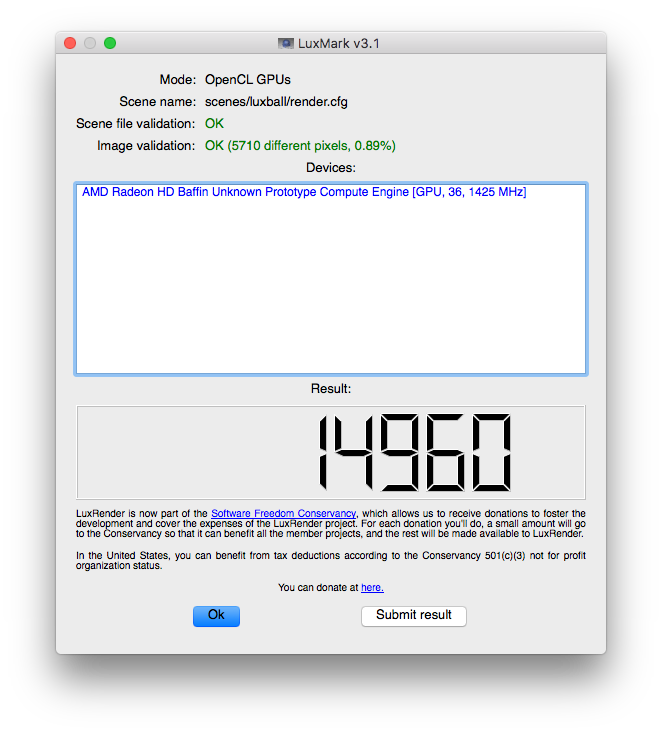

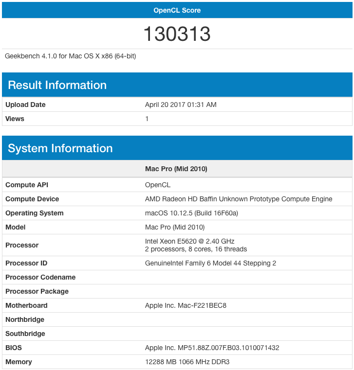

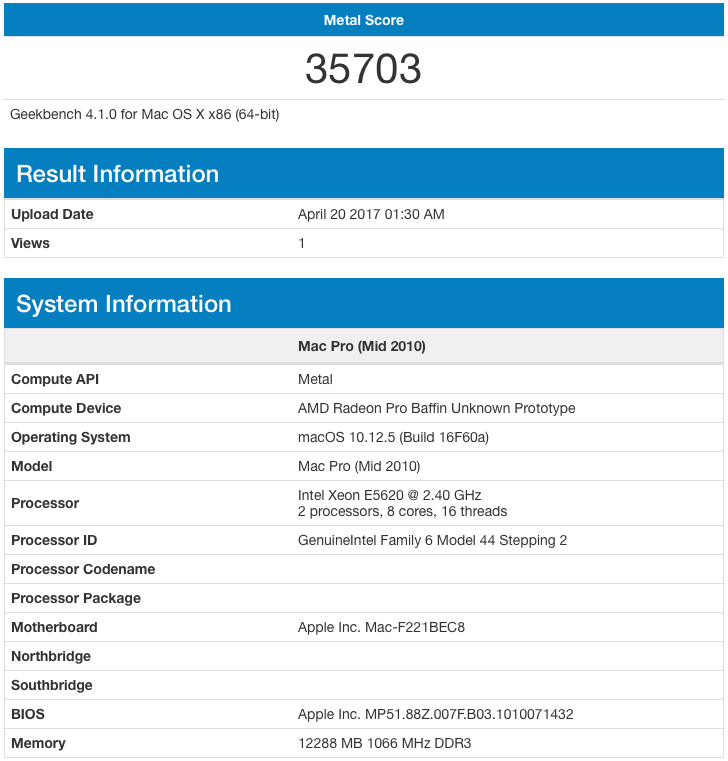

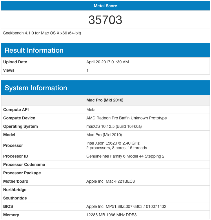

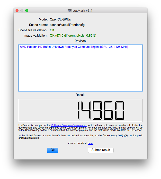

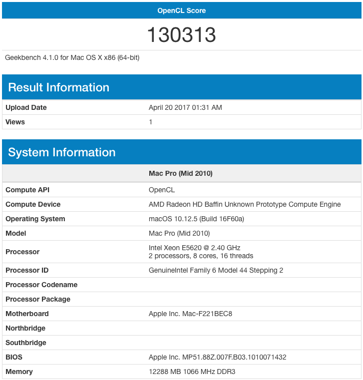

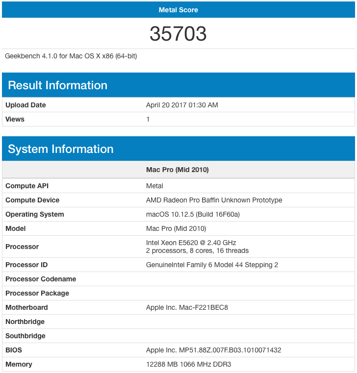

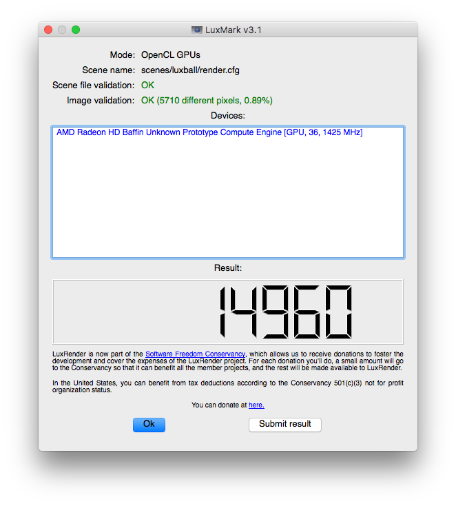

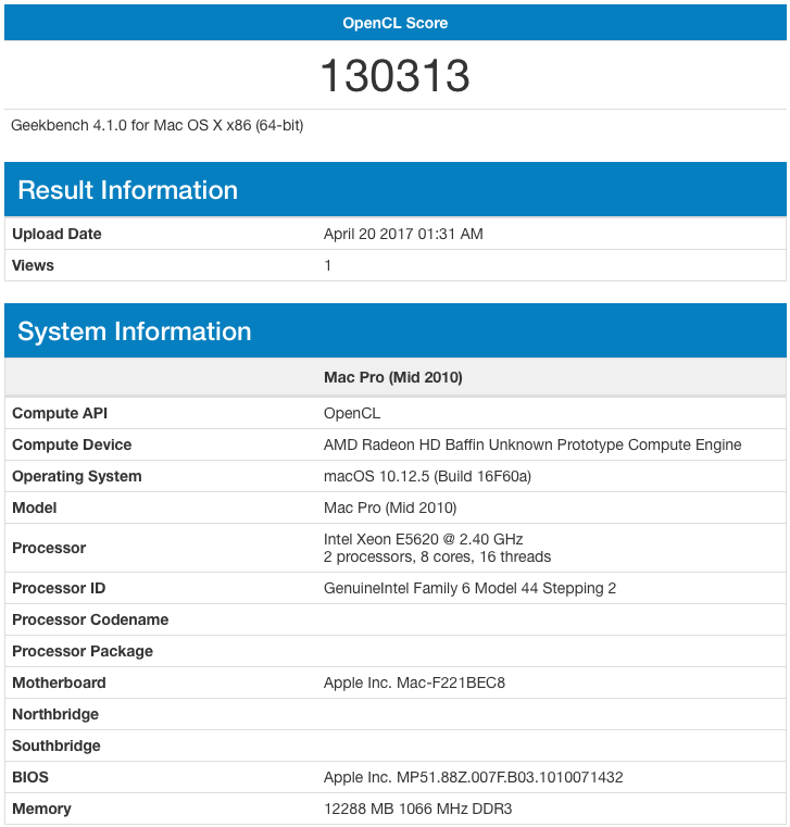

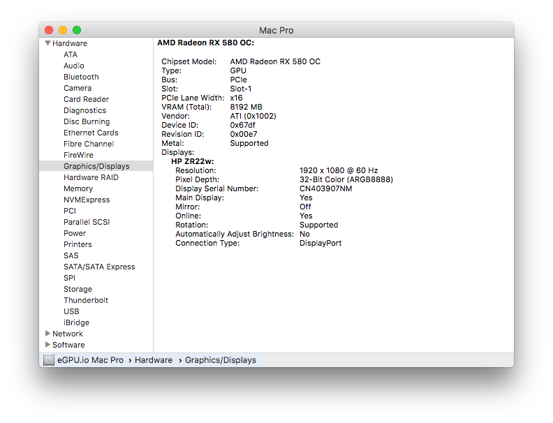

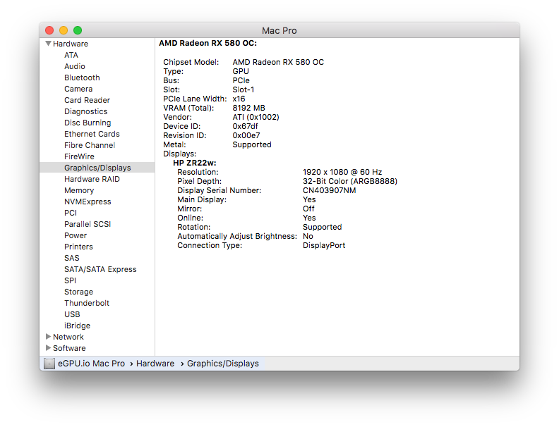

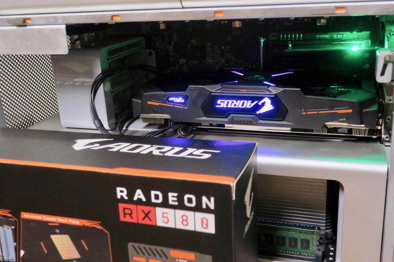

It has the same PCI ID 67DF as RX 480. I simply swapped the RX 480 out for the RX 580 and all was good to go. Due to the higher TDP, both PCIe booster cables go to one GPU rather one each for the reference cooler RX 480.
browser.geekbench.com-v4-compute-673232.png browser.geekbench.com-v4-compute-673225.png

I've been considering an AMD GPU for OpenCL, but looking at the your Metal benchmarks, it seems low. I have 2.66 8 core with a simple GTX 1050 and get 40871. I was expecting a much lower score considering this card is less than half the price. Did your 480 score the same or better?
Benchmarks are just a rough guideline and vary greatly on the system running it, not just the GPU.

I boys I've just installed a Sapphire RX580 Nitro 4Gb on my Mac Pro Mid 2010 (Osx 10.12.6) with just a 8pin to mini 6 pin cable and it's all ok, BUT in System Information I see "AMD R9xx 4096 Mb" and not 580 Rx.
Why? Can you help me please?

That's normal. It's just cosmetic.
Unless you willing to hex edit the VBIOS or the kext (which may brick your card, or destroy the OS), you better leave it as is.

They are either install the Sapphire PULSE RX580 8GB card in High Sierra. (Native correct identification due to this card is in the APPLE eGPU developer kit)
Or by Hex edit the kext file. (You can make it display whatever you want)
Or by flashing the card (Hex edit the VBIOS).

I can't see anything strange. Your card is 100% plug and play, no need to perform any kext mod, isn't it?
You better use both cables. I fact, you should consider
dual mini 6pin -> single 8pin -> dual 6+2 pin
to feed the card.

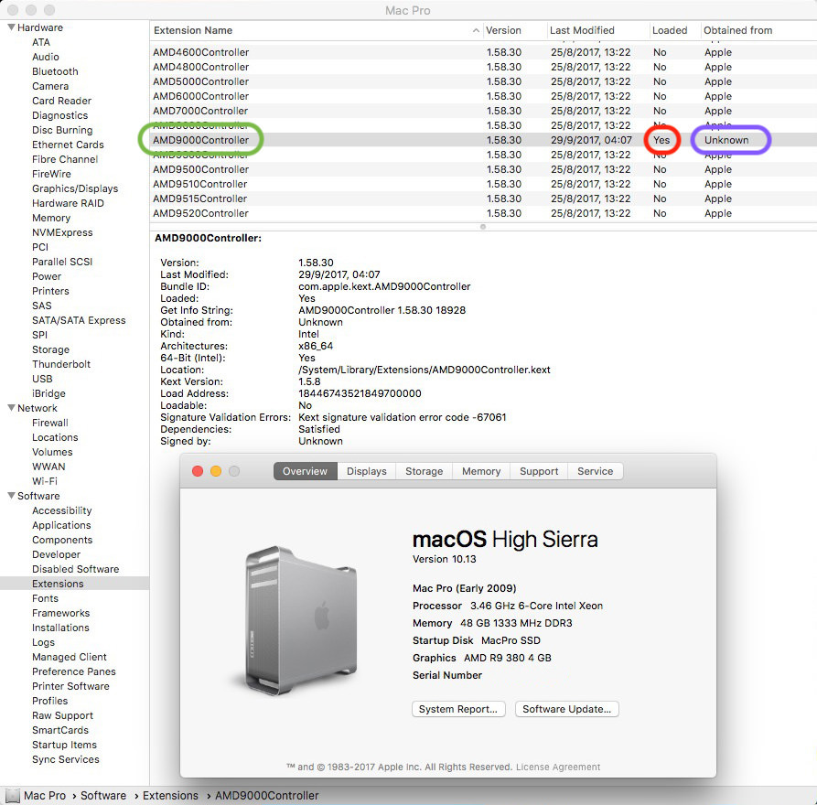

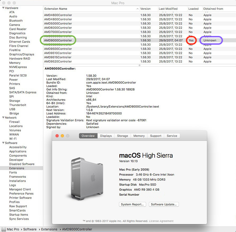

Check your system info, which ever the AMD kext loaded (red circle), that's the one you need to mod (name in green circle). N.B. My system is running a R9 380, NOT RX580, the kext required to mod is different.
However, be careful. Once you mod the kext, it's no longer signed (purple circle). AFAIK, it means the kext won't be loaded if SIP enabled (e.g. after PRAM reset).
Recovery partition will not be affected. You can always boot to recovery partition to fix it. But you better know what's the potential problem.
