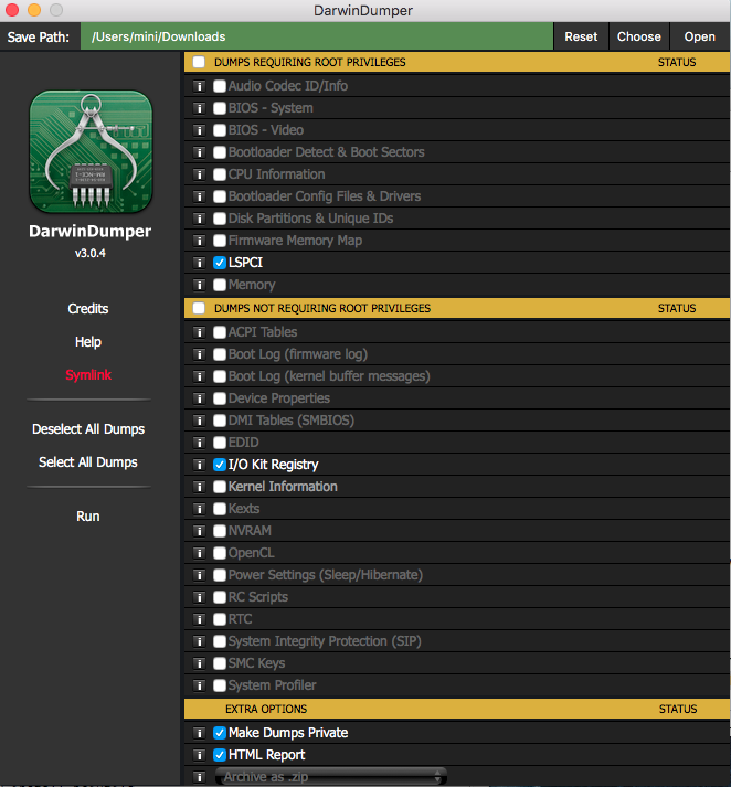

Select the following in the Darwin Dumper:
And then report the output of LSPCI nnvv:

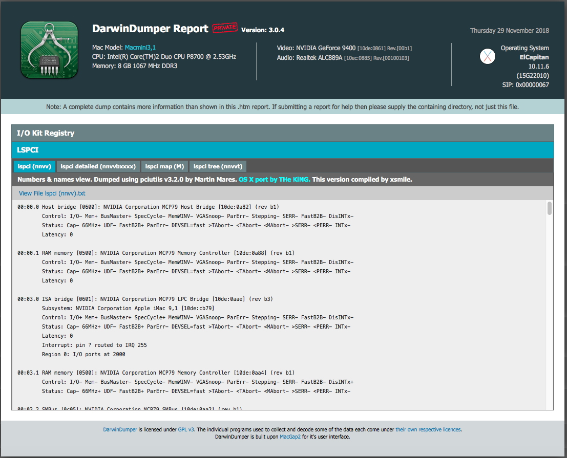

Is Darwin Dump (Ha-I don't understand what the information means!) something I want to keep after I get the info. you need to read? Can I Dump firmware with this? Will it keep a copy of my current firmware, when trying to update new firmware? I have 140.0.0.0 now, by the way- Thanks Again! I will try this tomorrow!!!

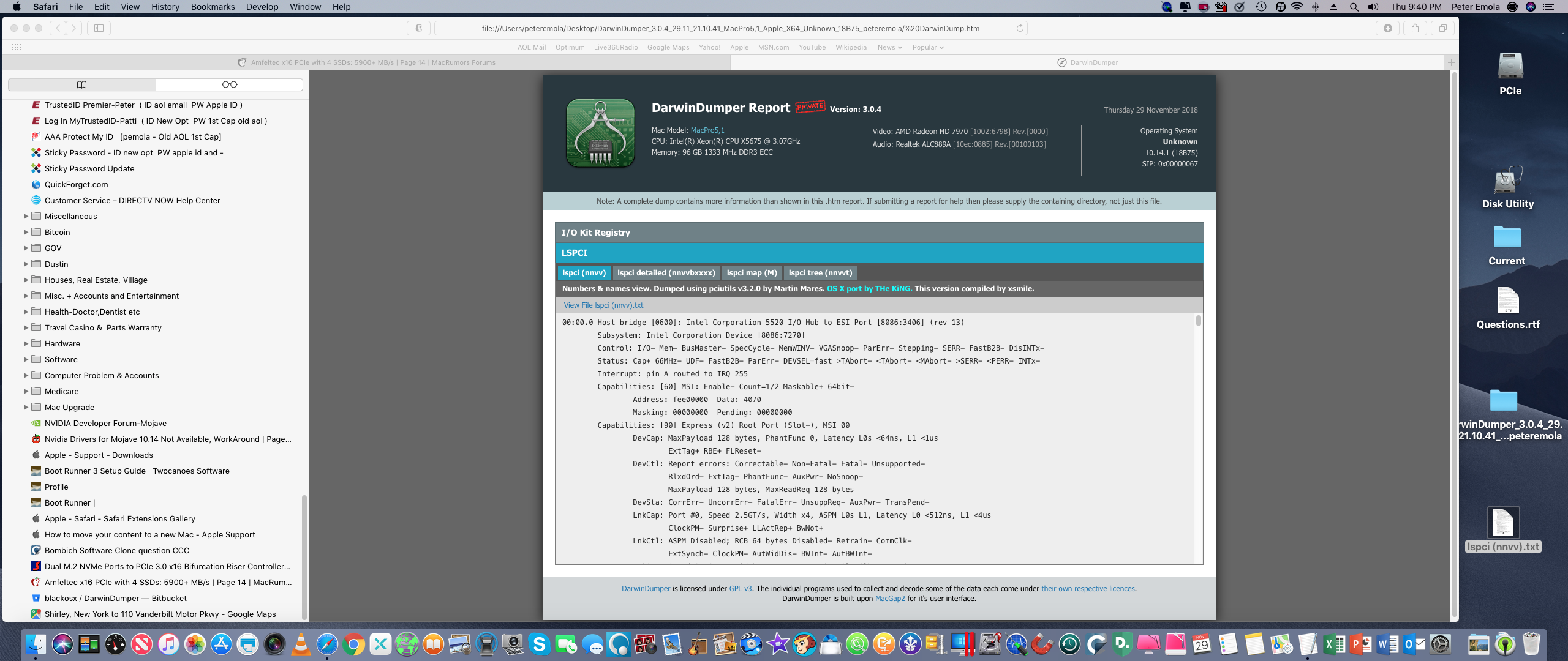

I was able to dump everything without the "CPU information" to the best of my knowledge (when selected that caused kernel Panic and reboot). Yes it will dump the system and video firmware as well if selected (you need to have SIP disabled for all dumps requiring root privileges)
Hope I got what you need! See files uploaded-
Thanks startergo !!

Here is the last response from Canada!
"If the board is recognized in x4 PCIe slot than it has to be recognized in x16 slot.
I think you have issue with your motherboard/BIOS because it is too old."
Thanks startergo !!

Can you run the DarwinDumper with the Bios-System option? This will dump your bootrom. If you are willing to follow instructions you can:
"The first thing to debug strange things is to make a BootROM dump and flash the generic MP51.fd from 10.14.1. This eliminate any hardwareID and NVRAM problems."
We can guide you
