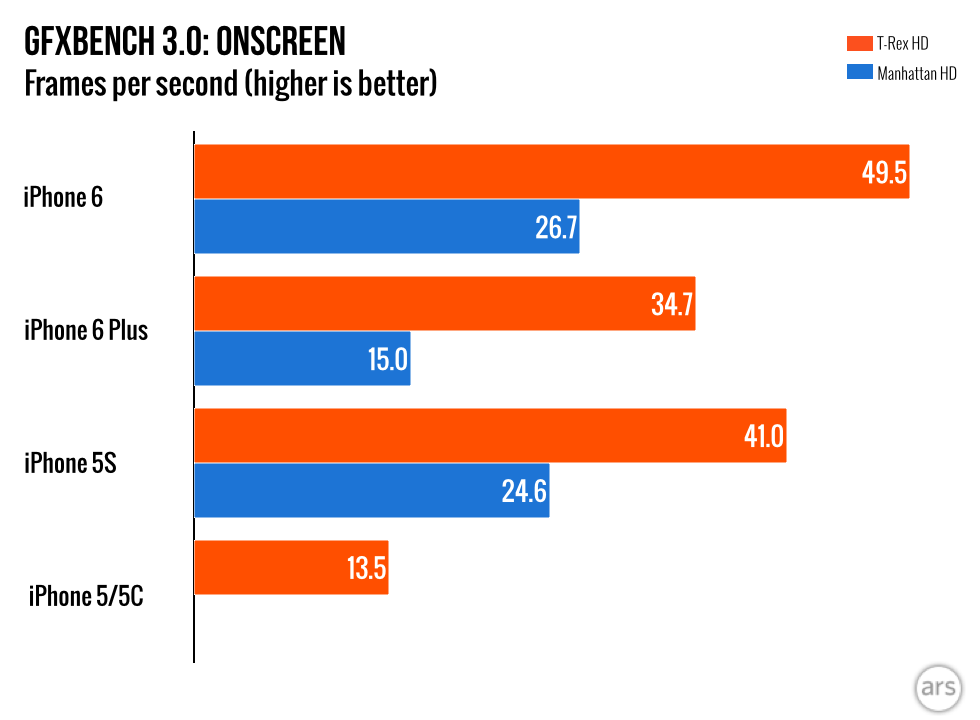

maybe in settings? even ars technica shows a dramatic difference in onscreen tests

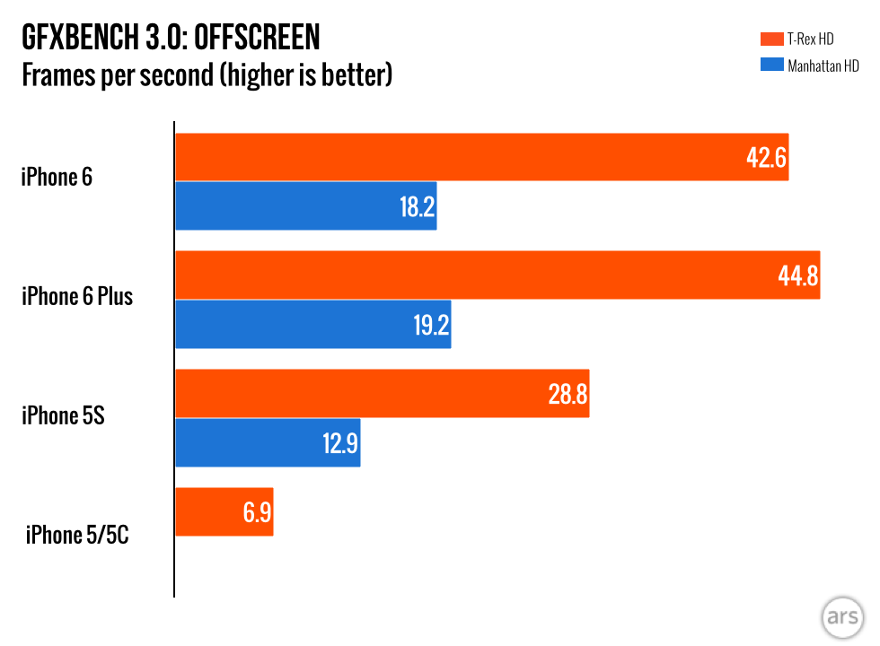

What about the offscreen 1080p test? The Plus still shows better results....
the offscreen 1080p test will show the 6 plus as having ~5-10% more performance since the A8 is clocked higher, but onscreen tests will show a different story given the resolution difference

I trust Anand. Besides, the results he showed make perfect sense, of course more pixels will render slower. Im assuming something is set up incorrectly for the OP, or Anand has a newer version of the App he is using that supports the native resolution.

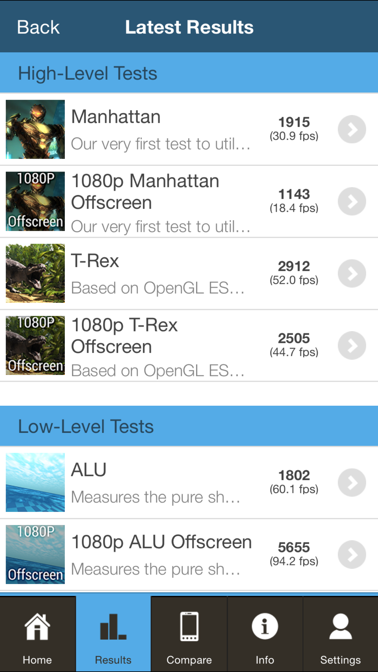

you can tell by looking at the screenshot that something is wrong, the screenshot claims that offscreen is 1080p, the 6 plus has a 1080p screen, the scores should be identical.
the fact that onscreen is higher means its running at a lower resolution by default

same issue, those onscreen and offscreen results should be identical if the onscreen test is ran at 1080p, but it seems to not be

I have both the 6 and 6 plus available to me and just ran GFXBench on both of them. The 6 plus scored roughly 5% higher than the 6 on both on and off screen tests - which tells me that there is some kind of resolution-configuration problem for the on screen test in the consumer version of GFXBench.
There is no other logical explanation since the 6 plus should be pushing a much higher resolution and thus have lower scores.
(Unless you think that the 6 plus is actually way faster than the 6 and the offscreen scores are the ones that are wrong.. 0% chance of that)

Side note, though, it seems like GFXBench isn't running GPU tests at proper resolutions for the devices. Comparing off-screen benchmarks makes more sense anyway though so it's not too much of an issue. Also, I'd be pretty shocked if 6+ results *weren't* a bit higher than 6 results. They should be - there's more thermal headroom and many more pixels to push.
