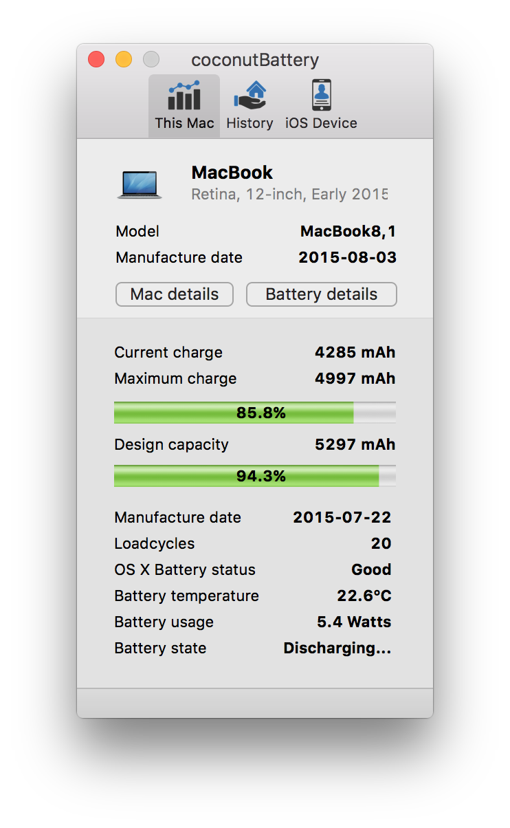

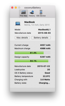

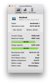

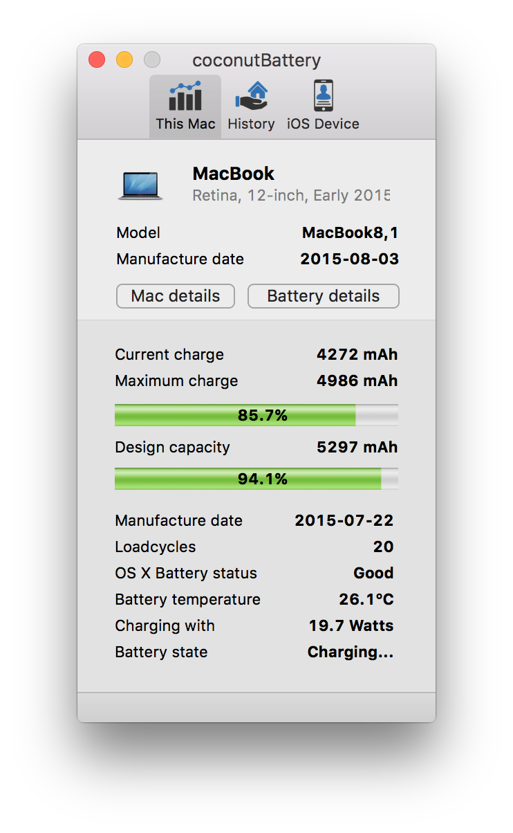

Here are the screen shots. On battery, while using the backup battery pack, and while using the charger. Screen Shot 2015-12-17 at 10.59.01 AM.pngScreen Shot 2015-12-17 at 9.29.51 AM.pngScreen Shot 2015-12-17 at 9.36.43 AM.png
Ah thanks, but I should have been clearer - could you click the "battery details" button before making screenshots? It will show the power adapter rating.
