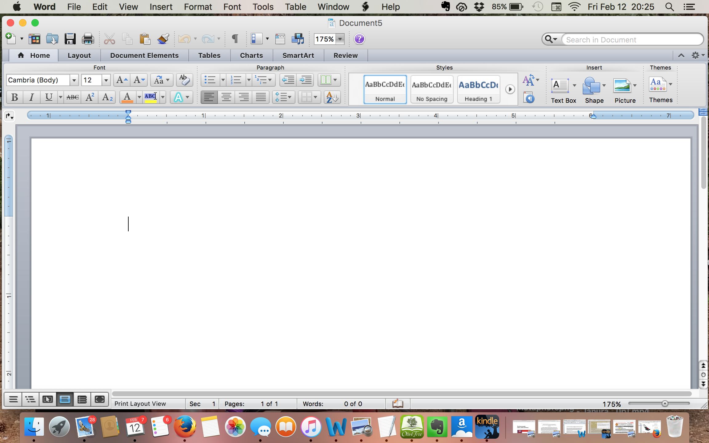

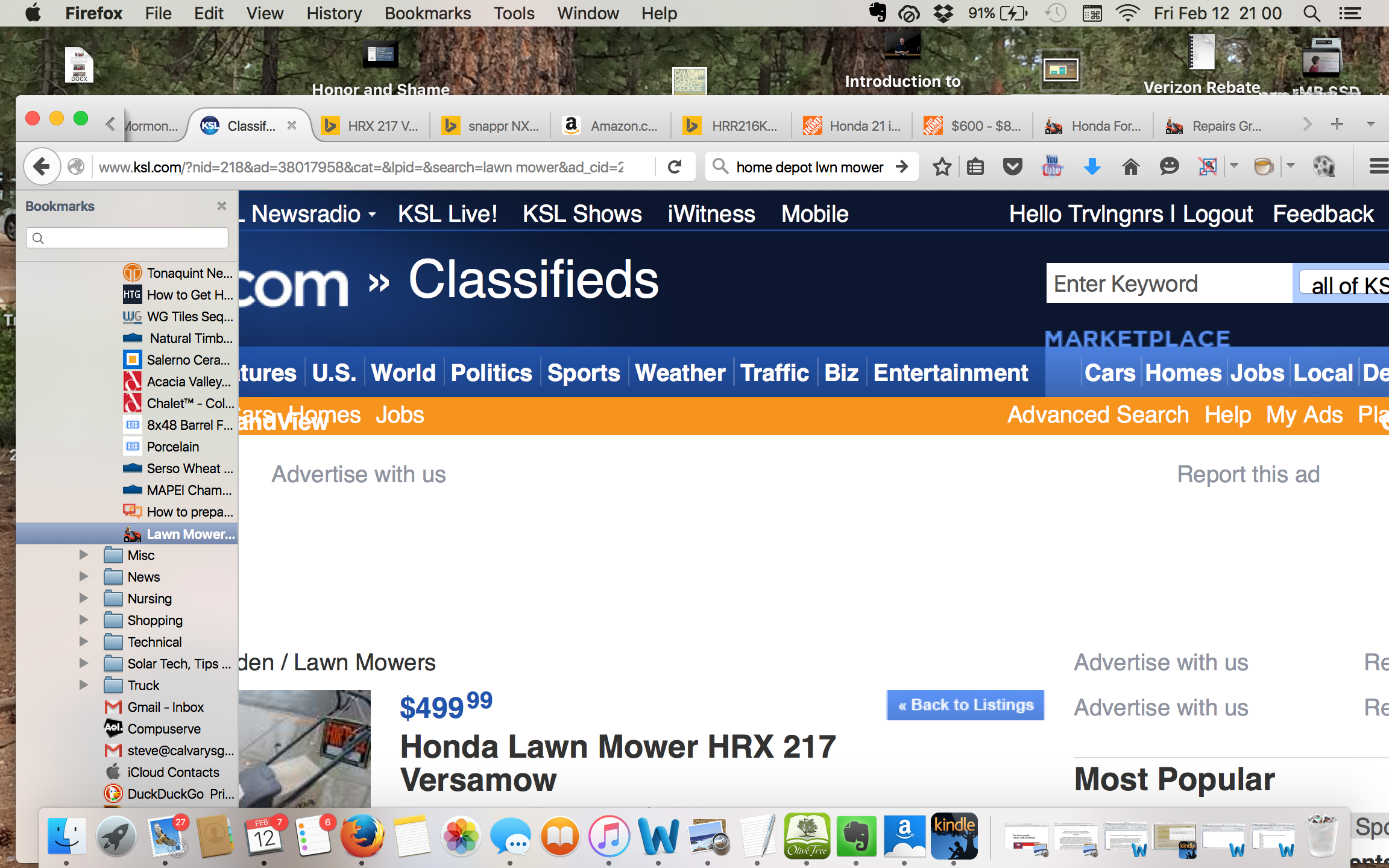

Here are some screen shots - beginning at 85% charge, plugged the battery in and 25 min later was 91% charge. This with brightness about 40%, searching the web with Firefox with 10-13 tabs open. Also open but not actively working on: 3 Word docs, Kindle & 2 pdf's.
Not sure what else you can expect!
