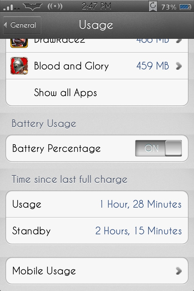

Thanks for the advice guys. My mail is switched off firstly. So I am sure its not Mail. I also discovered icloud was activated just for calenders though I have never used it. Disabled that too. Just finished recharging for the first cycle. Will do it one more time tonight and see how it goes. Thanks again!
Just to add on, seems like the recalibration was the trick.
Usage : 27 Mins
Standby 1 Hour, 54 Mins.
Battery just fell to 99%.
Will do another recalibration tonight just to be on the safe side.
EDIT : Seems I spoke too soon, fell to 98% within 2 minutes.

1) I live on an island. Singapore to be precise. Reception is pretty good really.
2) All system services are off for location services and only a few apps are switched on for it.
3) I posted my current standby and usage time on the previous pic. Note that is is right after recalibration.
4) When I had the drain, wifi was off. Just 3G. The pic I posted on the previous post, it was today at home. Wifi was on.
5) Winterboard. Zephyr. Zeppelin. Gridlock. Activator. AdBlocker. Barrel. ClockHide. ColorKeyboard. CustomNCBackground. Cydelete. Direct Closer Pro. f.lux. Fake Operator. Folder Icons. FolderEnchancer. GridTab for Safari. Iconoslam. Icon Renamer. KillBackground. Lorem. ManualCorrect. PasswordPilot. StayOpened. UpdateHider.
